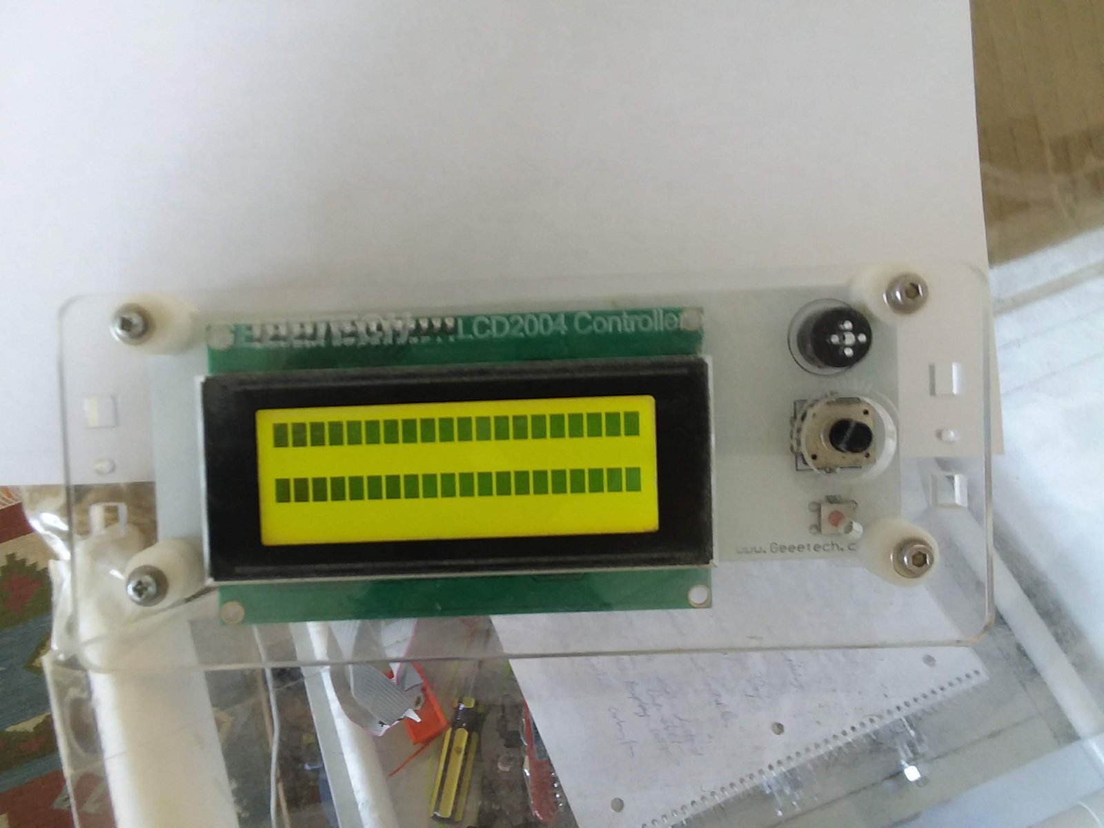

Hi again William,
One more question: The display on my Prusa is a Geeetech LCD2004. After installing either of the "Marlin-PI3_Pro_B" and "Prusa I3A 2560" firmwares, the 1st and 3rd lines of the 4 line display are dark (see photo). I see these firmwares have #define REPRAP_DISCOUNT_SMART_CONTROLLER in the configuration.h file. Is this correct for my Prusa Mendel I3?
