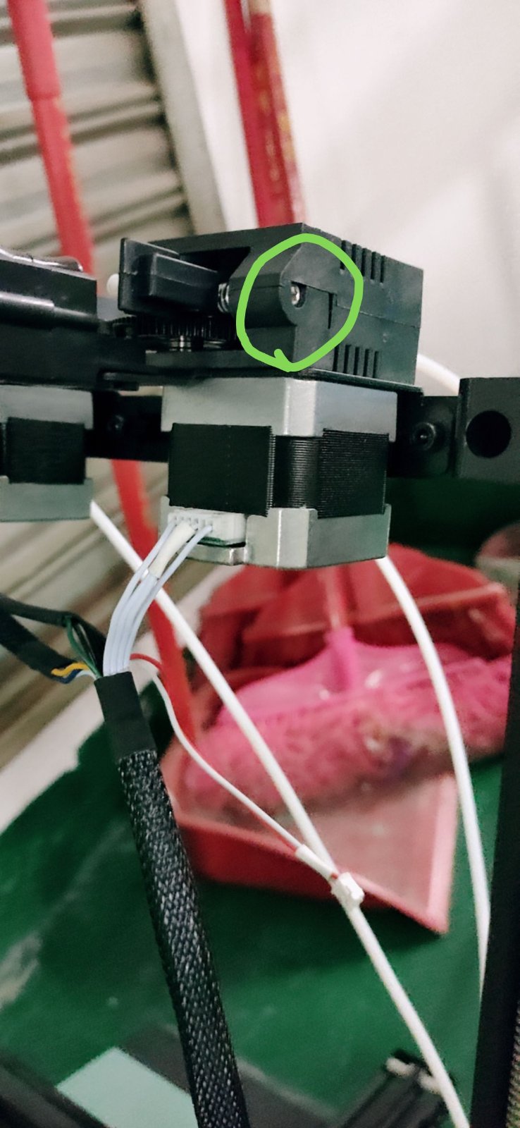

Hi,If the Teflon tube is not inserted in place, it will be easily blocked.
You can also adjust the knob as shown in the appropriate position.

Re: I want to change 3in - 1out extruder to a normal one
Hi, if it is too tight, the extruder will not feed well.
You can pull the consumables out when printing. if it can be pulled out, it is too tight.
and It should be confirmed that the Teflon tube on the extrusion head is inserted to the innermost.
