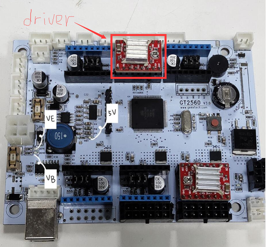

Re: Extruder motor don't work
Hello, swap this part on the motherboard:
if the extruder can work normally after swapping, you need to replace the driver
Post by Alessio66 »
Thank you William
I made the test swapping the driver, but the extruder doesn't works.
What about change FW?
Alessio
