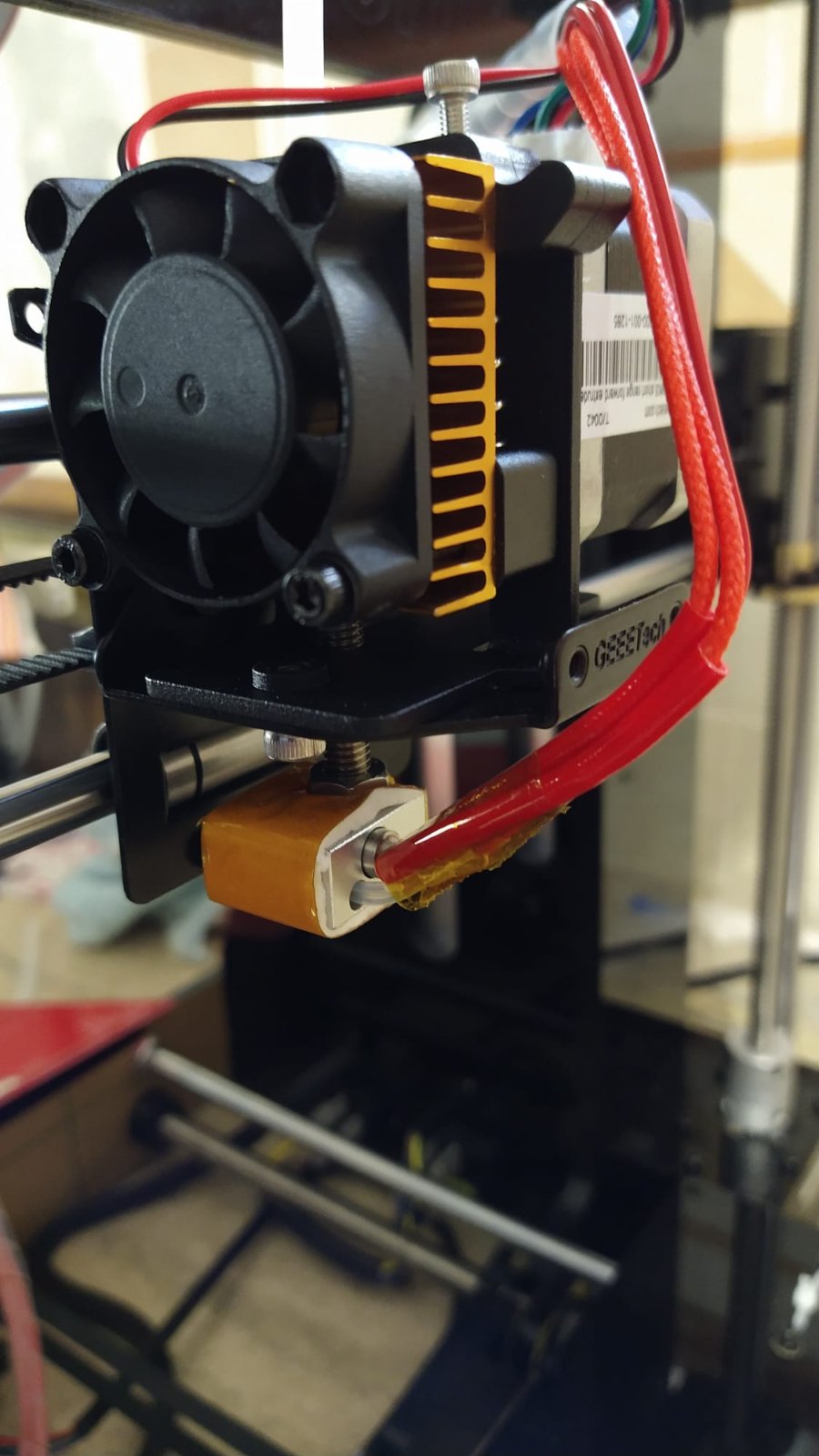

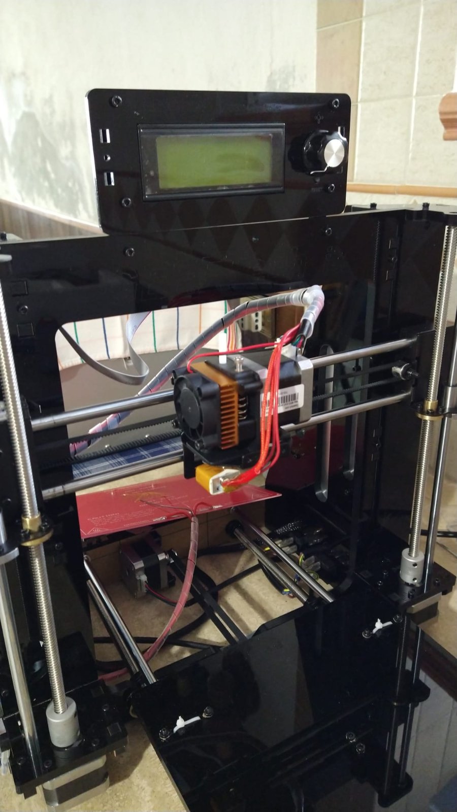

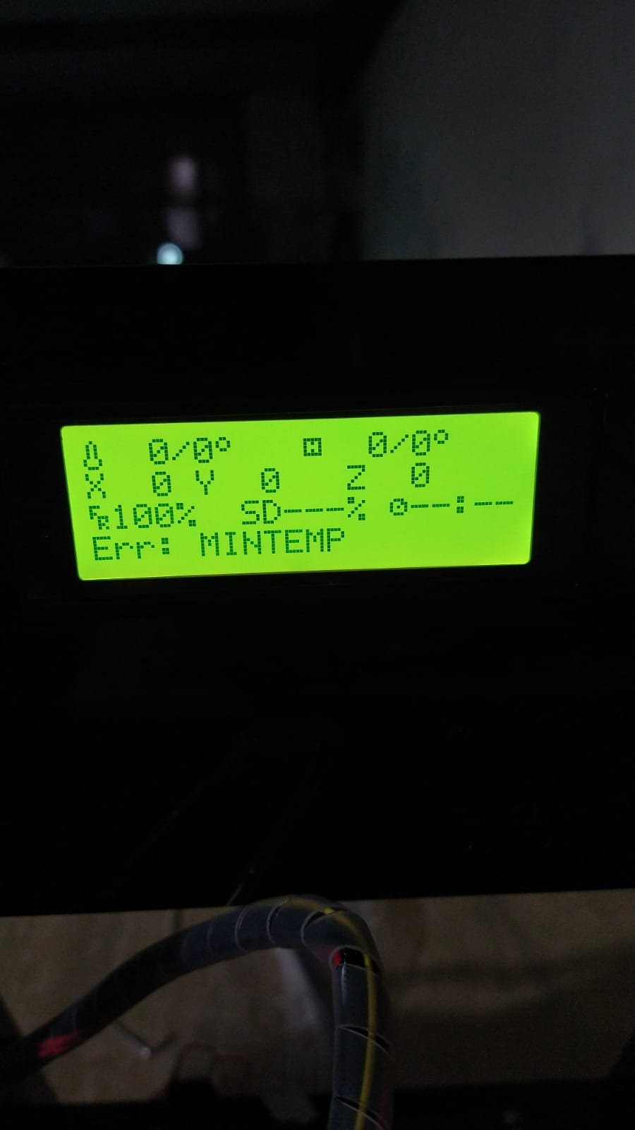

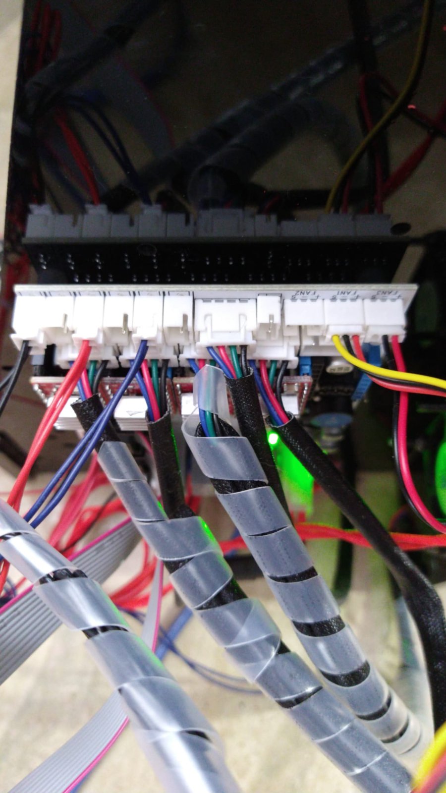

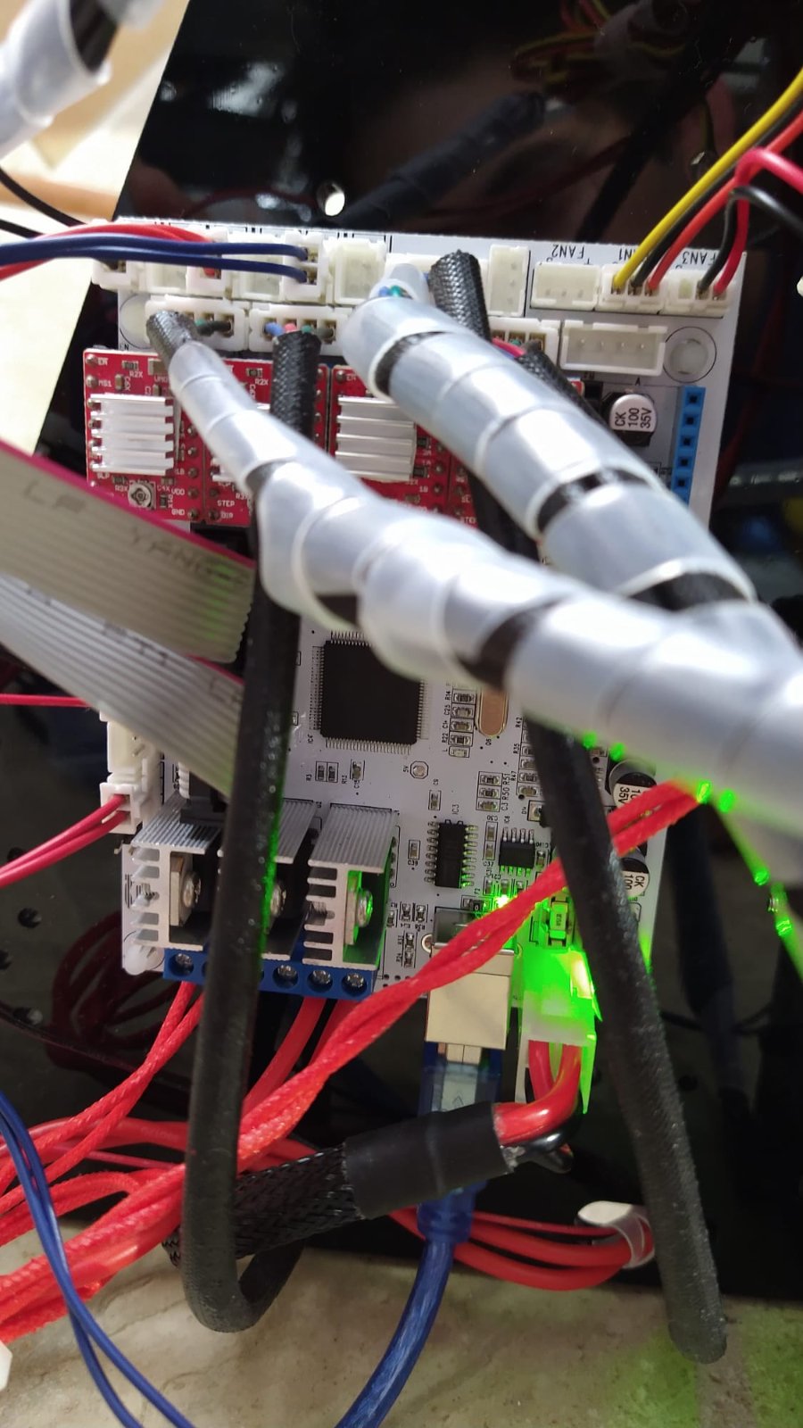

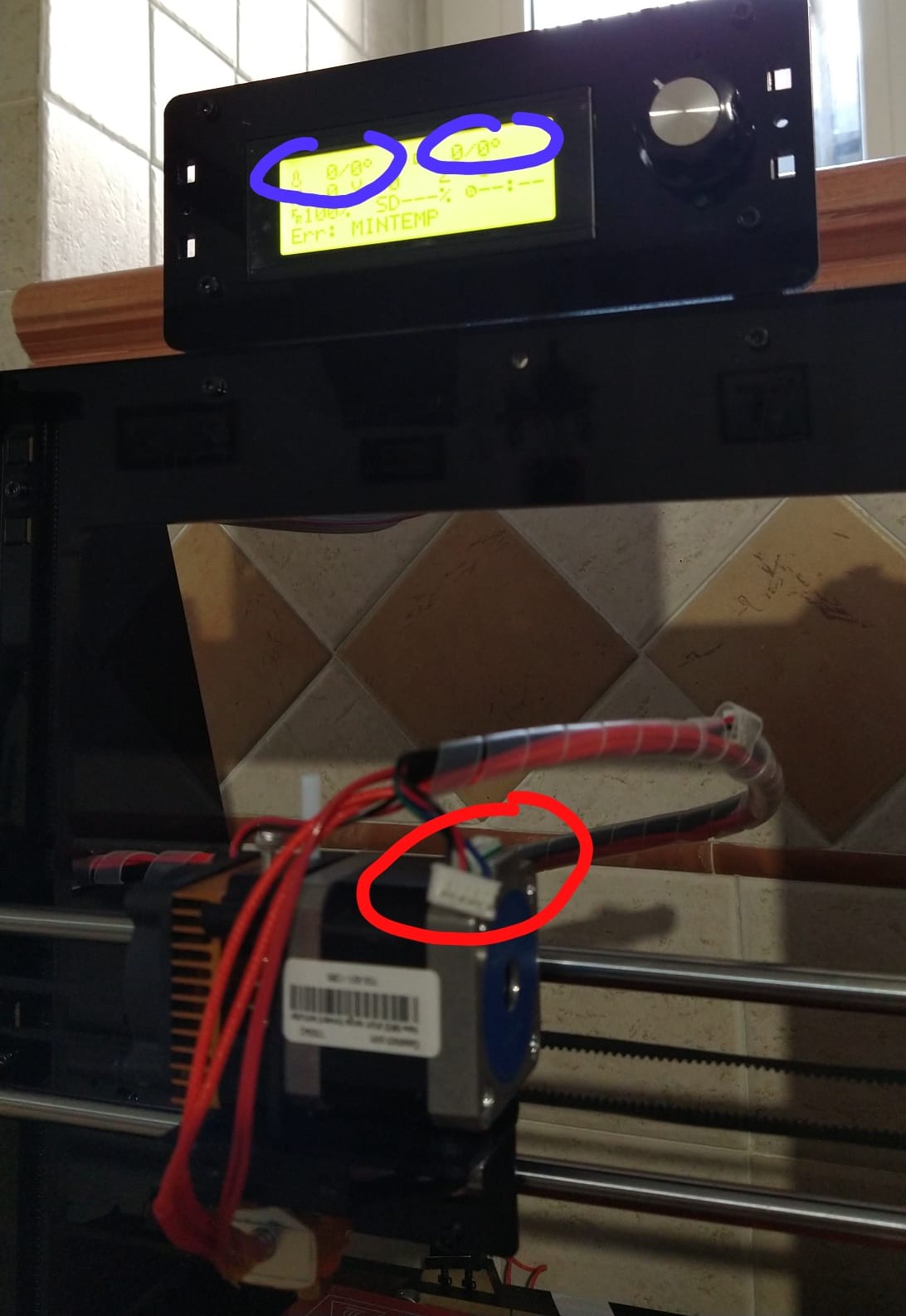

I'm Raffaele and I bought a Geeetech Prusa I3 pro B 3D printer a week ago but at the first start it gives me this error: MINTEMP, extruder and hot bed both 0/0° (see the photos). I check the connections and the cables they seems OK (but i didn't strip them). Is it possible that GT2625 is defective?
i tried to move axis and they are OK except the extruder motor, it doesn't work and remains motionless when I turn the knob. what I have to do ?

- mother board.jpeg (205.98 KiB) Viewed 5521 times
- mintemp.jpeg (56.07 KiB) Viewed 5521 times
- connection.jpeg (149.59 KiB) Viewed 5521 times

Hi,you can check whether the screen cable is connected properly and burn the firmware again.
If it still shows like this, maybe there is a problem with the thermistor of the extruder and the hot bed.

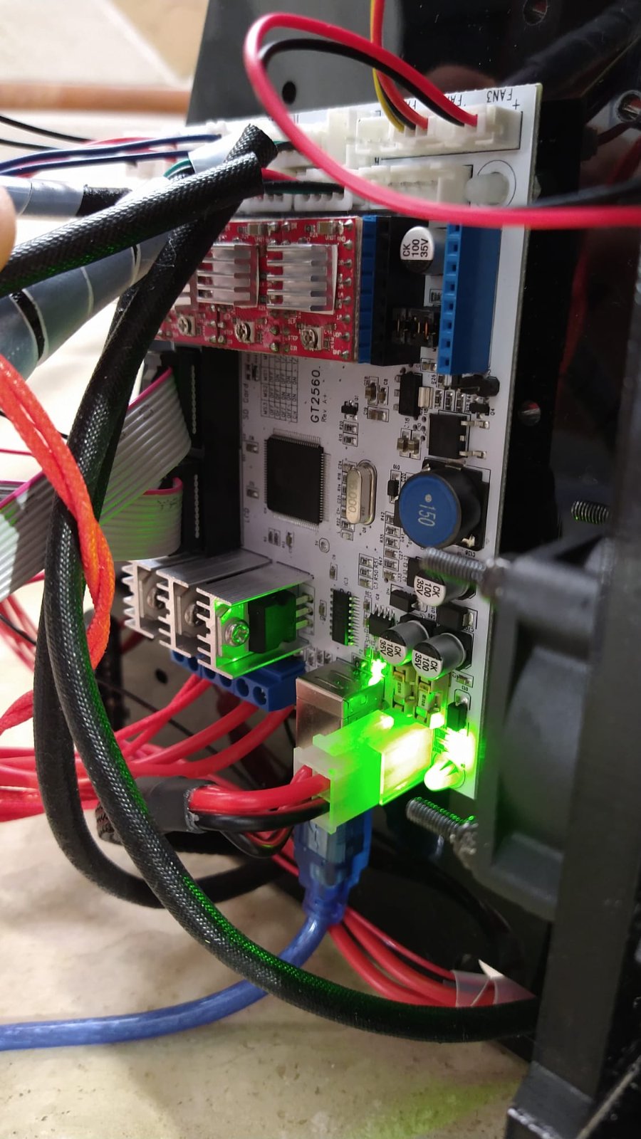

Can you provide the pictures after the main board is powered on?

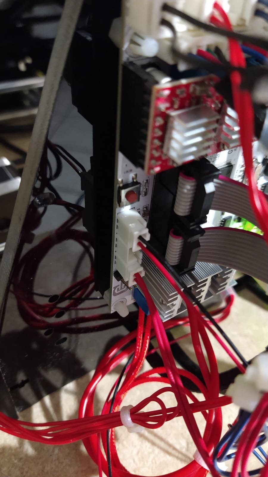

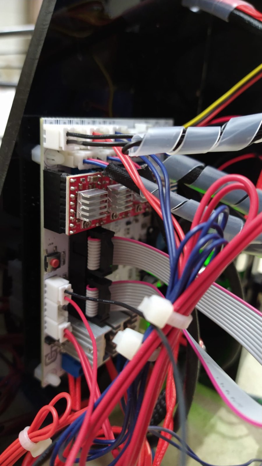

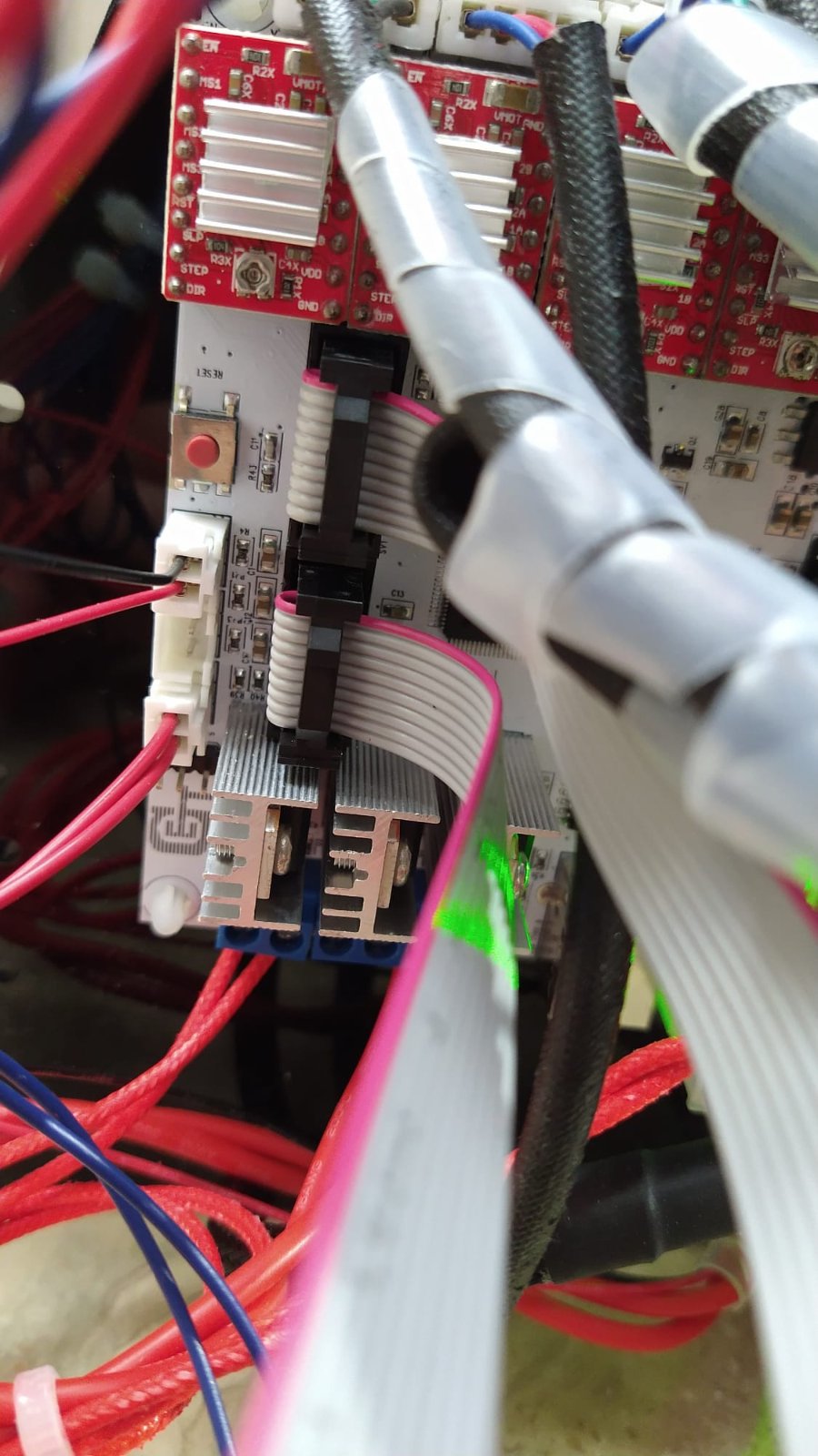

I checked the screen cables and thay are OK. These are the photos of the turned on card.
I don't know if the problem is the thermistors, I read here , (viewtopic.php?f=13&t=17030) that if I short the thermistor sockets I should have the MAXTEMP error, instead the MINTEMP error always appears to me.
Do you confirm that if I short the thermistor sockets I should have the MAXTEMP error?
If this is true the problem is the motherboard?

- scheda1.jpeg (213.92 KiB) Viewed 5479 times
- scheda 4.jpeg (194.29 KiB) Viewed 5479 times
- scheda 3.jpeg (166.86 KiB) Viewed 5479 times
- scheda 5.jpeg (196.49 KiB) Viewed 5479 times
- scheda2.jpeg (182.34 KiB) Viewed 5479 times

Hi,you can unplug the motor cable on the extruder to check whether the main board is in good condition.
If the temperature display is - 14 ℃ after unplugging the motor wire, it proves that the main board is good,
That's a thermistor failure.

I have unplugged the motor cable on the extruder , like in the photo, but the LCD always shows the same temperatures (0/0° and 0/0°).
I need to change the card?
- WhatsApp Image 2020-05-13 at 09.55.54.jpeg (215.61 KiB) Viewed 5441 times

Hi,unplug the extruder cable to display 0 ℃, maybe there is a short circuit somewhere on the main board.
you should contact the salesperson on the purchase platform to change.
