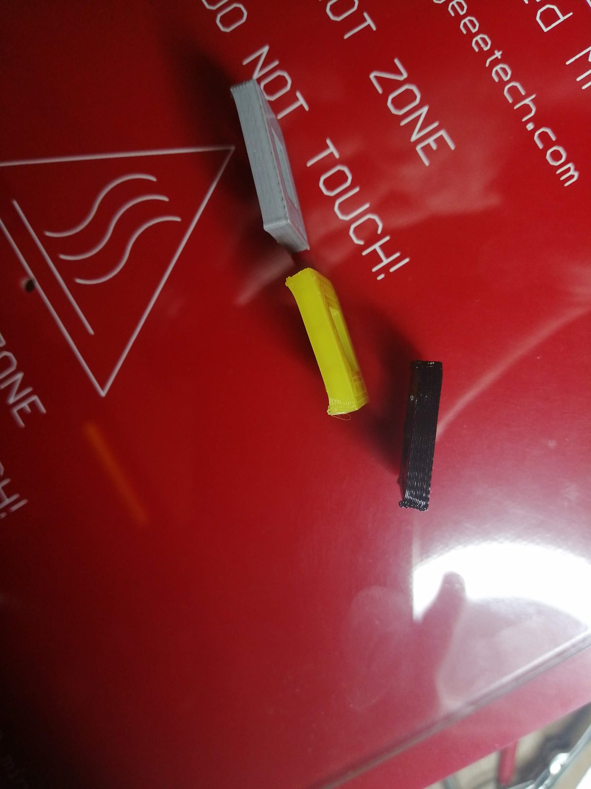

The problem I have is that every time, I try to print some sharp edges (like 90 degrees or a straight line) or a tall object - the part starts to get exactly the shape of a canoe boat (straight in the middle, but the edges are up). The reason I'm saying that it's not the famous warping problem or adhesion to the heatbed is because the bottom layer prints ideally and sticks very well to the bed.

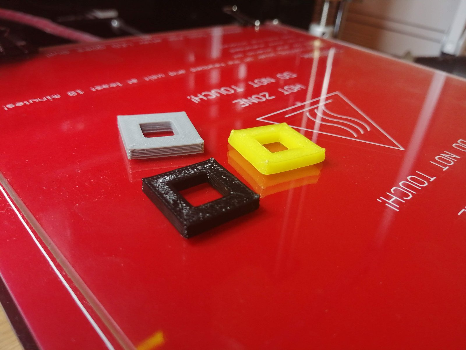

Please, see the attached photos where I try to print just a 2x2cm rectangle with a 1x1cm whole inside:
The grey PLA plastic was the 3m sample supplied with the kit - that one printed more or less fine, without even any calibration
The yellow PLA plastic is 1kg roll from Geeetech - you see that the walls are not vertical anymore, shrinking towards the top layer and most important - notice the "teeth" at the top edges on each corner
The black PLA plastic is some noname which I bought for my 3d pen - it behaves the same as yellow
You see that that bottom layer has no warping. The warping starts towards the top layer

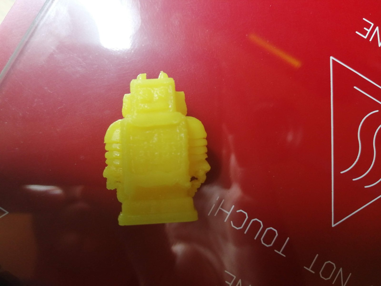

The other photo shows the sample Ultimaker bot. Its feet printed ideally, because they don't have sharp edges (they are rounded and printed as solid line, without the extruder changing direction sharply). However, towards the top all layers get the form of a dish (see the arms for example).

Printed parts have "boat" shape towards edges (not warping)
- IMG_20200512_193324.jpg (177.47 KiB) Viewed 3959 times
- IMG_20200512_193244.jpg (223.98 KiB) Viewed 3959 times
- IMG_20200512_193204.jpg (182.68 KiB) Viewed 3959 times

Hi,it looks like it's caused by overheating.
You can increase the fan power, or reduce the temperature appropriately.
