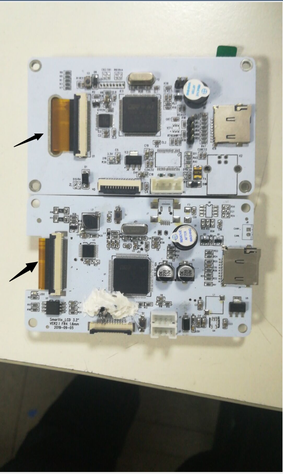

Re: Firmware Upgrade - Nothing shows up
Hi,what is your screen?

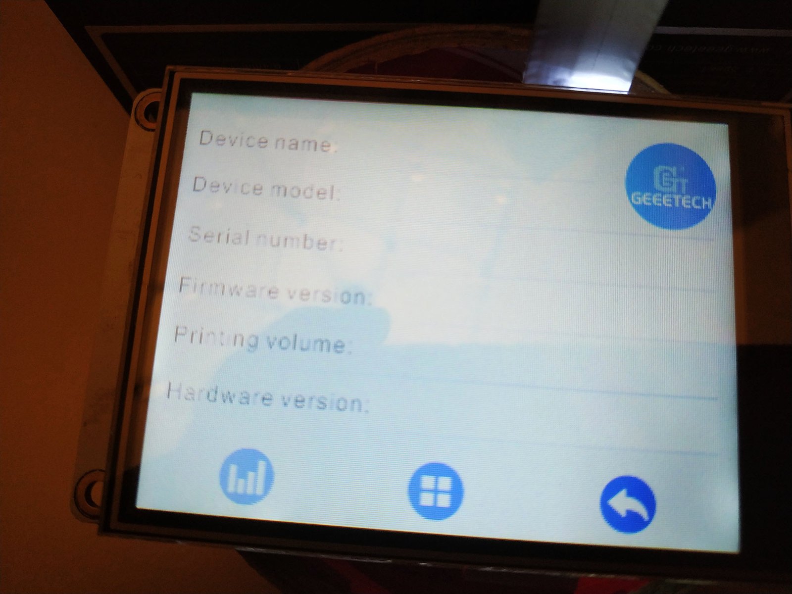

I seem to face the same issue. A friend passed me his A30 to see how I can help. When i went into the info screen there is no info at all. Not a good start. it is unable to communicate with any part of the printer. No temperature reading, cannot move the XYZ steppers. Can navigate the different screen, but otherwise a zombie. The Motherboard is a GTM32 Mini S.
info screen 01.jpg (208.02 KiB) Viewed 6851 times

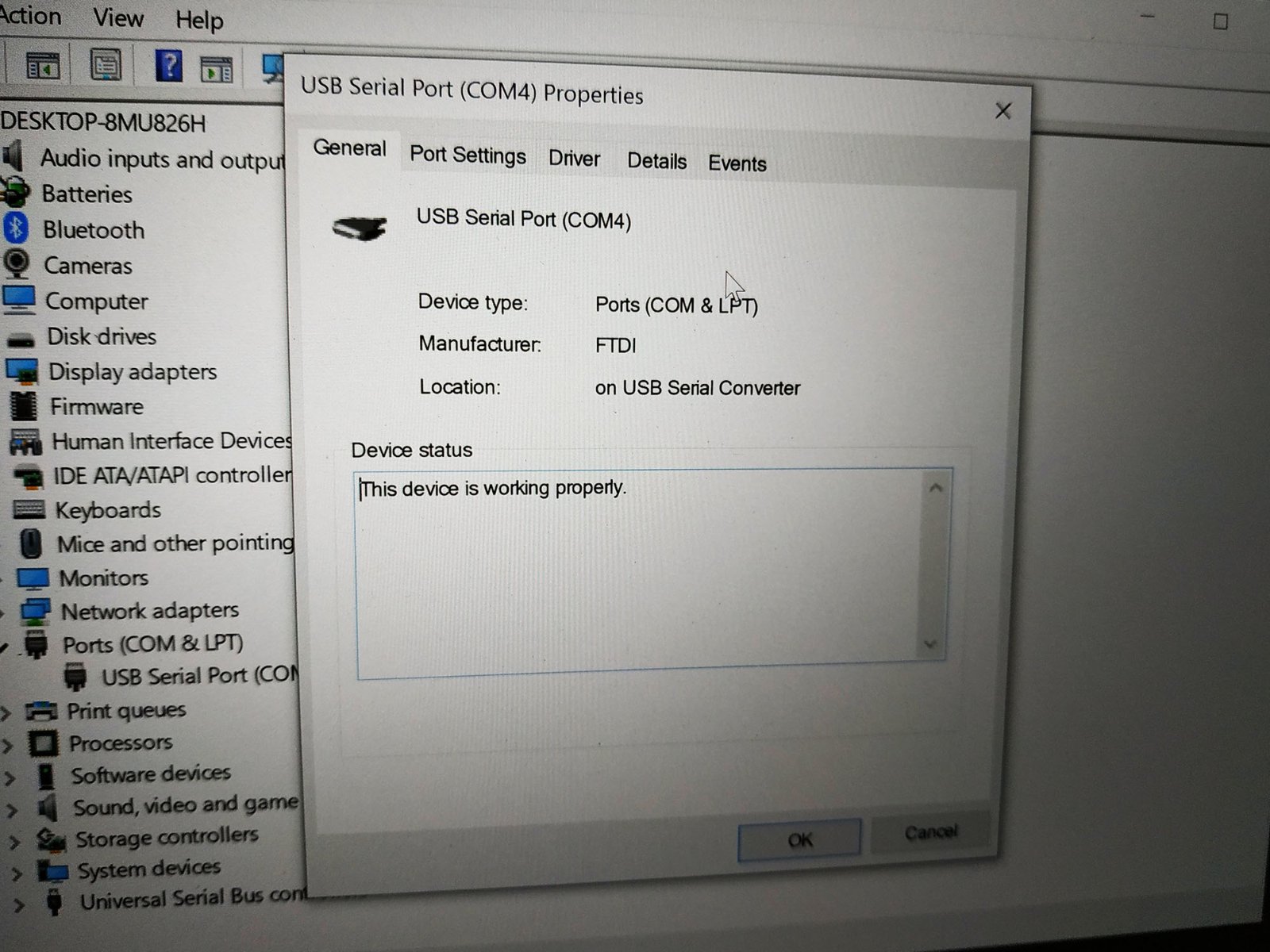

So I try to install the firmware A30-M07_v1_59.bin with the Firmware Upgrader Tool via USB. I got this error message. I checked the motherboard USB driver which is FT232 and ensure that the correct driver is installed on the PC. It uses COM4. I tried to upgrade it again. still same error message.

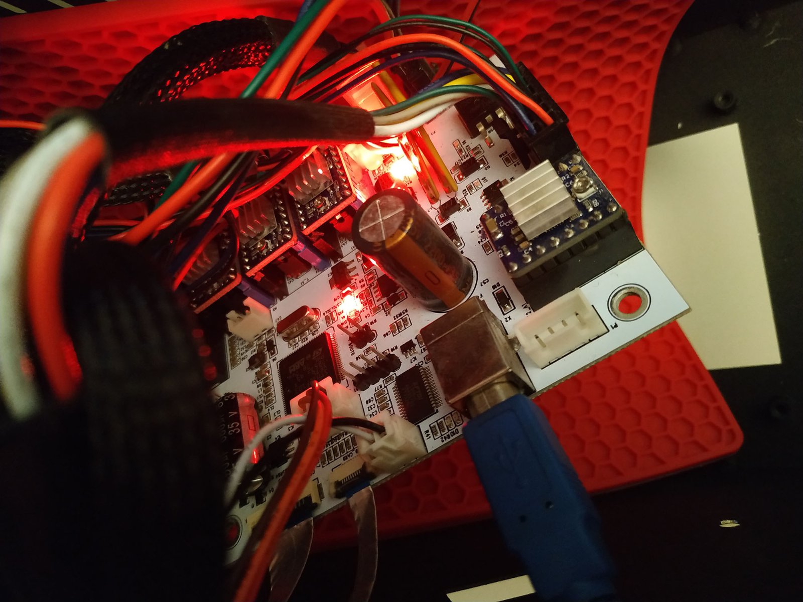

Below is how I connected the usb to the motherboard directly. A green led light does flash with I try to upload the firmware, after the error msg, it goes off.
my LCD screen is the one on the top.
