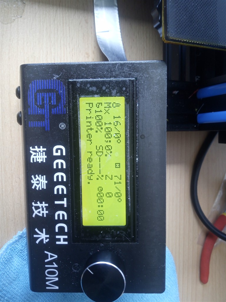

Yes. If i unplugged the termistor the temperature is -14.But the problem is not the extruder temperature. The problem is the BED temperature. On display is always 70 or 71. If i unplugged the cable ob motherboard notjng changes. See the picture in attachment. Thank you

Hi,if it is a hotbed problem, you can unplug the connection between the hotbed and the motherboard to see if the hotbed shows -14 ℃, if it shows, the motherboard is good.
Then it may be caused by the opening of the thermal bed thermistor. You can measure whether the resistance of the thermistor is about 80-120 kilohms, or the line of the thermal bed is broken.

If i unplugged the termistor the temperature on display is always 70.

Hi,the motherboard is broken, you need to replace it.
