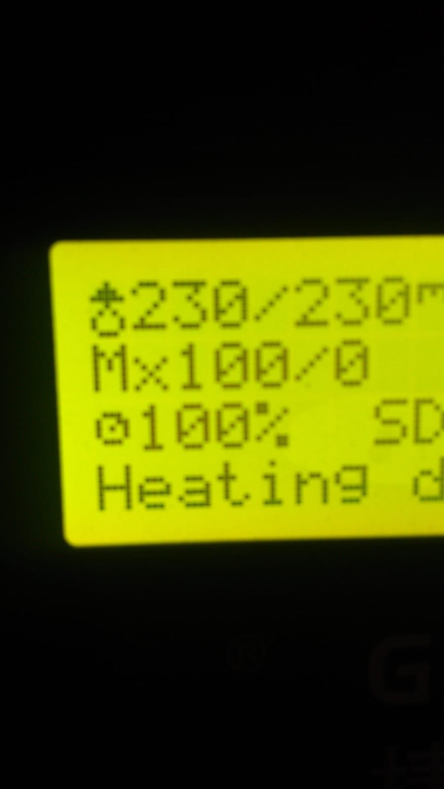

There a circle with a dash showing on my Geeetech A10M where you would normally see the feed rate, setting this 10% makes the printer run slow but 100% it seems to run faster.
Seems that when on the info display turning the knob alters this value without warning.
I have attached a picture so you can see what I am talking about.
Can anyone tell me what the symbol next to the 100% is for and what should this be set too.?

Hi,this symbol has no special meaning,
the percentage is based on the speed set on the slicing software.
For example, if you set a speed of 60mm/s, 100% speed is 60mm/s and 50% is 30mm/s.
