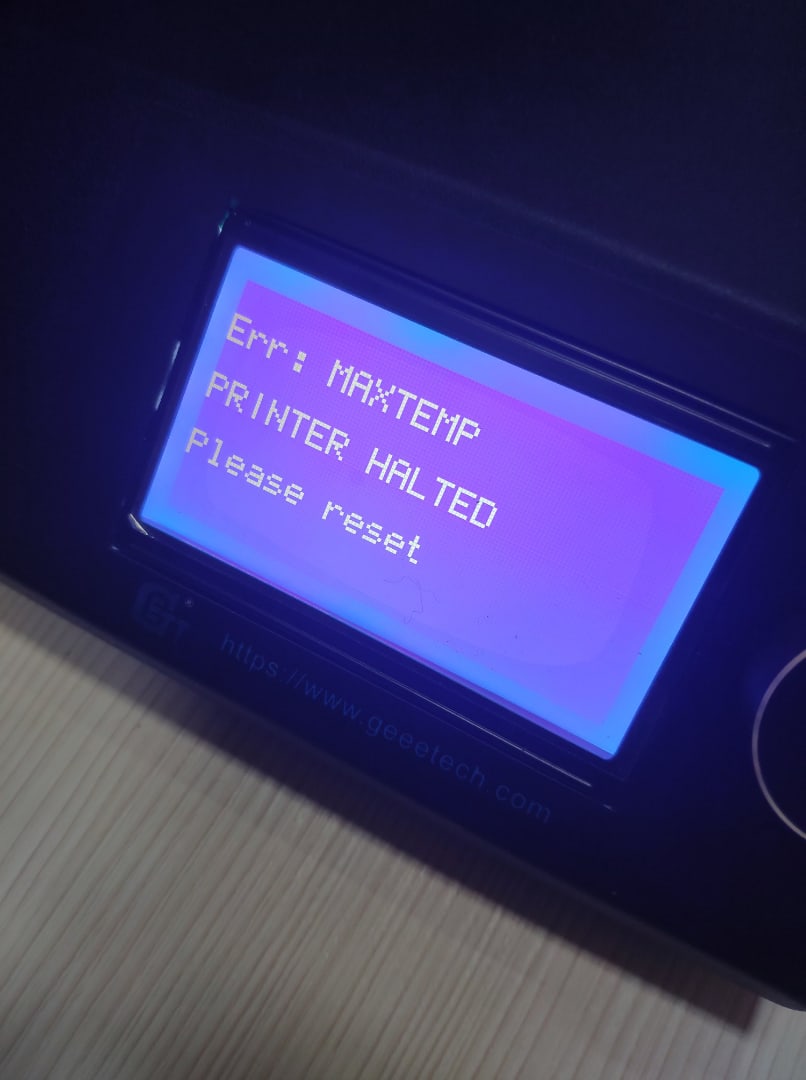

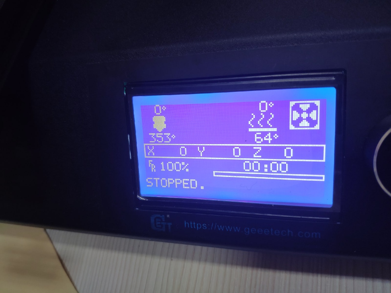

Hello I am from Russia. I am writing through a Google translator.
After updating the firmware my printer is Geeetech A20M
temperature sensors (thermistors) stopped working.
Error:
Err: MAXTEMP PRINTER HALTED
Sensors show temperature
Hotend: 353
Bed: 64
I tried: to flash the firmware through the Geyetech proprietary utility and the hex file. It could not, the temperature error remained.
I tried: to measure the termitors resistance of 119 kOhm
I tried: Disconnected thermistors completely from the board
PS I took the firmware from here:
https://github.com/Geeetech3D/Prusa_I3_3Dprinter
Error:
Hotend: 353
Bed: 64

Hello, how many degrees is displayed when not heating?
- Posts: 5
- Joined: Wed Jun 03, 2020 3:00 pm
Re: Geeetech A20M temperature error
When you turn on the printer immediately displays this temperature, hotend 353, bed 64. If you disconnect the thermistors from the board, the temperature does not change, it remains 353, 64. + - a couple of degrees. Motherboard geeetech gt2560 v4.0
Do you mean to unplug the thermistor of the hot bed and still show the hot bed at 64℃? If so, the motherboard is broken.

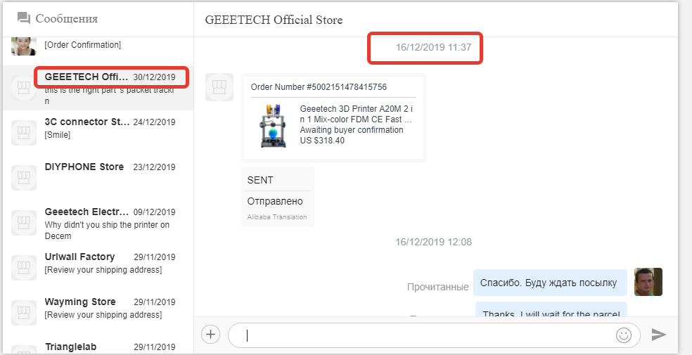

do i still have a guarantee? This store is geetech. please can you tell?William wrote: Wed Jun 03, 2020 4:56 pm If you just update the firmware, the motherboard will not be damaged, it may be caused by other reasons.
and you can contact the salesperson on the purchase platform to replace it.
do they need to write to replace the board?
- 2020-06-03_11-59-40.png (49.96 KiB) Viewed 10935 times
You can communicate directly with the salesperson and tell him your situation.
