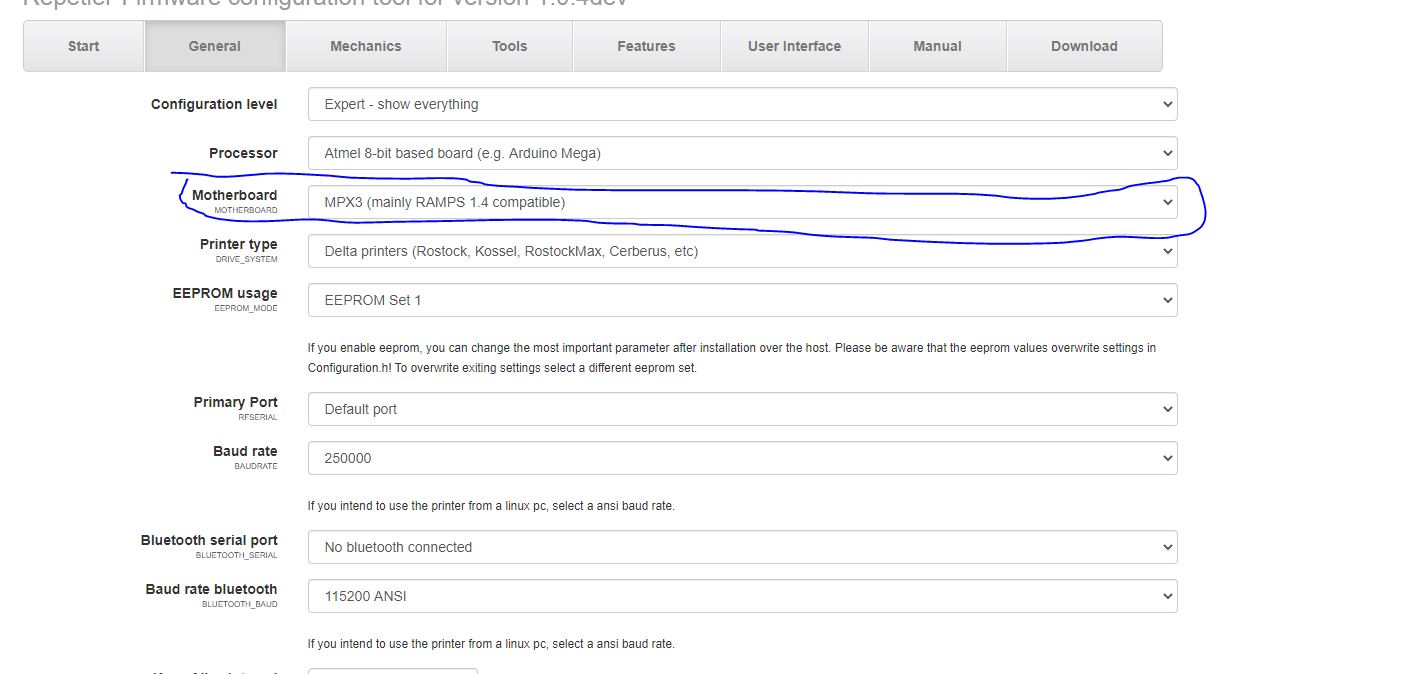

Is it possible that the board could have been damaged by a wrong firmware.
I just remembered that i when i created the repetier firmware that i at first selected a board that where RAMPS 1.4 compatible.
when i uploaded the firmware the beeper on the board started to beep loud and the stepper motors started to go down in small jumps.
i turned off the board and uploaded the correct firmware and after that the standard firmware and not its at a place where it wont work with the standard firmware for the printer and runs really buggy with the repetier firmware.
but should the board not clear it self completely when you upload a standard firmware again ?

Seems like i have fixed it...
Thanks to all the information on your forum WOOOHOOOO!!!
needed to clear the EEPROM with GCODE M502 and all is well :D :D :D
