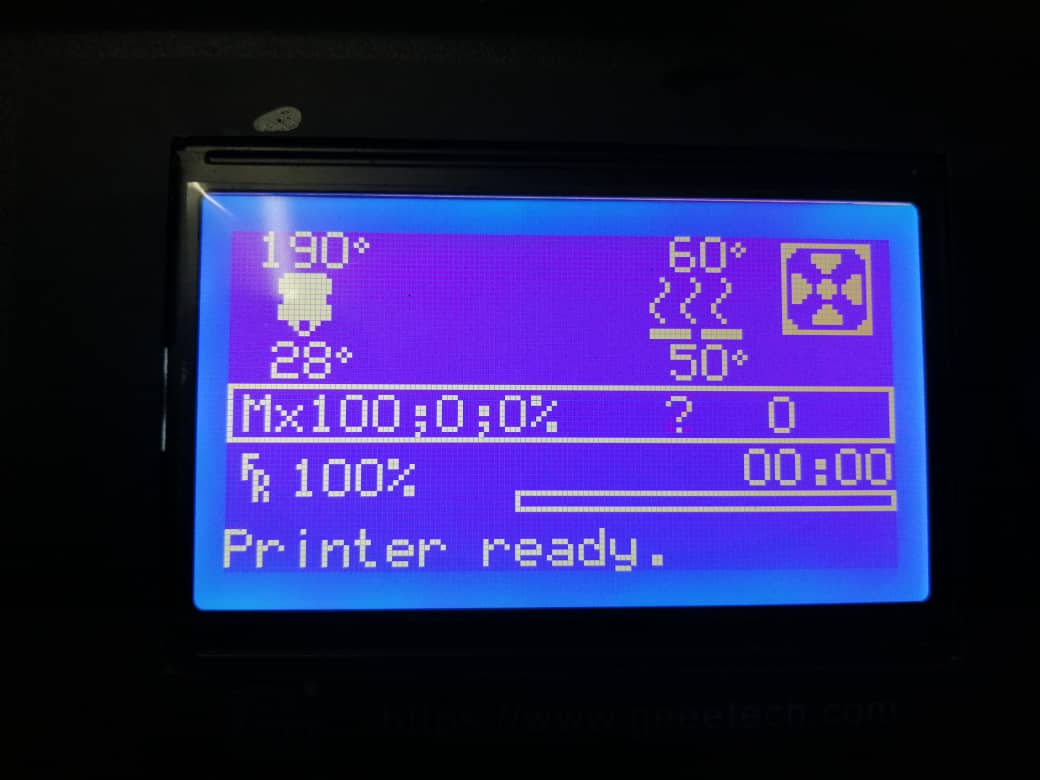

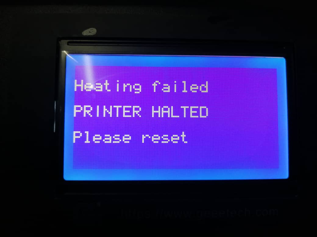

I just receive A20T this weeks,
And already install all part.
But, i still Can`t pass my 1st testing printing.
Every time i try Pre PLA Heat..
I got Error : Heating failed PRINTER HALTED Please Reset.
Bed heater is good . Can go 60 degree without any problem.
BUT Extruder Heater Not work.
I attach 2 image as your reference.
Please help, Thank you

Re: Heating failed PRINTER HALTED Please Reset
Hi,you need to check the problem firstly:
1. Check the connection: observe whether the cable is well connected to all the interfaces, or use a multimeter to test the continuity of the cable.
2. Check the motherboard: When heating, observe whether the motherboard has four lights on. It is recommended that you provide video or pictures of the motherboard during heating.
3. Check the heating module and observe whether the heating module lights up during heating.
Ok Now,
Yes, Cable not plug properly, m
After i Re-Plug all again.. Then, probvlem solved.
Thank you.
