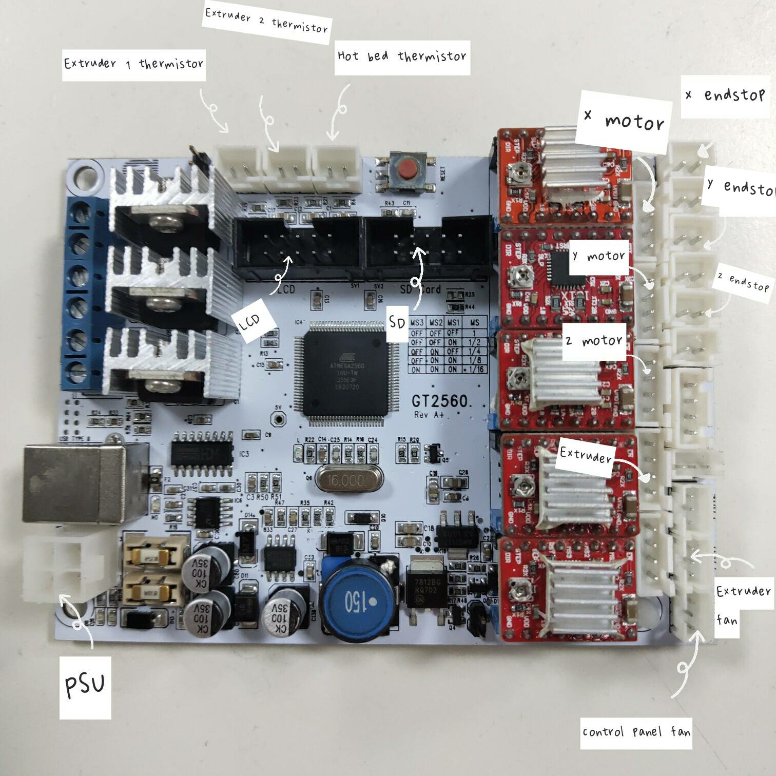

Anyways I am here to ask you wonderful folks some favors. As I said I have an I3 Aluminum and I need the complete wiring if possible. It has a GT2560 board on it.

Hi, can you show me the picture of the motherboard?

Its a GT2560 Rev A+
Re: I3 Aluminum Wiring
Hi,do you need the wiring diagram of the motherboard? Here.
