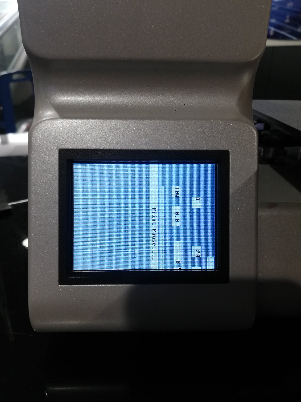

Text is not in horizontal posición but vertical position on LCD screen, how can It be fixedd back to "landscape" position?

Hi,can you provide pictures or videos? Here you can upload compressed files.

William wrote: Wed Jun 17, 2020 9:20 am Hi,can you provide pictures or videos? Here you can upload compressed files.

Hi,the screen file may be lost, it is recommended to refresh the screen file again

How can I do It? Thank you.
Re: Touch screen E180 turns on but comes on sideways, any sugestiones, ?
Hi,you can download the file on the official website, and then refer to this document:

Pjeremy wrote: Thu Jun 18, 2020 10:59 pm IMG_20200616_163703.jpg
Fixed ?
