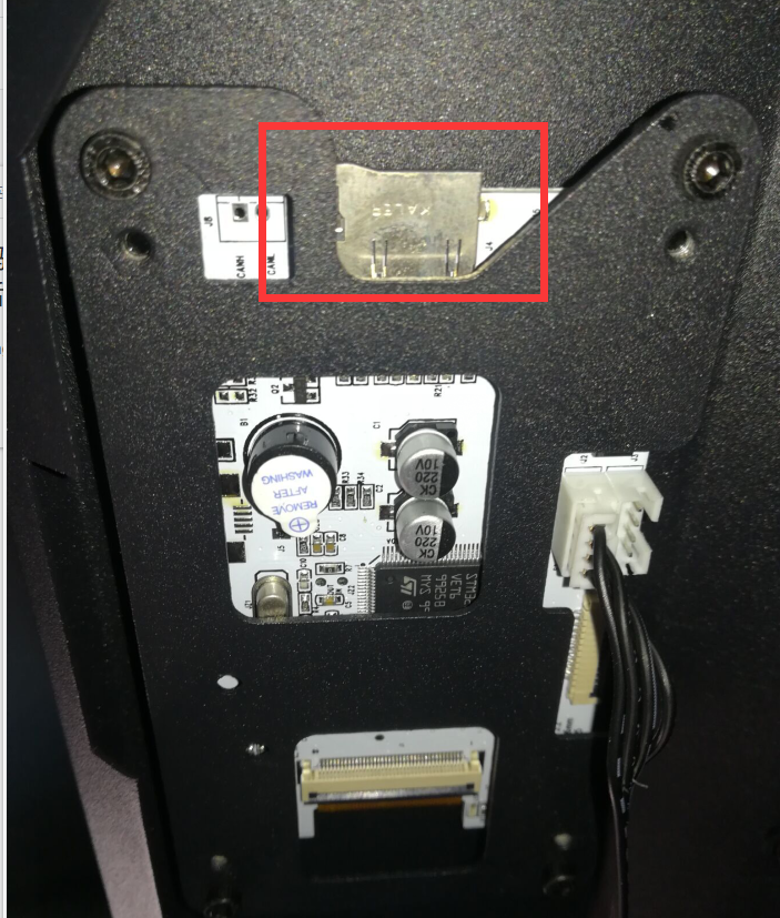

Hi, SD card should be put in
to this card slot.
