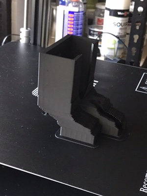

Just recieved my A30 Pro. A small and simple model turns out perfectly fine, however a bigger one was heavily deformed during printing:
How can I fix this?

After listening to your description, I have provided you with several possible problems and solutions
1. The moving speed of the print head is too fast
If the printing speed or idling speed exceeds the speed that the stepper motor can handle, misalignment will occur. The idling speed can be lowered, and the acceleration should be lowered if necessary.
2. Mechanical or electronic reasons
If the above does not solve your problem, then you need to check the mechanical and electronic aspects. Most machines use belt transmission. As time goes by, the belt may elongate and become loose, which will cause the belt to change from Long slippage on the pulley. The solution is also relatively simple. Generally, there is a mechanism to adjust the belt tension on the belt drive mechanism, and it can be solved by adjusting the belt tighter. But it should be noted that if the adjustment is too tight, it will form a huge resistance between the shaft and the bearing or may not be able to rotate. Therefore, the degree of tightness needs to be moderate.
Another mechanical problem is the machine screw (top wire). This small screw is used to fix the pulley on the shaft of the stepper motor, allowing the pulley to rotate with the motor shaft, but if the screw is loose, shaft rotation will occur. , The situation of non-rotating. This situation will also cause the problem of layer shift.
The electronic aspect causes this problem, it is possible that the power supply current of the stepper motor is insufficient, causing the stepper motor to not have enough power to overcome the resistance. It is also possible that the stepper motor driver chip is overheated, causing the stepper motor to stop rotating before the chip cools down. There are many other points in electronics.
It is still necessary to check the phenomenon of misalignment caused by the external possibility, such as improper placement of consumables, pulling or entanglement of consumables to a fixed object, which will cause misalignment.
Hope my suggestion can solve your problem.
