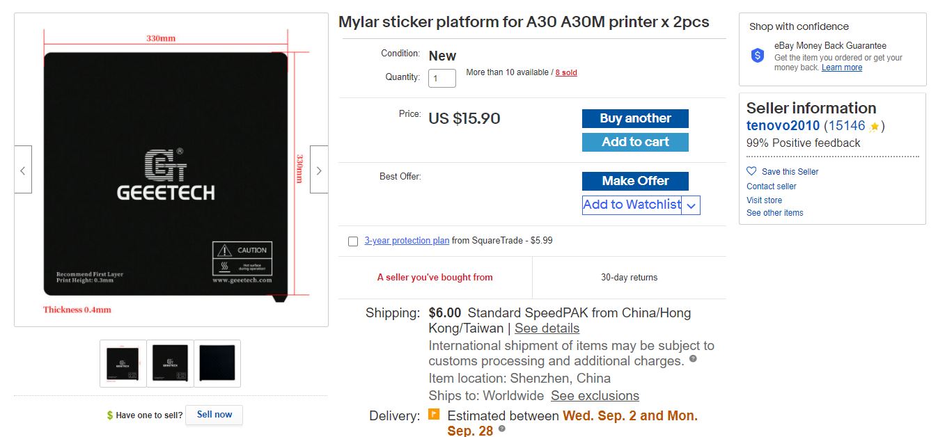

Mylar print surface is nothing to write home about. Its ruined already. I ordered 2 more but those won't be in until September. I have Athorbot print surfaces that have been going non stop for 2 years on my CR10 and this Geeetech one didn't last 2 weeks. Scratches super easy and if you're not level the PLA sticks too well and it embeds into it. No one makes a 330x330 print surface, so I am stuck with the Geeetech ones.

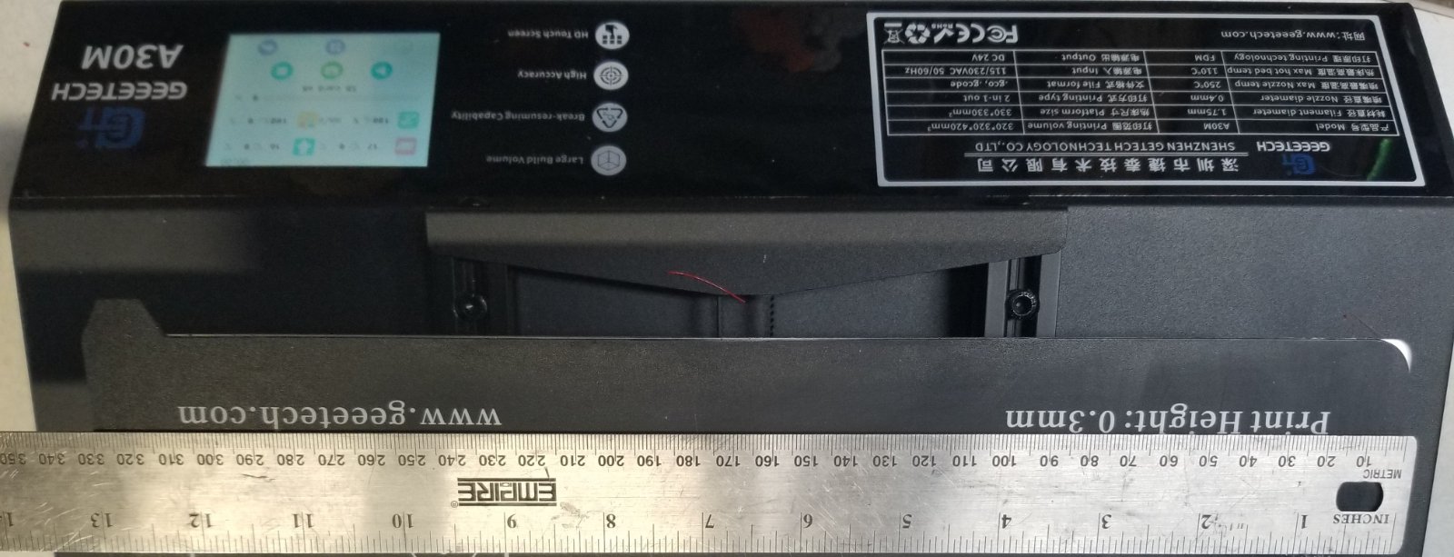

3. My print bed measures out at 330x330. Perhaps someone needs to do some looking into this (see attached photos). Maybe eBay should stop selling the ones I ordered as they are too big for my printer.

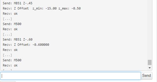

I wanted to confirm that hitting the save "button" on the screen of the A30M was actually saving the Z offset. Since I cannot get M503 to output my settings in all the different terminals I have tried, I figured I would try use the auto level screen on the A30M to display my setting for Z offset.
I used Ocotprint terminal to set the offset. When I put in anything higher than - .50 (example M851 Z-.45) I get a response that my max is -.50. So that means anything higher than an offset of -.50 and the machine just ignores the new offset, even when you hit save. Now I don't know how many times I have done this or what my offsets were, but it seems like this can be an issue. If the machine is set to reject your offset, then how is it to work correctly? I want to say that some of my offsets were in the -.2 to -.3 range. If this was the case, then this was the problem. To get a slightly higher nozzle I had to turn my sensor up a little bit so it would stop a little higher off the bed. Not much though. If I stopped turning the screw right after the light came on, it would stop too close. Now I could adjust it on the print head itself, but I have it set at the 3mm like I read it should be.
Now if I had the auto level screen up on my machine, I could see that the value was set to -.55. In the screenshot you can see I tried changing it to -.45 which the machine rejects. I still try to save it using M500. I exit auto level and go back in and my z offset still says -.55, since it rejected -.45. I then set it via terminal to -.60. I then save it using M500, exit auto level on the machine and go back in. Well wouldn't you know, it took -.60!
After playing around a little I found that my setting did end up being -.65. Now I have not tried doing this via the A30M screen at this time. At the moment I am trying a print and it is laying down well like it should be.
