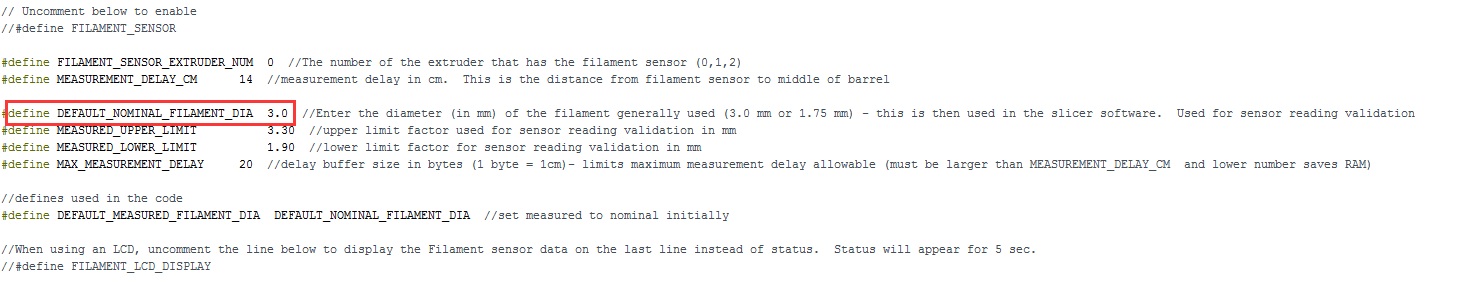

Good morning/etc; I recently replaced the main board on my printer which came with a different set of firmware than originally - I managed to update the firmware to correct for the z-height stepping due to the threading differences and a couple of other issues but I cannot get my printer to accept a filament diameter of 1.75mm rather than 3mm. As a consequence I am getting stringy nests of rubbish when I print anything.
Could someone point me in the right direction for correcting this as I have searched for every instance of the various diameter related codes and phrases that I could and changed everything appropriate to 1.75 but my printer is still saying the diameter is 3mm?
Using the Marlin-PI3_Pro_B firmware if that helps - download/file.php?id=2819
I guess that the only other thing would be to change the extrusion speed to compensate? If so could someone let me know the appropriate value and where abouts one changes that in the firmware?

Hello, you can change this position from 3.0 to 1.75 in marlin, and also choose 1.75mm on the slicing software. :D

William wrote: Wed Aug 26, 2020 11:59 am Hello, you can change this position from 3.0 to 1.75 in marlin, and also choose 1.75mm on the slicing software. :D
Thanks William; I have already changed this variable in the firmware and updated without any luck. My slicing software has the printer set up to use 1.75mm, and I have the material set up as 1.75mm PLA; all of these settings are the same from before I replaced the board on the printer and it worked well.
Still having the same issue as originally.
