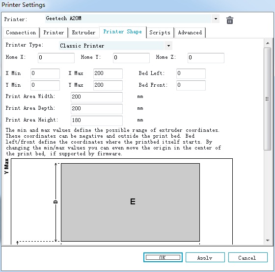

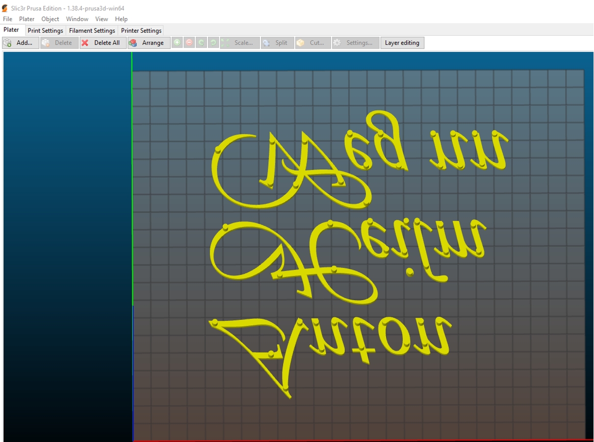

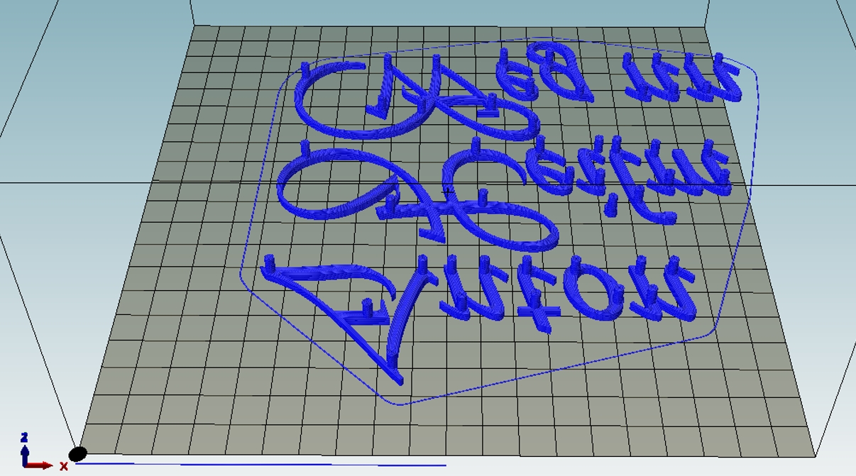

I wanted to print some letters and the size of the object ist aprox. 170mm in width, see picture 1 which was taken from the screen from repetierHost 1.6.0. ther is everything inside. Then I slice it with slic3r -Slic3r-1.38.4-prusa3d-win64-full - see picture 2 . After that return to RepetierHost - see picture 3. And when printing the object the last "n" in the first line causes some trouble when printed and the head ist rising up for a few centimeters and the Object ist missbuild.

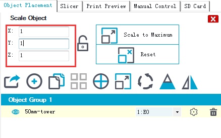

Maybe you can move the model or reduce the scale?
As shown in the picture, the size can be adjusted

in the meantime I have installed the newest Version of Repetier-Host (2.1.6) and with this the slic3r 1.3.1 on a laptop.
In the printer-settings - Bed shape the size of 200 x 200 mm.
When the printhead ist at home-Position, it needs to got to x 24 to be at the left starting position on the bed.

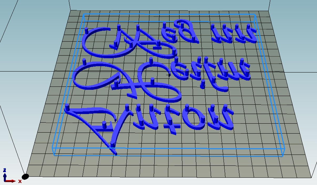

Hello, I did some add. testing - the problem (second) of lifting the printhead in the right area is solved, the cable to the fan in the printhead was too short. sorry - my fault.
concerning the printable size I tried the following parameters:
slic3r:Bed shape:size x:220 y=200
Origin x:20 y:0
RepetierHost printer settings:
x-min 0 x-max 260
y-min 0 y-max 210
width printing area 260 (x)
y: 200
z: 180
with these parameters it works and the letters are complete on the bed.

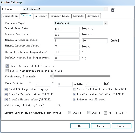

I am glad that your problem has been resolved. If you are using repetier-host, the parameters are set as shown in the figure, and the speed is the default. You can also refer to pictures.After setting, you can click this place to center the model without setting the print position.

Hello, I did some testing and now it works as it should. today I printed a object with 195 x 195 mm.
