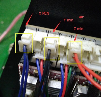

Assembly of unit was no problem, but went to level the bed. when I select manual control nothing will happen. If I hit "Home" the Y stage moves until it hits the limit switch in the back then it will not do any moves. No Manual control in any direction, checked the limit switch it seems to work ok, not sure what to do from here, is there a support # or can someone call me? 865-384-1943

Hello,
1. You can check whether the y-axis stopper is properly connected.
2. You can test whether the endstop works normally.
http://geeetech.com/forum/viewtopic.php?f=17&t=60927
3. You can exchange the drive of the y-axis and other axes to see if it is a drive problem.
