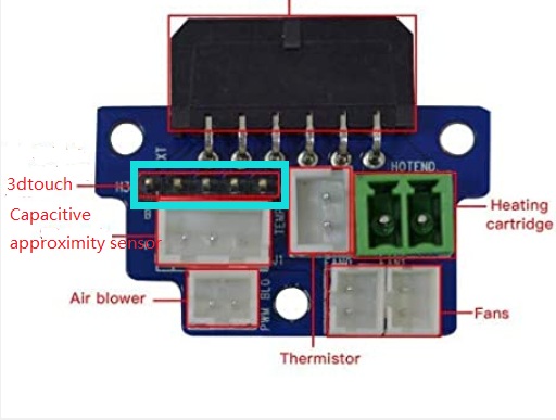

I've been searching the forum to use 3D touch on A30 that has pre installed sensor slot for capacitive sensor but i want to use 3D touch.
Already installed 1.37.58 version of firmware. Also removed the male pins intended for the capacitive sensor and connected the 5 pins accordingly for the 3D touch instead. Take note that i did not use the 3 pin slot. I used the 5 pin slot.
Enabled the 3D touch mode and the auto leveling to let me test the installed 3D touch. But it doesn't work. Please can anyone help me.
Re: Install 3D touch instead of capacitive proximity senso
Hello, you can check if there is an adapter board interface on your hot end, just connect 3d to the adapter board. :D
