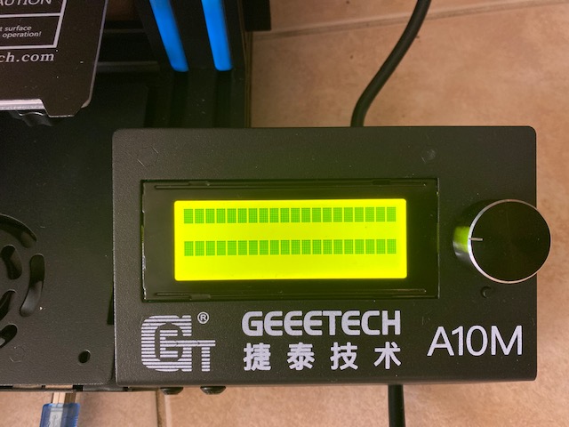

Hello everyone, I'm new to the 3d printer world be I decided I should get myself an a10m recently. Well after have it for a while I also wanted to use a spare bltouch I had sitting around. So I when to flash the vertebreak marlin firmware I compiled using Cura as my way of communicating with the printer, but after it finished and I turned the printer off and on again the screen now just shows the yellow background with two lines of black squares on it! I have no clue what I've done wrong, and I've looked through the code I compiled just to double check and everything seemed correct. I've also tried flashing firmware from geeetech's website, and tried even using geeetech's firmware toolkit, but to no avail. So does anyone have any suggestions at all? Because I'd hate to have just broken my brand new printer.

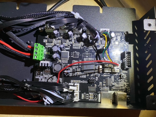

having same problem _Any updates on how to fix
Board is a GT2560 v4.1bImageImage

Have just been informed by Geeectech support that the new A10m printers come with the new V4.1b board and this board isn’t compatible with any of the current firmware that is available !
If you have tried to upgrade the firmware the board will fail and will need replacing with a new board with preloaded firmware !

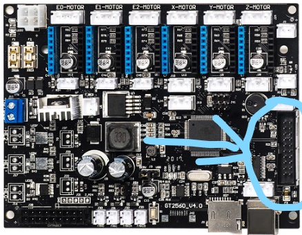

Post by Fray »
photo motherboard Old and new
Mongrel68
Posts: 6
Joined: Fri Nov 06, 2020 3:06 pm
Re: Screen Blank with black bars after firmware update
Post by Mongrel68 »
Fray.
The first photo you posted is the V4.0 board with 20pin screen connector .
2nd pic with 12 pin is the new V4.1b board .This is the one that they will send if your printer has it installed .
They will ask for the serial number of printer and that will tell them which board your printer was sent with .
