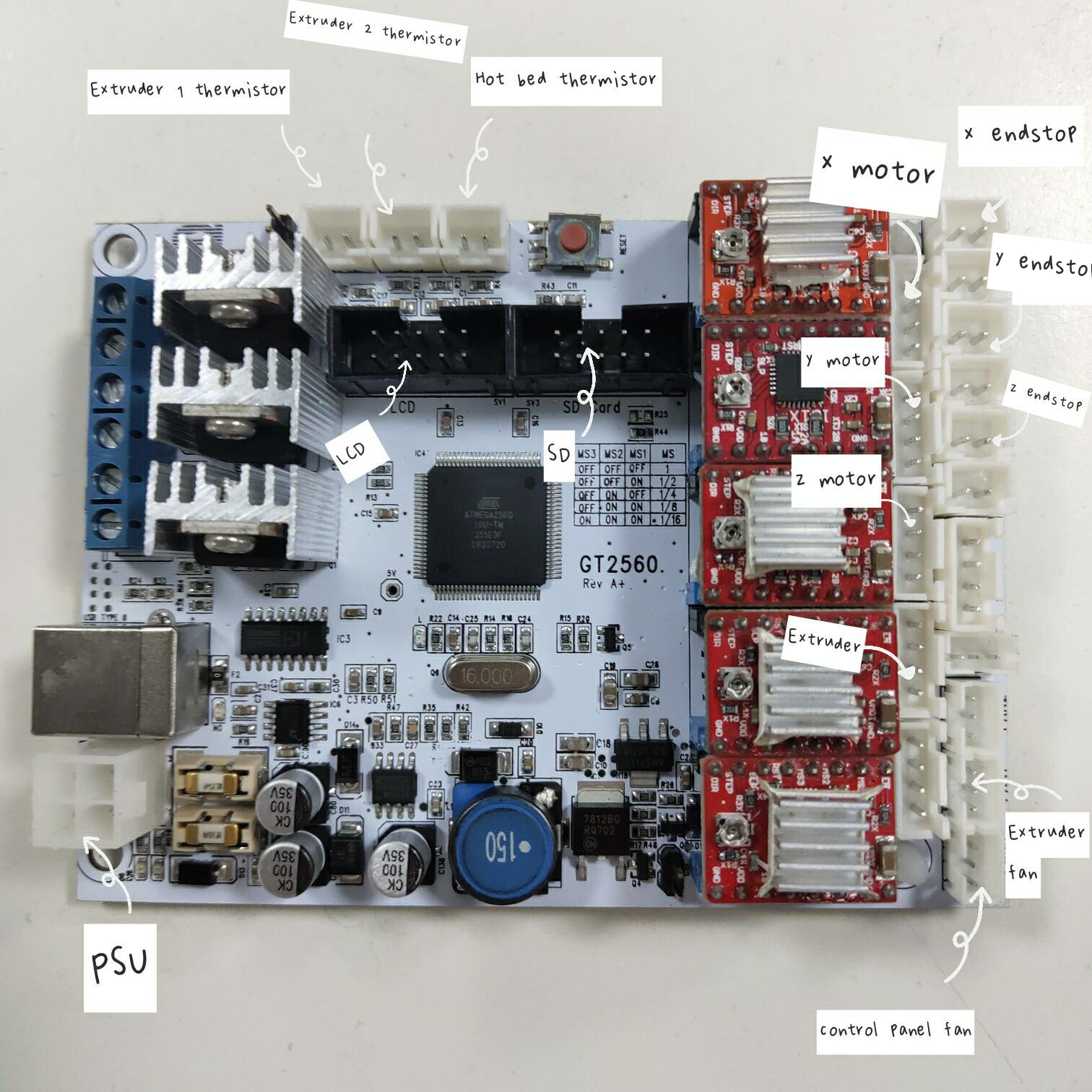

Hi guys,
I just got this printer, assembled it thanks to the video playlist on Youtube, but I discovered that there is no video about the wiring.
Since I have ZERO knowledge about wires and plugs and stuff, and since the setup instructions that I found don't show the Rev.A+ version, could anyone explain to me as easily as possible how to make the wirings please? Thank you very much!
Admin
Posts: 486
Re: GT2560 Rev.A+ wiring
Post by Admin »
Hello, maybe what you need is this. :D
