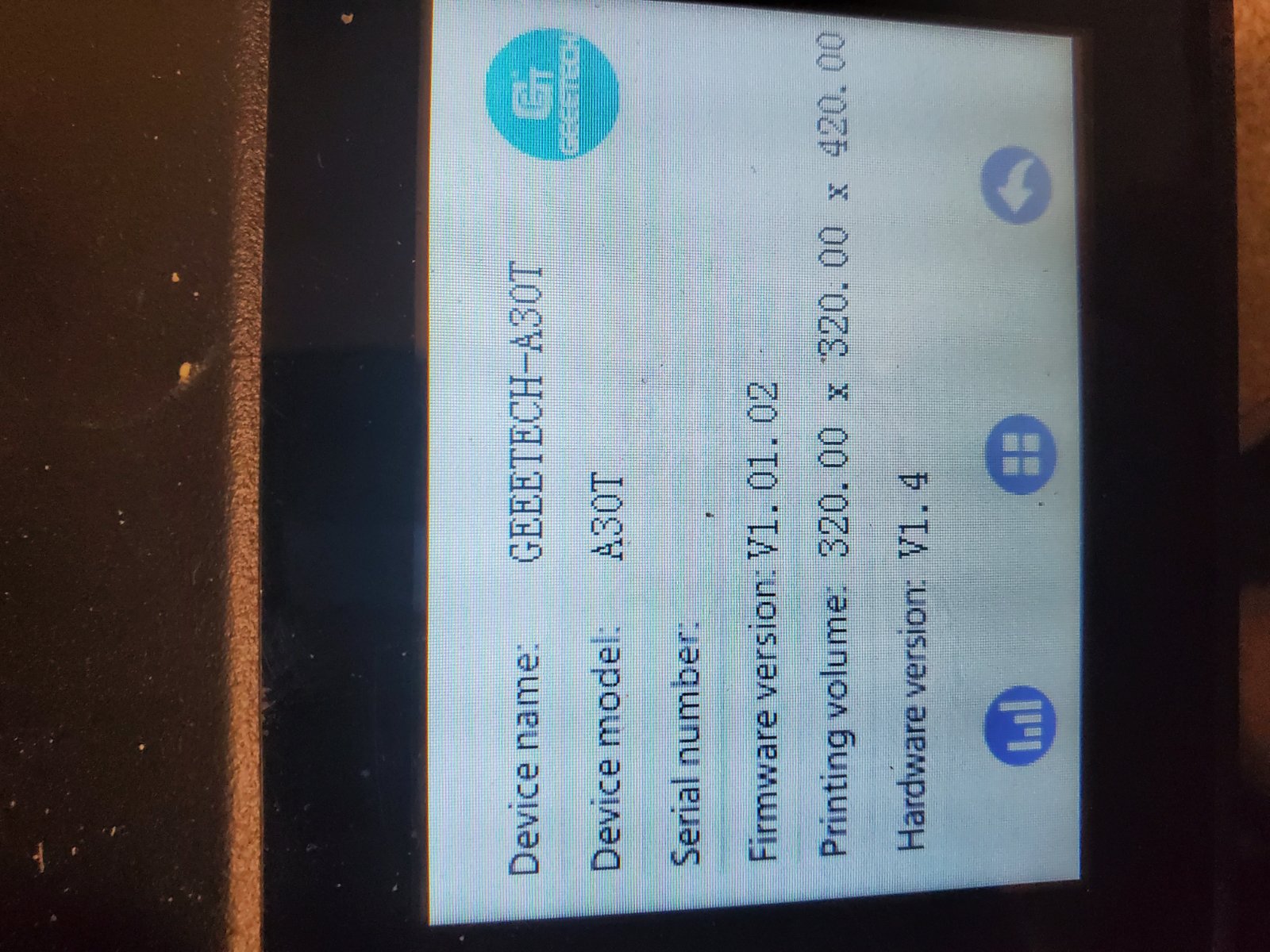

Unit info: GEEETECH A30T 3IN 1OUT 3D Printer
