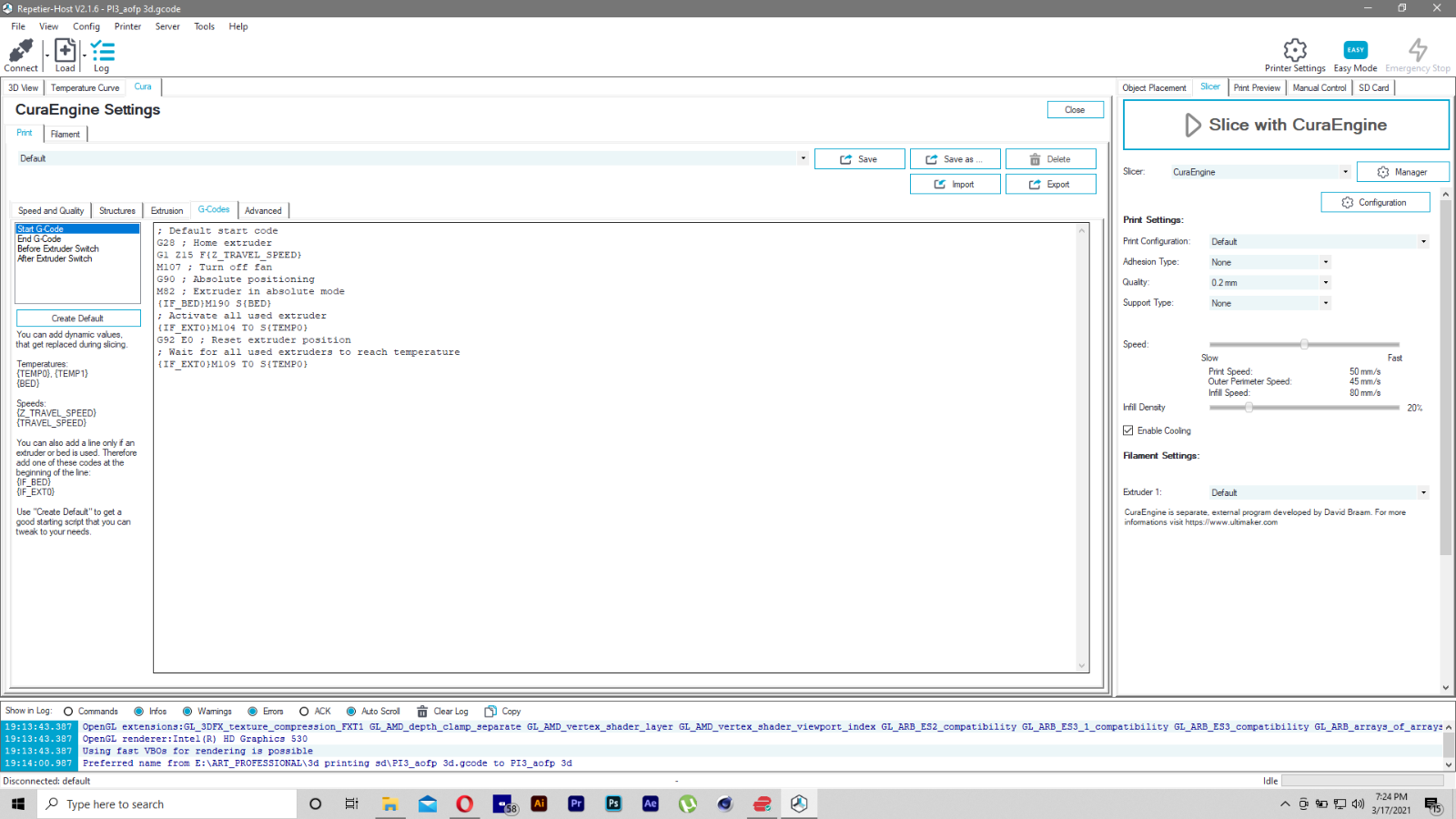

CAN I CHANGE the z step in Repetier-Host? Somewhere in the G-code? (Top Image). I am not sure what you mean by " M92 Z<your Z step/mm> then M500 to save to eeprom." I see this same thing in the post, what is the 'eeprom'?
Thank you for you patience with me, I am very novice with this.
