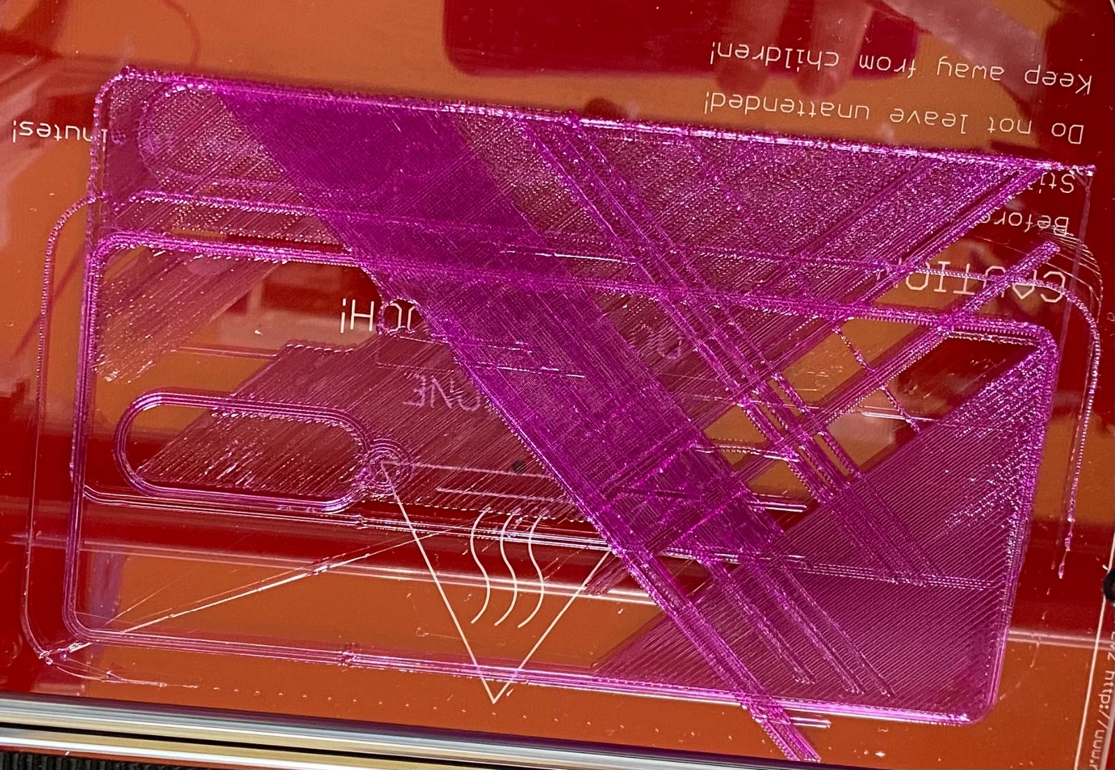

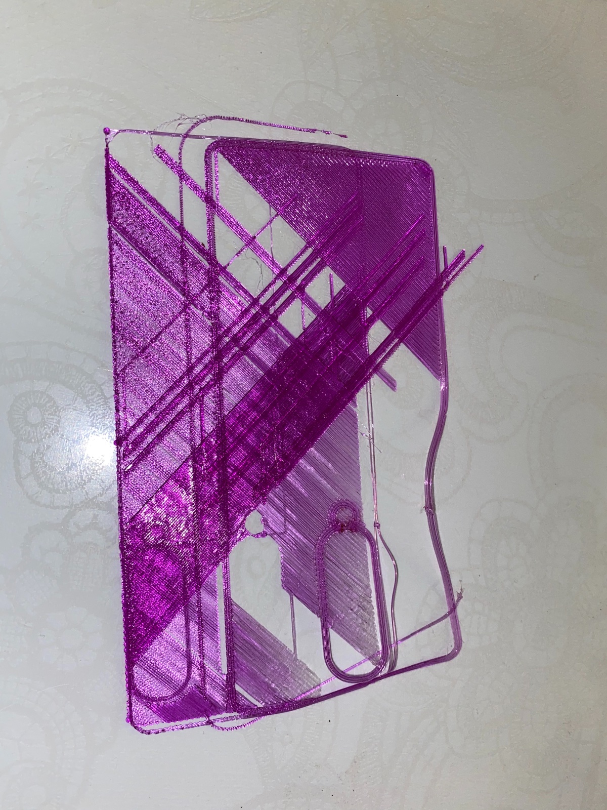

Hey guys, can anyone make sense of why my print suddenly shifts position? I just can't think of why this suddenly occurs? I am printing from SD. Using 1.0.2 with "I3 Pro W GT2560 A+ with 3dtouch" downloaded from this forum...

Hello, the reason for this situation may be that the belt is not tensioned or the speed is too fast. You can re-tighten the belt or adjust the speed.
