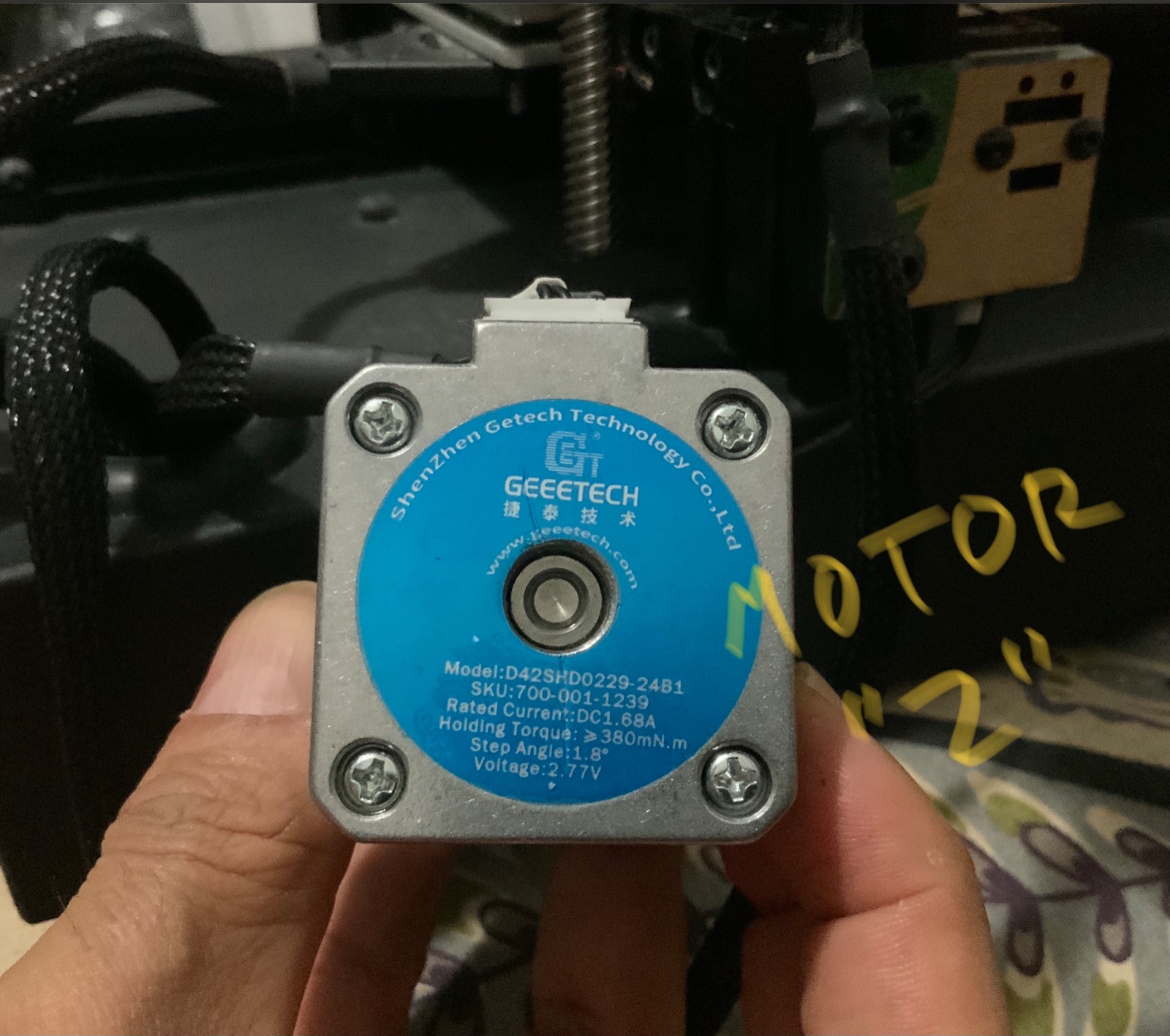

MOSF71 wrote: Mon Dec 13, 2021 12:20 am I have the same question. I don’t know the reference to buy another Z-axis stepper motor for Geeetech A20T.
I figure out the MODEL and SKU of Z-axis stepper motor for A20T with board GT2560 V4.0.
I had to remove the motor from the printer to see under the motor.
Model: D42SHD0229-24B1 SKU: 700-001-1239.
