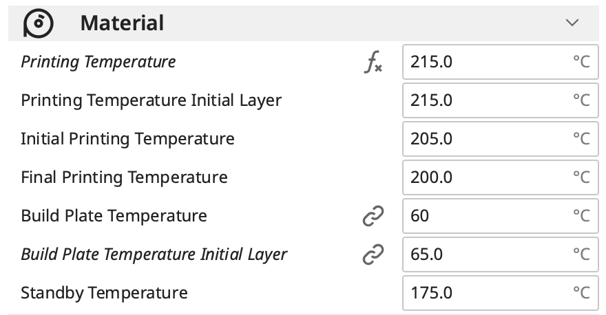

I have issues while using 3 extruders on A20T. I set printer exactly like was described here in download section with importing printer profile but still I have the same problems as before. Main problem is one heater and 3 sources of filament. I found on web "Extruders share heater" paramater for CURA, I modified json configure files but with no result - Ultimaker deleted that function because of damaging some printers. I set for PLA on all "extruders" temperature to 215 and when I use just first one than all looks OK. While using second or third source of filament then main heater is set to 0 during CURA 3-extruders logic. I am using the newest CURA and I have no idea how to fix it up and start to work normally. The problem gcode generaterd by CURA is (using only extruder no 3):

Attachment includes temperature set for extruder no 3.
