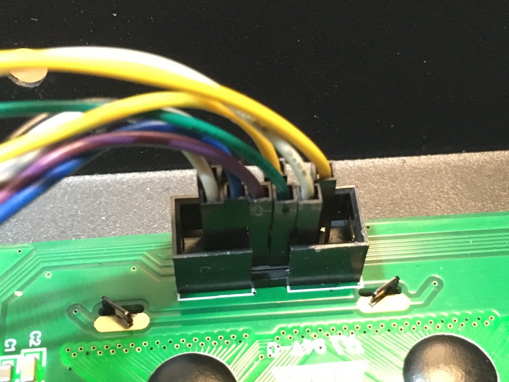

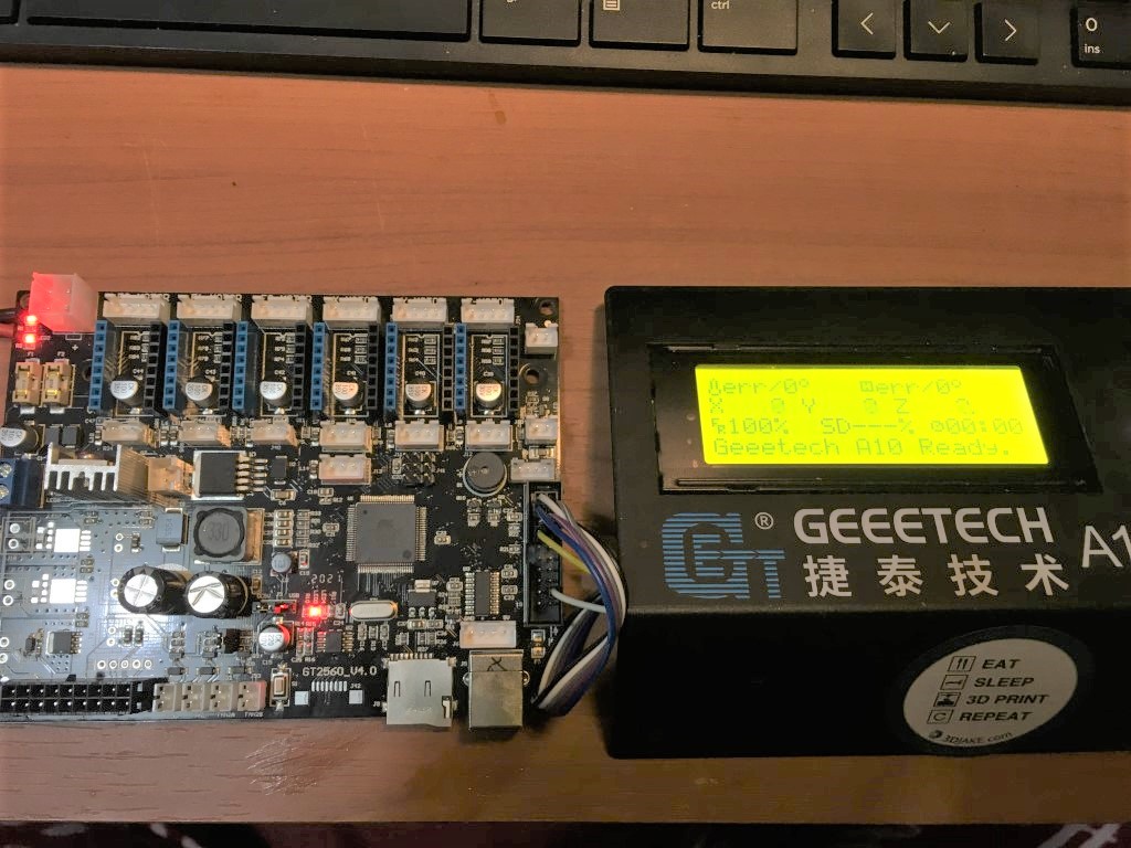

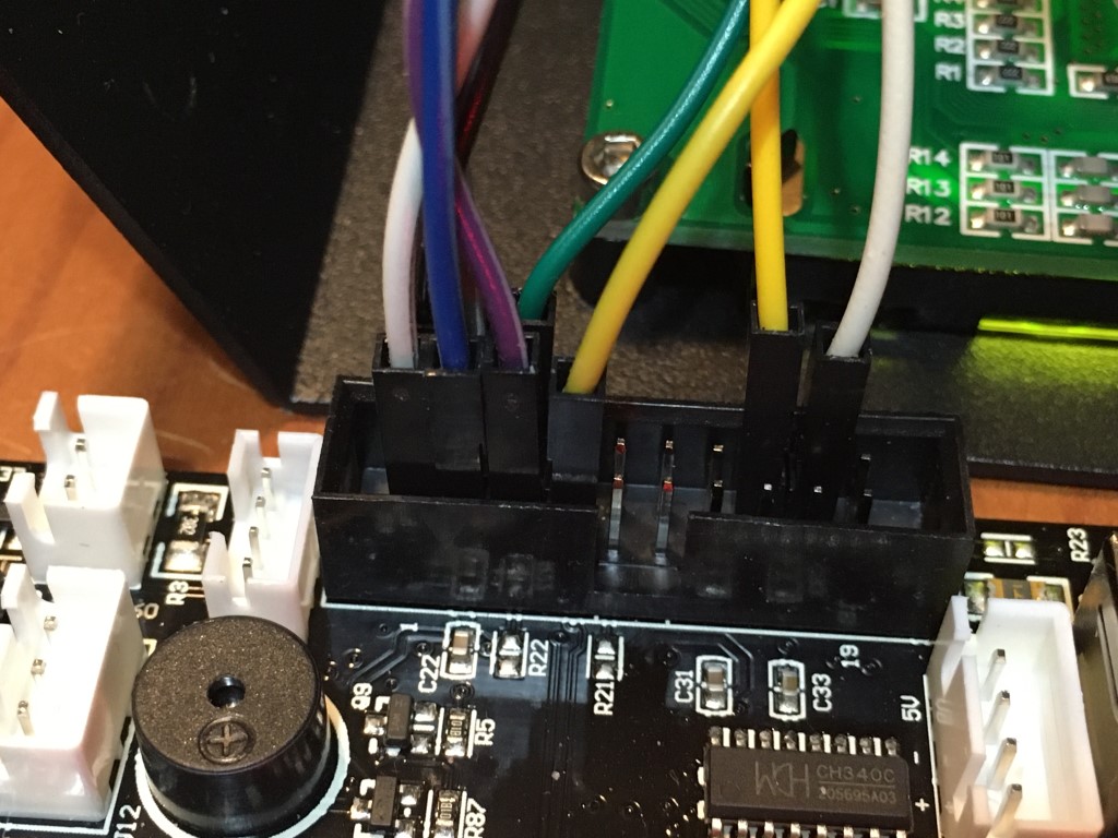

Here pictures of the test connection
Pin 1 VCC is the white left one on both connector
