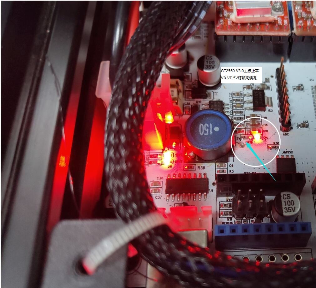

Hi, When you turn on the printer, does your motherboard have three lights on as shown below?
If the three lights are not lit normally, you may need to replace the motherboard.
If the motherboard is lit normally, you need to check if your wiring is correct.

Abedroad
Posts: 2
Joined: Mon Jul 08, 2019 6:16 pm
Re: My printer is dead
Post by Abedroad »
The LED's are not lit...next stop: the city dump. Thank you for your answer
