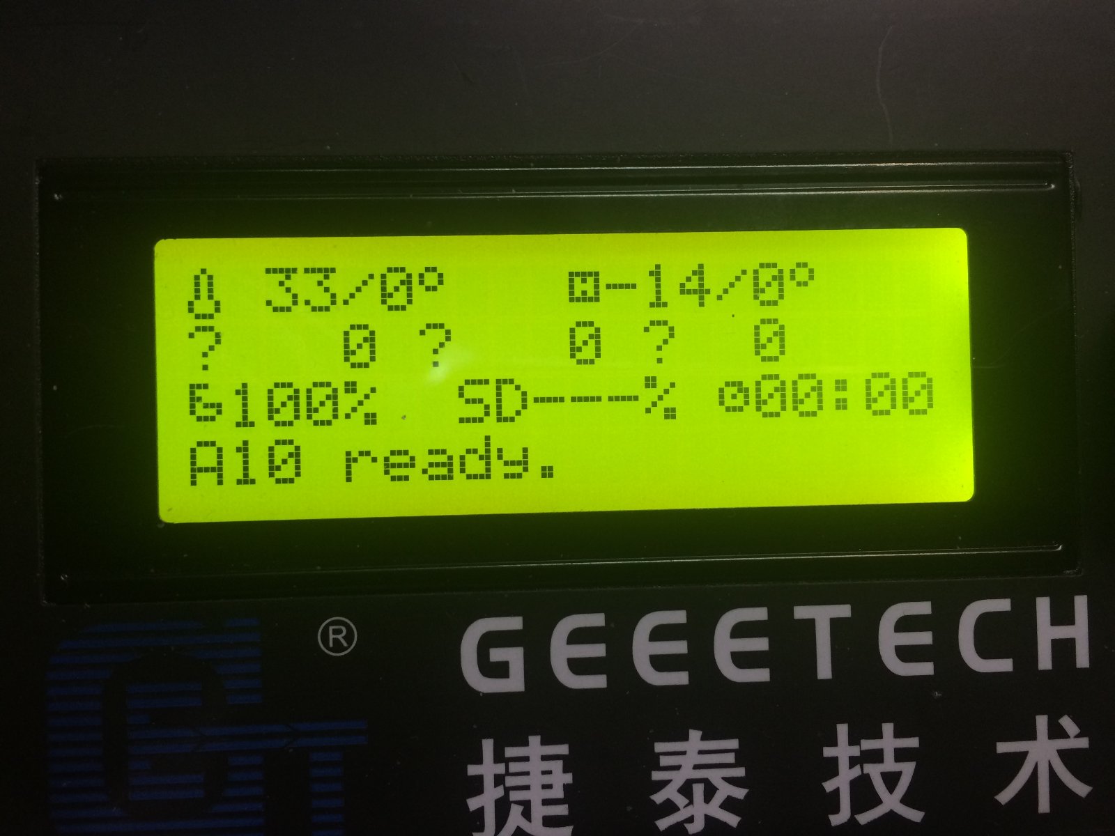

After printing very successfully for days an error popped up.
Err: MINTEMP BED
PRINTER HALTED
Please Reset
Until the error appears the D9 LED is on. Then it starts to blink and finally the D9 LED goes off and the error appears.
Another sign of the error is that the LCD reports -14 as the bed temperature.
MinTemp Error.JPG (188.54 KiB) Viewed 9367 times
Any help will be appreciated. Fortunately, I have another A10 that is waiting to be built during our teacher training, so we're not dead in the water. But, we need to know everything we can find to keep these printers up and running like we know they can perform when healthy.
Tom
UPDATE #1: After restarting several times. The after leaving it on for a bit, the -14 went away and it started showing the expected bed temperature. My first guess is that this either indicates a wiring issue or a bad thermistor.
UPDATE #2: With the LCD reporting Bed temperature as expected, a print was started. D9 glowed solidly as the bed reached 60C of 60C. The, as the nozzle started heating D9 blinked furiously until the nozzle temperature reached 210C of 260C. At the moment the bed started to move D9 went dark and the MINTEMP error popped up. From this it makes it all the more likely that the problem is at the bed end of the circuit and possible a cold solder joint.

I think I have narrowed down one path to follow in debugging the issue I'm having.
I am going out to buy some polyimide tape and clips to replace the ones I had tried previously, which I think are shorting through the existing tape.
I had tried some slightly smaller clips than those supplied with the printer and they were (1) a bit smaller and (2) uncoated. I will replace the existing tape holding the heater to the bed with new polyimide tape and try clips that are the same size and type as those that came with the printer.
To come to this conclusion, I had removed the bed and checked the solder joints and continuity through the wiring. I also tested the thermistor. I did not have a multimeter; but, did have a voltage/continuity meter. Continuity was fine.
But, I did notice some chafing of the tape from the clips. I'll know in an hour or so when I put everything back together again.

UPDATE: Polyimide change did not help
Post by TMeeks »
What I did:
Working on the theory that the bed clips may be shorting the heater board, I replaced the Polyimide tape with new tape and doubled the layers on the underside where the clips might touch. I also went back to the original clips.
Outcome:
Sadly, while it initially seemed to work, the error showed up again. At least this rules out the clips shorting something as a cause.
At this point, it appear that it could be one of three things:
  • Bed Heater
    GT2560 V3.0 board
    Cable harness
Unfortunately, this happened in the middle of the Chinese New Year, so it may be difficult to get replacement parts quickly.
Fortunately, however, we have another unboxed A10. So we will raid that one for parts. We'll first swap out the bed heater and if that does not work we will swap out the GT2560 V3.0 and, finally, the harness so that we can try to pin down the culprit.

Re: err: MINTEMP BED
Post by _kaktus_ »
Hello.
Very good deduction. :D
Do one test.
Disconnect the thermistor and check the temperature indication on the display.
Perhaps, as you wrote in your deliberations, the culprit is a poor quality connection, in a measuring electrical circuit.

Hi how are you? I have exactly the same problem, what did you do to fix it
soularb wrote: Mon Aug 12, 2019 9:00 am Hi how are you? I have exactly the same problem, what did you do to fix it
Hi, When you turn on the printer and the temperature is as shown above,
You can check if your hot bed line is fully connected to the motherboard.
The resistance of the hot bed is then measured and the hot bed may need to be replaced.
