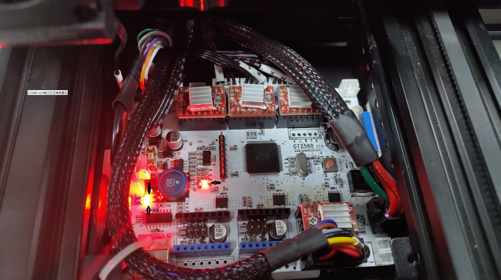

Hi, You can check when you turn on the printer,
Are there three lights on your motherboard?
You can refer to this:

Hi everyone
Thanks for the picture and the test to do, too bad I read this message after opening and closing the box containing the motherboard. I'll try this tonight.

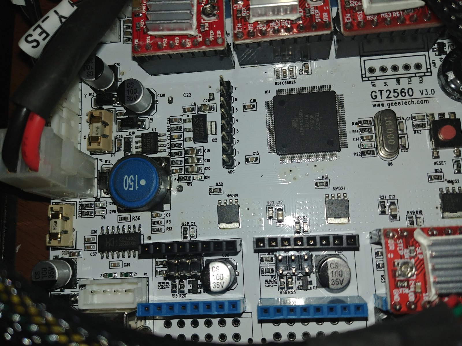

I have taken a picture too, I can confirm it is a V3, and I check the 2 fuses I found, and they're good...
Maybe it's the power supply ? The fan in the power supply doesn't work, and I remember that before this issue it was the first sound I heard when I powered on the printer.

So I tried to power on the printer, and no lights on the mainboard. Only the power switch button on the power supply gets enlighted.
What do you think ?
What do you think ?
