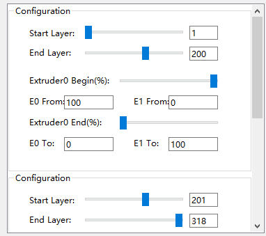

I ran a simple print through the GeeeTech supplied color program to layer the 2 differnt colors, and the result was just one color.
Yes, I imported gcode, set the configuration, executed the color update, saved the new gcode.
I uploaded the new gcode to my OctoPrint box to print, and it didn't work as expected. The printer was initailly set for 50/50 mix, and when the print started, the info panel showed 100/0, and it never changed.
So, the question is simple......how do the Marlin setting for mixing interact with gcode? How do conflicting settings work? If I set a mix, and set also set it to some gradient setting, how does this all work?

Hi, you can refer to this:
and have you set a position where the color print starts and ends?
I hope this can help you.

I wish someone would address the interaction of the mixer firmware settings.
There are several settings for the mixer that appear to interact/conflict, depending on the sequence..........
Is there anyone knowledgeable about the firmware functionality for the mixer????
Re: A01M Extruder Settings/Priorities
Hi, Can you provide a video or picture of your specific operation?

I try to print the colored gcode file, and it just prints one color.....
I think that the issue is the firmware and the gradient settings. I think that they must be both 0 for the gradient to work from the gcode file. The gradient works when setting the gradient start and stop points manually, but that's not what I want.
