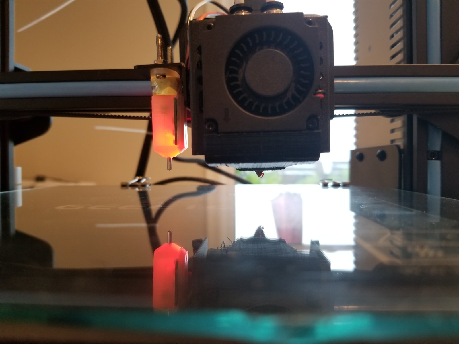

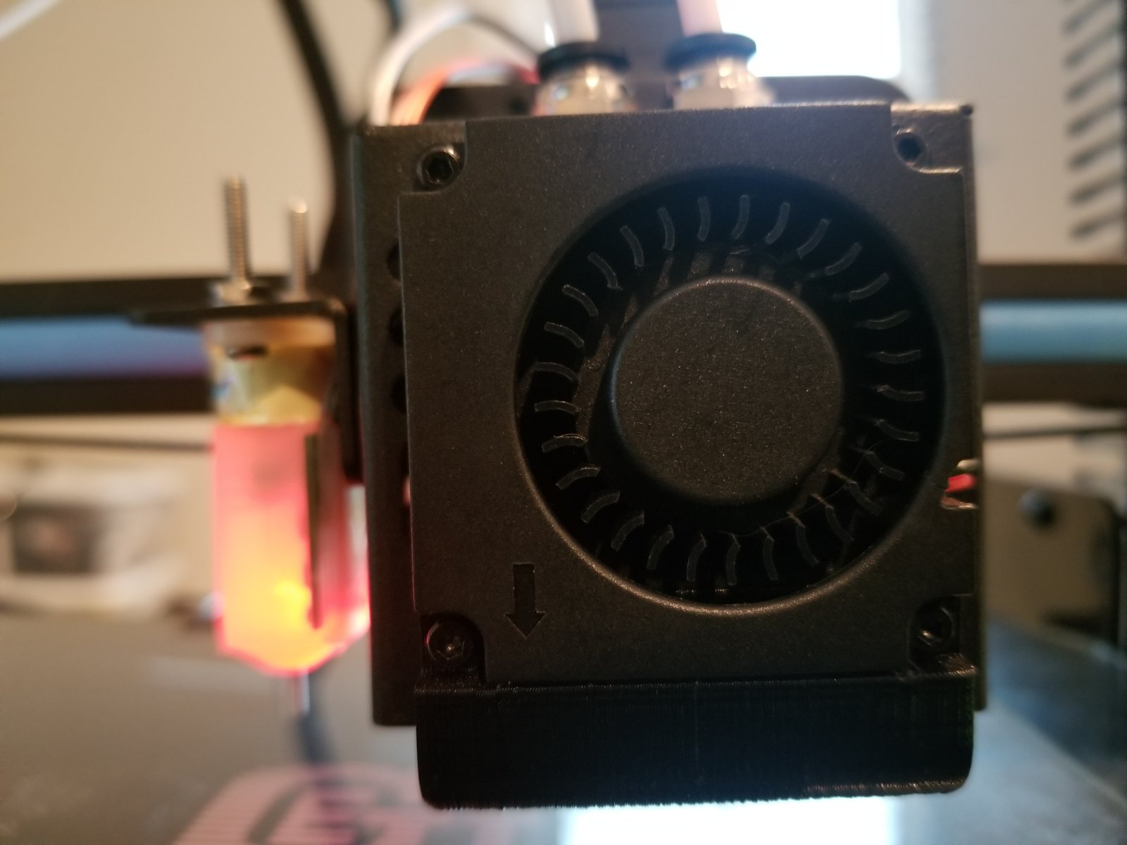

I've leveled the hot bed now for the millionth time. I'm gonna see if this time it works. I just noticed something though. My nozzle seems to be slightly twisted. Maybe it's just me though. I'll post a pic. Idk if anyone it the history of this forum has had this happen before?

Post by mattyman41 »
Here are the pictures

I am now at the point of throwing this thing out the window. I've adjusted everything you can imagine and still cant get it right. Maybe I'll just go back to the regular software. I dont want to but at least I'll be able to print. The z offset doesnt even do anything. And when I adjust the height of the bl touch it just makes things worse lol

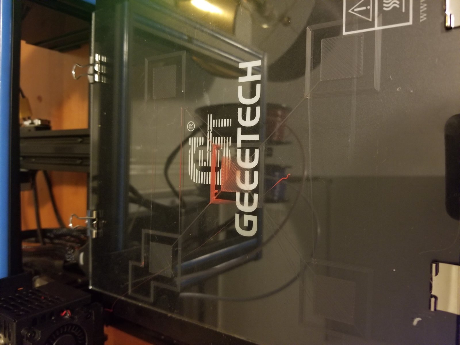

I think I found another problem as well...the glass I have is too thick at almost 13mm. THATS why my bed screws are all the way tightened down and I cant get it to level right! can someone confirm that?

Yeah no it's not 13mm thick I'm just a moron...but still...bed screws are all the way tightened and still digs into my glass. :( a offset is set correctly in the center but in corners it likes to dig in
