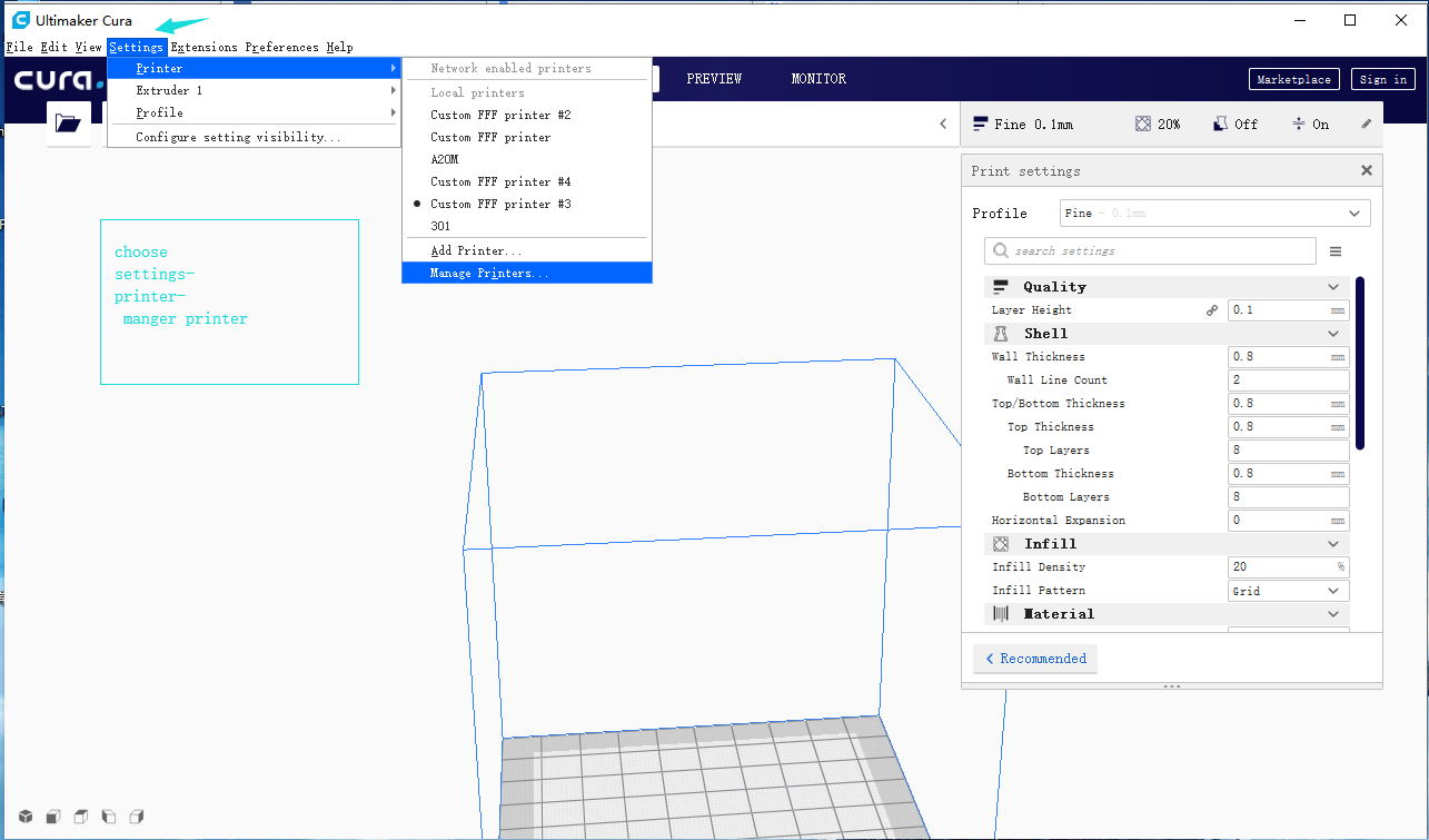

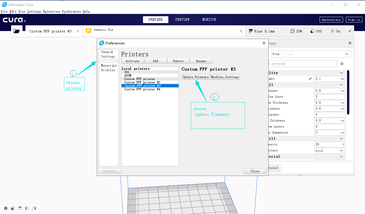

Or use cura to directly print the HEX format firmware of the official website
: https://www.geeetech.com/download.html?download_id=36
And choose setting- printer-manger printer
and update
