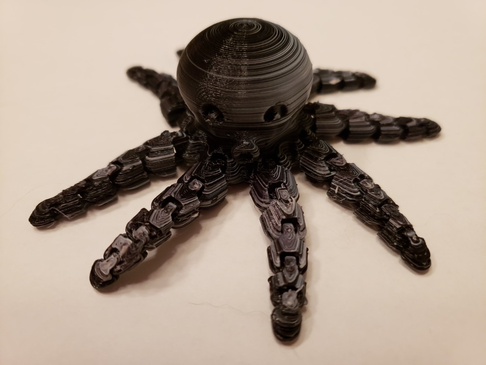

This octopus was printed with Black on extruder 1 and white on extruder 2. Minimum was set to 60% and Maximum was set to 90%.

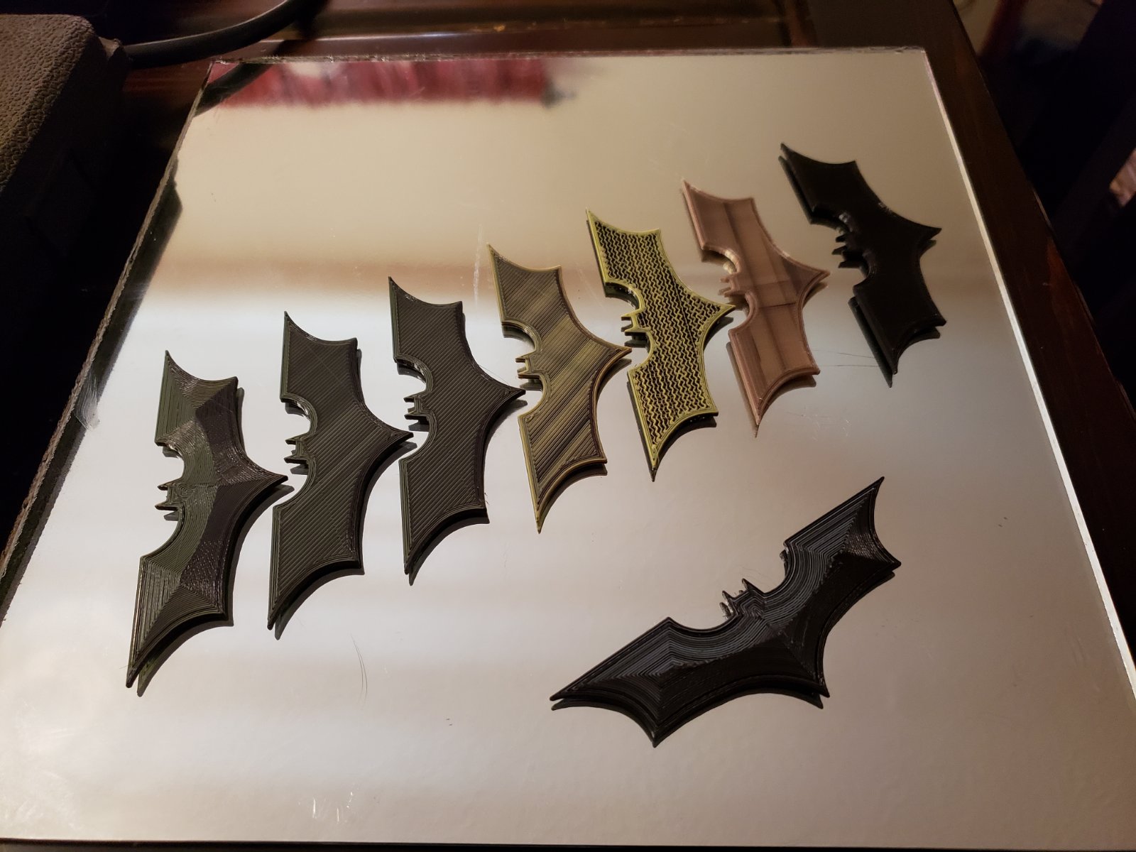

These batsymbols were printed with Black on extruder 1 and Yellow on extruder 2, with varying minimum and maximum values, varying line directions, and one with gyroid infill and no top or bottom skin.

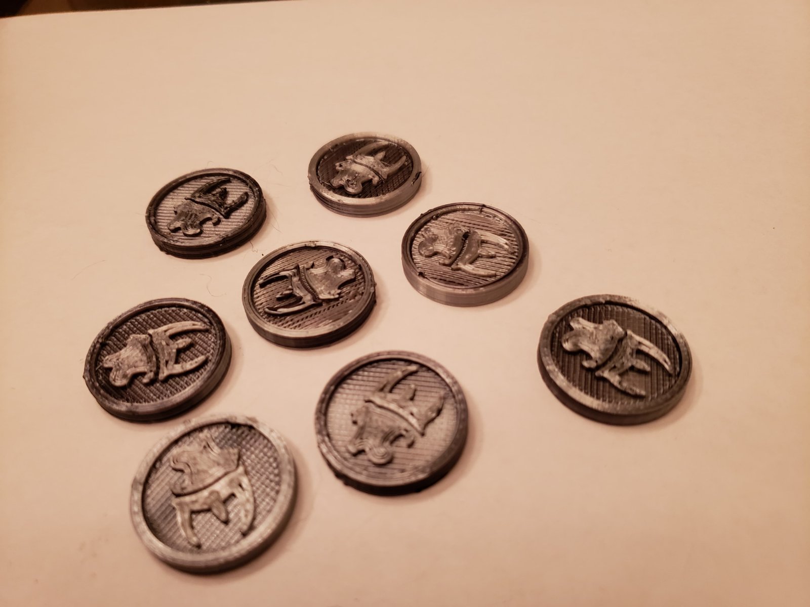

These were printed with silver on extruder 1 and black on extruder 2 with minimum 80% and maximum 100% to just give a small hint of the second color.
