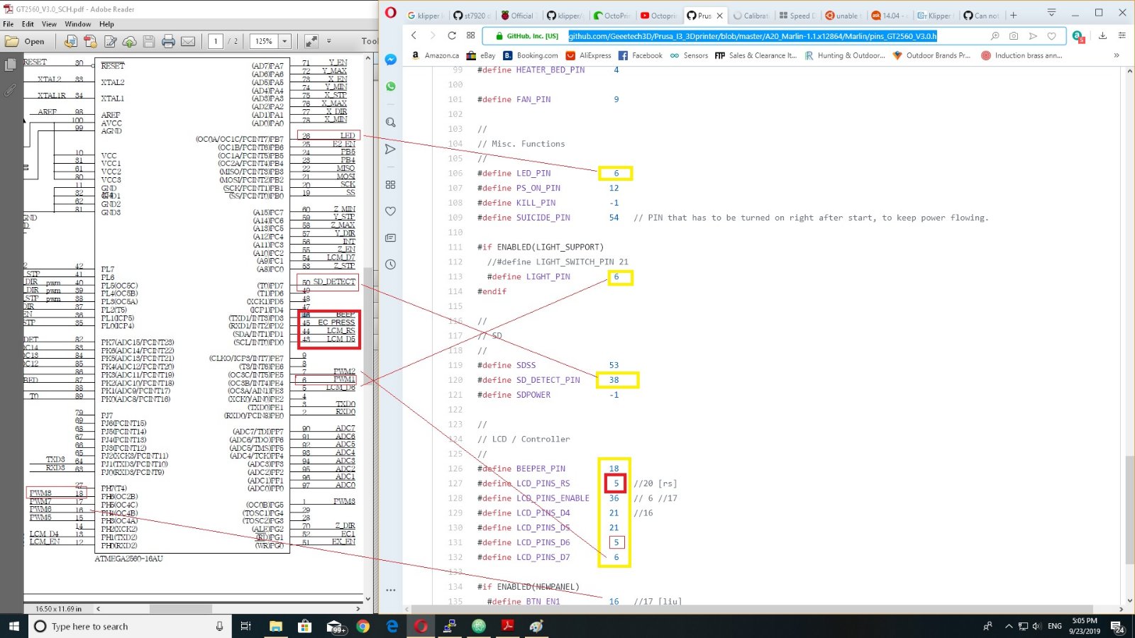

could I have the pin out for the A20M on GT2560 V3?
the pdf sch at your site vs the WORKING Marlin 1.1.8 pin_GT2560_v3.h do not match.
need the updated pin out specific to the A20M....LCD
CS_Pin

here are some of pins... but it is more than what I just marked..
would someone from Geeetech revise the GT2560 V3 for A20M sch.pdf?
pins identification from Geetech's github Marlin for A20M.
it would made thing easier and not that confusing...

- pin out GT2560 issues.jpg (206.64 KiB) Viewed 7085 times

so the pin out is not as described on the schematic.
the pin # are referring to the pin out of the Arduino MEGA board.
received help from Geetech and figured the needed pin out and got the LCD to work on Klipper FW.
