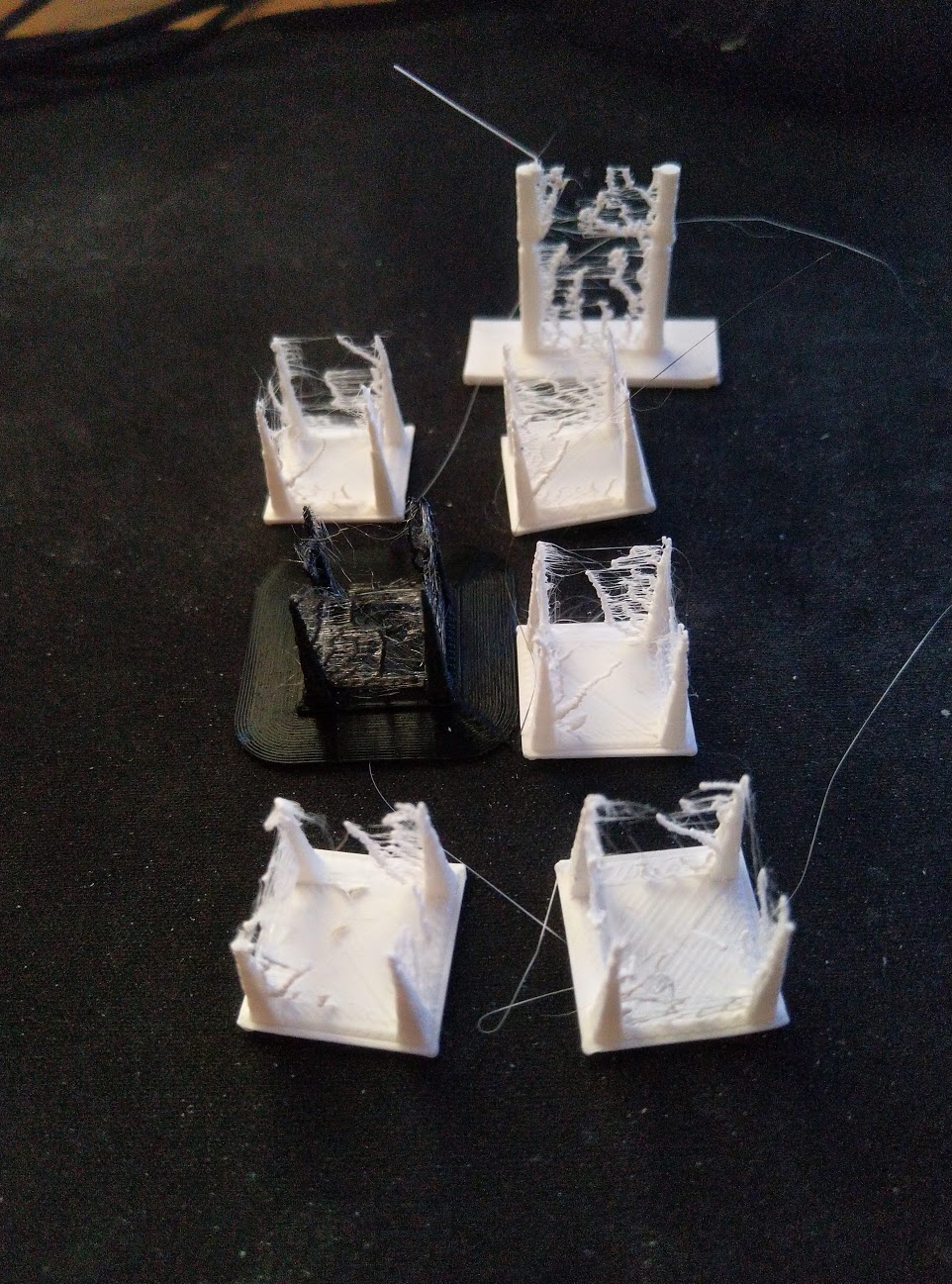

Hi Guys
Well I've got my printer for almost a year now and it was a journey to say the least. it taught me alot. i even downgraded to the A10 Hotend instead of the A10M Dual.
but there is 1 thing i can't get rid of and that's this stinging it does. no matter what i do.
So what did i all do.
  • Estep 100mm = 100mm
  • Temperature. PLA tried 190 > 215 didn't have any effect
  • Retraction from 1mm > 10mm + lowering or increasing retraction speeds 25 > 60
  • Tried Cousting setting
  • Other Slicers
  • Other Extruder from Stock to all metal extruder
  • Other Firmware Running 2.0 now
  • Followed all recommended YT solutions i can find
My A10(M) is cursed
it also came with extreme warped bed.
if anyone has a idea plzz let me know.. I'm gonna kill this machine or myself soon! :evil:
