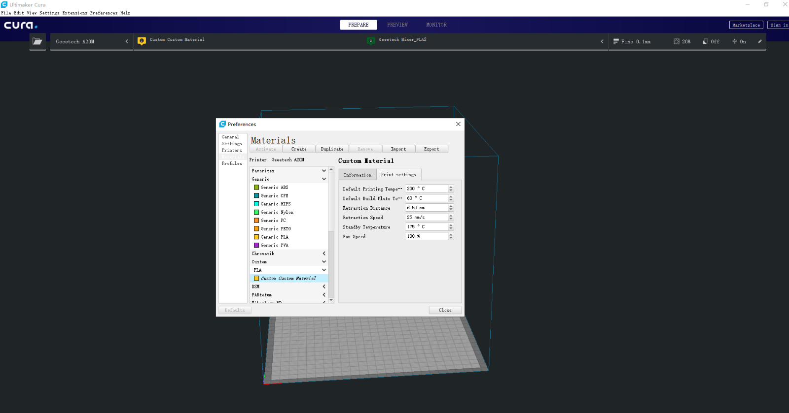

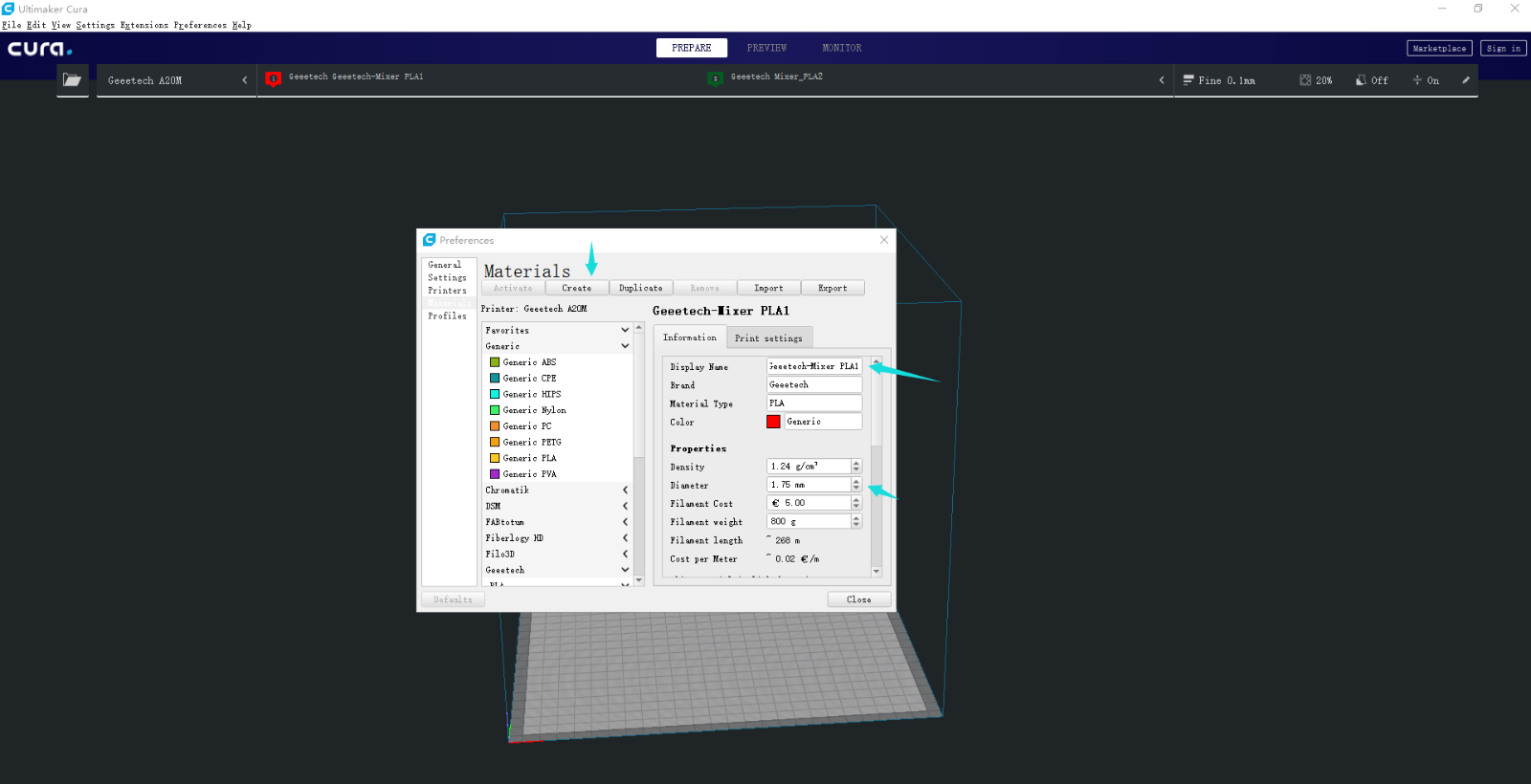

I bought me a Geeetech A20M and tried my first steps. First of all, i'll print a "calibration Cube" and therefore i use "CURA 4.4".
Adding the a20M-profile in it was easy, i found it here in the community. But ...
... how can i add the Filament-Profile? I'm using the Geeetech-PLA-Filaments
PLA 1.75mm BLACK 700-001-0426
PLA 1.75mm NEW WHITE 700-001-11-45
Is there a Filament-profile like for the printer or do i have to create a custom profile ... but with which preferences?

Hi, you can refer to this:

Hi William ...
... that was fast ;)
THX for the Screenshots.
