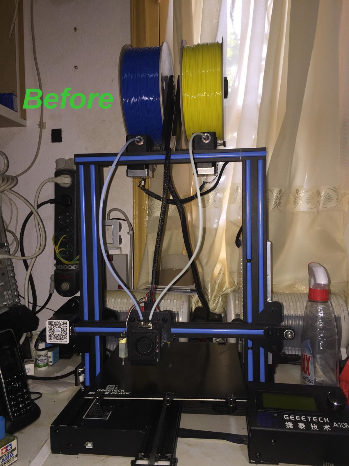

On December 2018 I got a Geeetech A10M.
It was working pretty much okay, after few months one of the Titan style extruders broke, so I replaced both of them with BMG style extruders from Triangle Labs.
However about one month ago I had hotend issues, the temperature was fluctuating frequently and I had thermal runaway errors, so I thought the hotend thermistor was dying or became loose.
I disconnected the hotend and removed it from the carriage to check it, and I put it back in. Afterwards the LCD was showing 200 degrees celsius as an ambient temperature (the heater was inactive at the time).

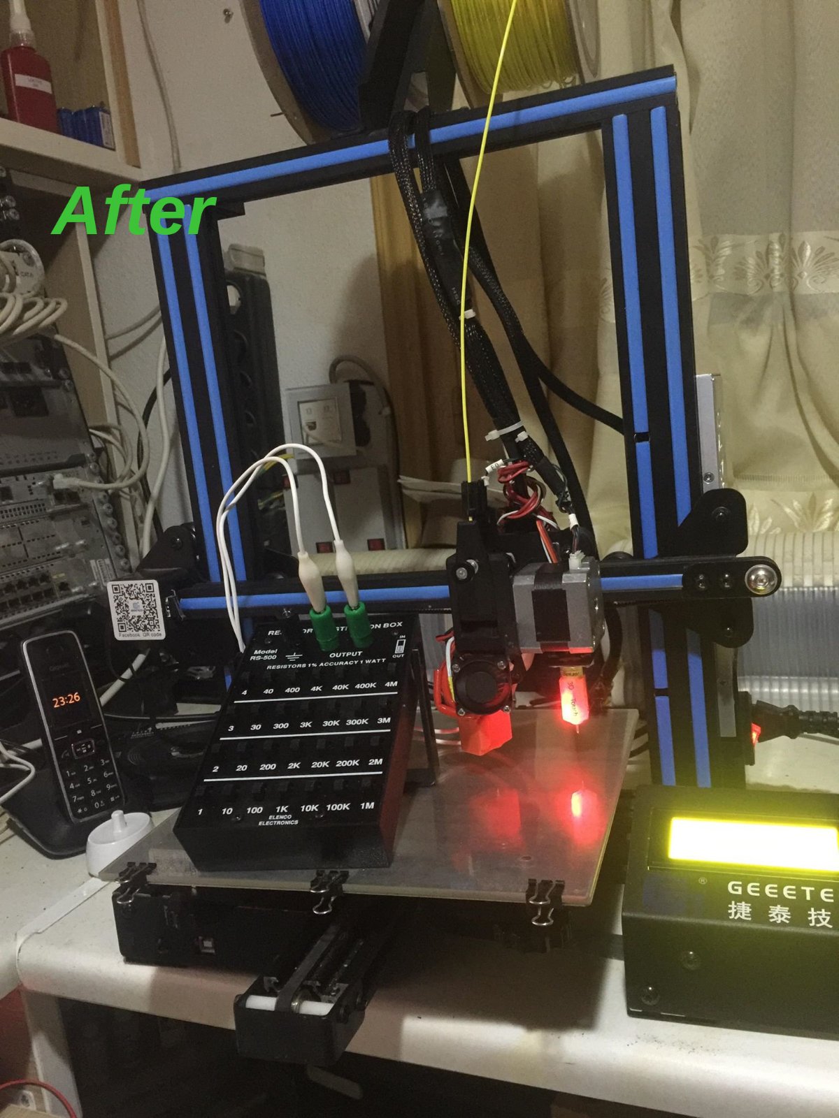

I thought it wasn't a big deal, I'll just replace the thermistor. But I also wanted to convert it to a direct drive extruder and add a Volcano hotend, so I waited for the parts to arrive. Now it has a Volcano style hotend with new heater cartridge and a new thermistor, but the printer insists the ambient temperature is 200 degrees celsius.
The thermistor type is correctly specified in the firmware, but it doesn't make any difference.
I also tried to disconnect the thermistor and connected a resistance box to try various resistances and check the temperature reading. At 0 ohms it displays 737 degrees. At 100 ohms it displays 337 degrees and pretty much from 1 kilo ohms and up it displays around 200 degrees.
So I don't think is the thermistor, it's probably the board. Everything else works, any ideas? Is replacing the board the only option?

I figured out a workaround. I only need one extruder motor now, I won't be using mixing anymore and since the thermistor sensing circuit of E0 doesn't function correctly (probably the mosfet or a resistor died), I checked the schematic and the pinouts of the board and found out that E1 has its own heating and sensing circuits. So I swapped the E0 & E1 cable connections.
Then swapped some pins in pins_GT2560_V3.0.h to make E1 function as E0.
#define TEMP_0_PIN 9 // Used to be 11 Analog Input (8)
#define TEMP_1_PIN 11 // Used to be 9 Analog Input
#define HEATER_0_PIN 3 // Used to be 10
#define HEATER_1_PIN 10 // Used to be 3
#define FAN_PIN 8 // Used to be 9
I also put a new a4988 driver on E1 I had laying around, just in case.
Now the printer works fine!!
Can a dead a4988 driver on E0 cause all this trouble, by any chance?
