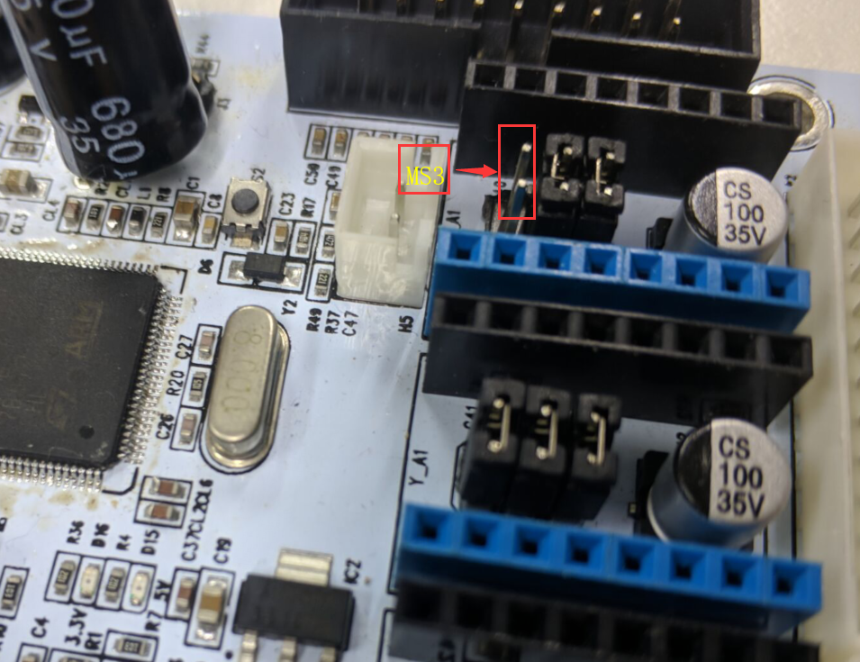

1.Install the TMC2208
You need to check the pin of it correct then remove the microstep jumper cap (MS3)off
Then install it into the driver board port.

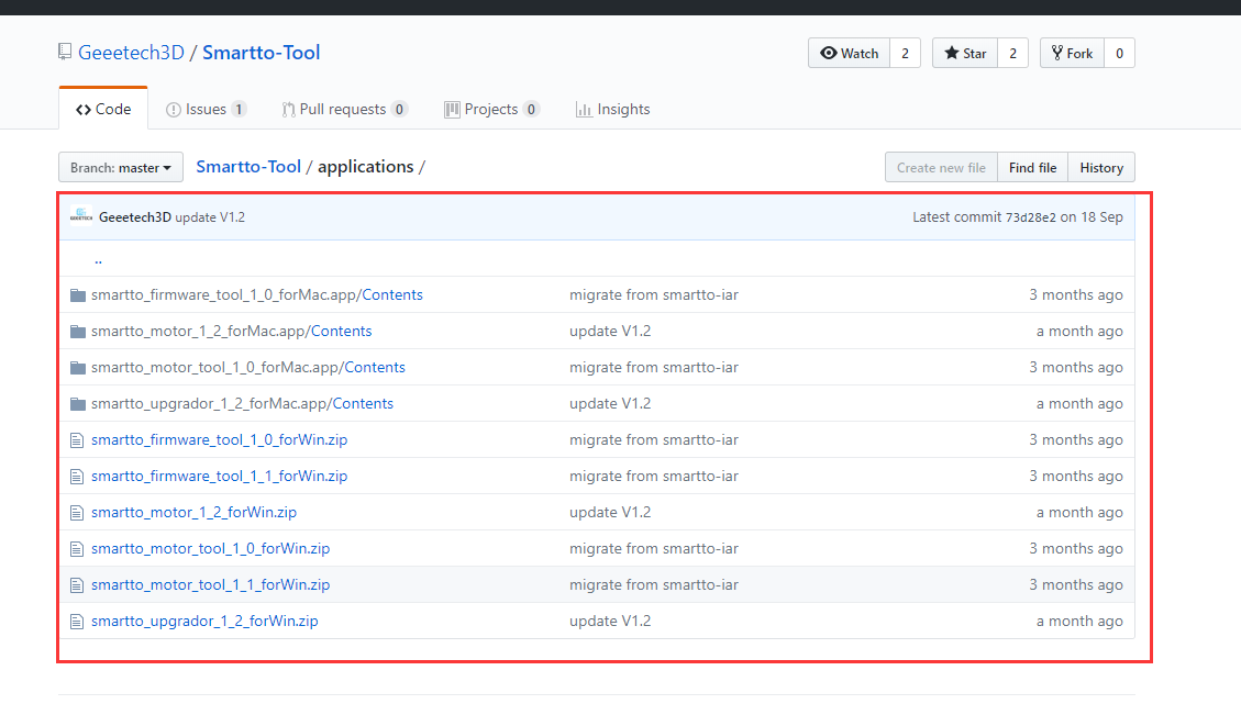

5.Use the motor kit to change the direction of the motor
https://github.com/Geeetech3D/Smartto-T ... plications
motor kit.png (70.75 KiB) Viewed 93905 times
