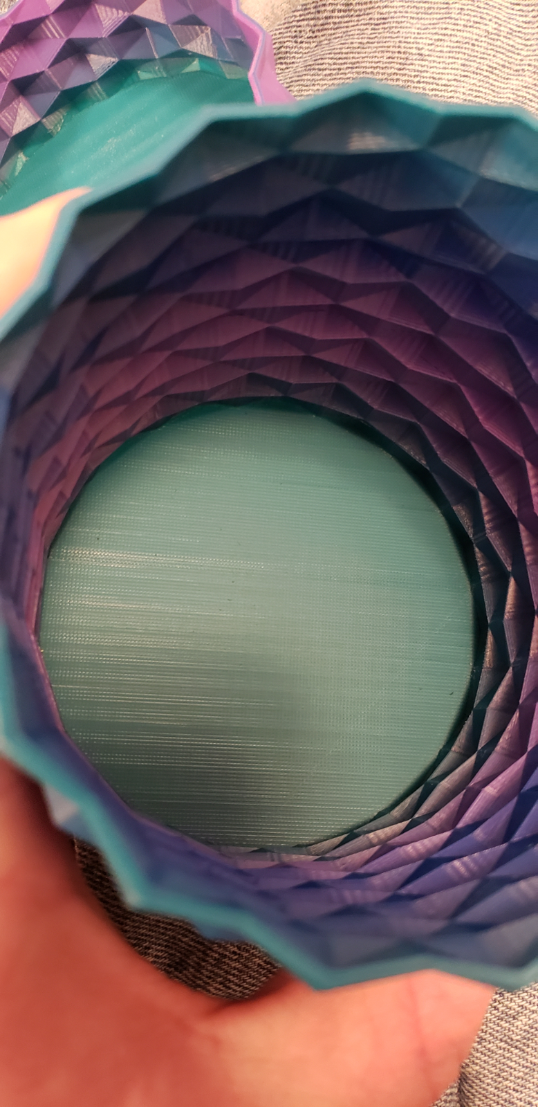

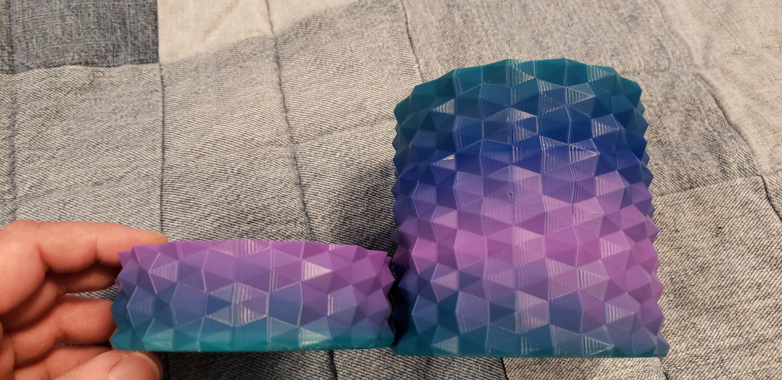

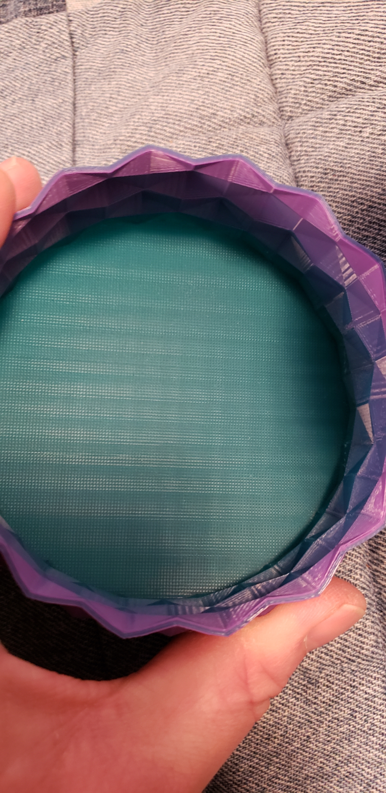

Worked perfectly!
Here's the bottoms of the two, you can't see it all that great in the pictures but the line and line spacing quality seems better with verts also.
