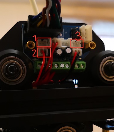

I have plug my fan on other interface of the "Hot End Plate Interfaces" as you can see on photo (Num 2 output)
But I have only 5V here and gcode instruction seems not working (M106 P1 S255 for example, the same with P2)
Num 1 was the output interface used for fan when I burnt the transistor. I have only 5V here and gcode instruction M106 S255 doest not work anymore.
Finally I use the num 3 interface but it is not possible to manage it with M106 S0 or S255 gcode with P value at 0, 1, 2 or more.
I guess the both 1 and 2 outputs of the "Hot End Plate Interface" is powered by the single mother board Fan0. And output 3 is like the output below itself and probably powered by another MB power output (other than fan0,1 and 2 MB outputs)
But May be you wanted to talk about Mother Board Interface to change directly fan 1 or 2 ? In this case, is there a way to change from fan 0 to fan 1 or 2 and power the "Hot End Plate interface" for the cooling fan (See photo 2 of Mother Board) ? It should be possible no ?
Thank you again
Fabrice
Hot End Plate Interface.jpg (35.91 KiB) Viewed 8198 times
Hot End Plate Power.jpg (54.04 KiB) Viewed 8198 times
