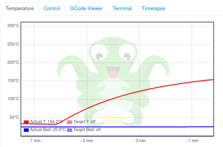

I just received my printer a week ago, and now the printer seems not to be able to go past 180C. If I leave the printer disconnected for a day, and try to do a PID calibration, the printer can reach the desired temperature only during the first minutes, but after that temperature drops to 180 at most. After that first period it takes a really long time to reach only 180 and a temperature failure error is displayed.
If I heat the bed at the same time the effect and time it takes to heat the hotend seems to be the same, so it does not seem a PSU power fauilure.
First attempt after startup:
Later attempt:
A20T Temperature failure

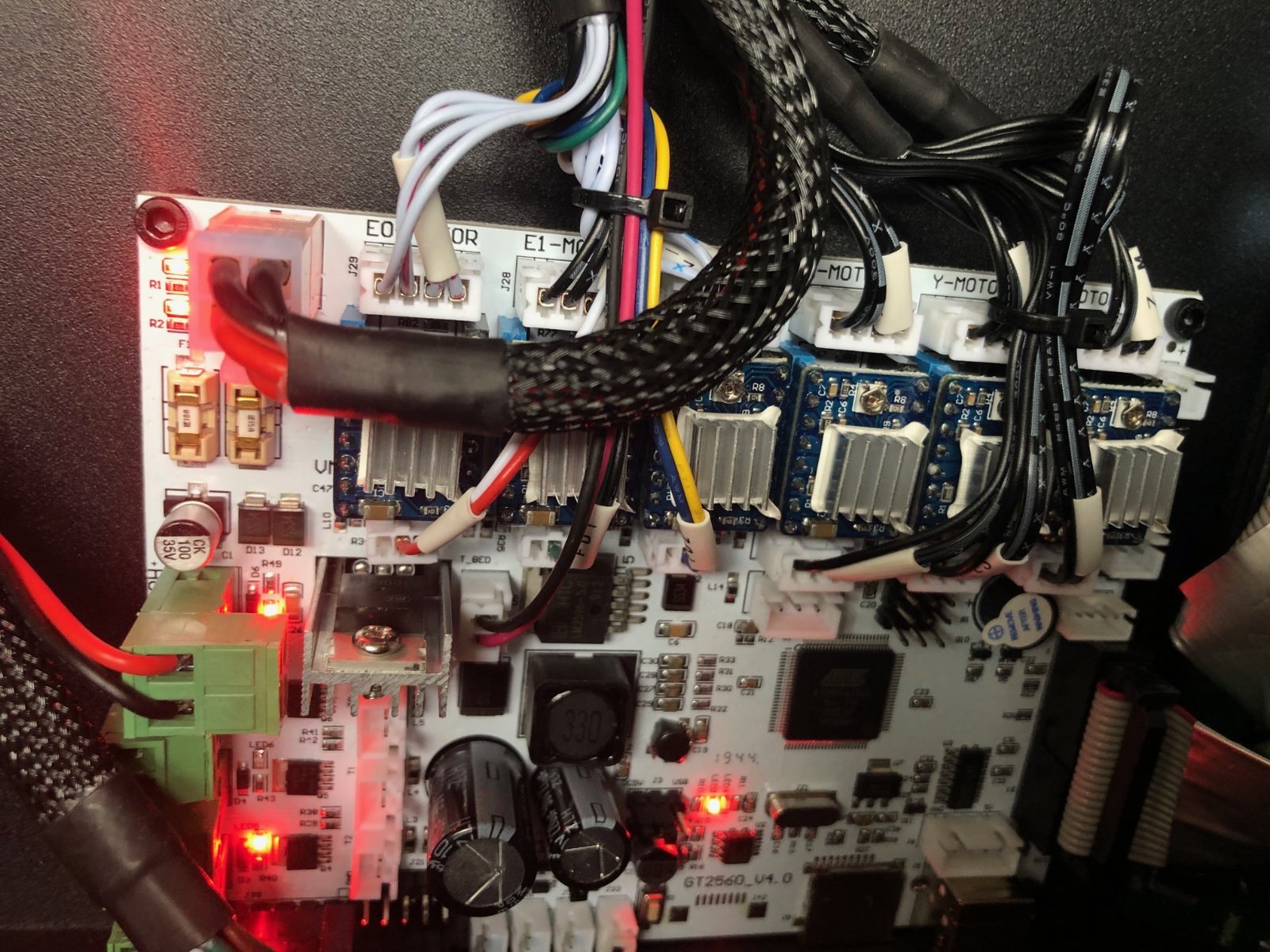

Hi, can you take a picture of the motherboard and heating module during heating?
Re: A20T Temperature failure
Here is the photo: I have use a multimeter with temperature function to measure the extruder temperature and the value is the same displayed by the printer.
I have also measured the psu output and it is solid to 24.18V during all the operation.
During the PLA heat hotbed reached temperature quickly, but extruder only reached 172C (It seems it is loosing more power every day).
E0 led was lighted all the procedure (until heating failure appears in the screen)
Hotbed led was lighted until it reached the 60C values (target temperature), and start blinking once it reaches that point.
During heating in the extruder module, the 40mm big fan is on (as always) and the small fan is off.

Hi,the the motherboard looks OK.
You can disassemble the panel of the hot end and check whether the wiring is in poor contact.
and test whether there is a continuous voltage across the heating rod during heating.

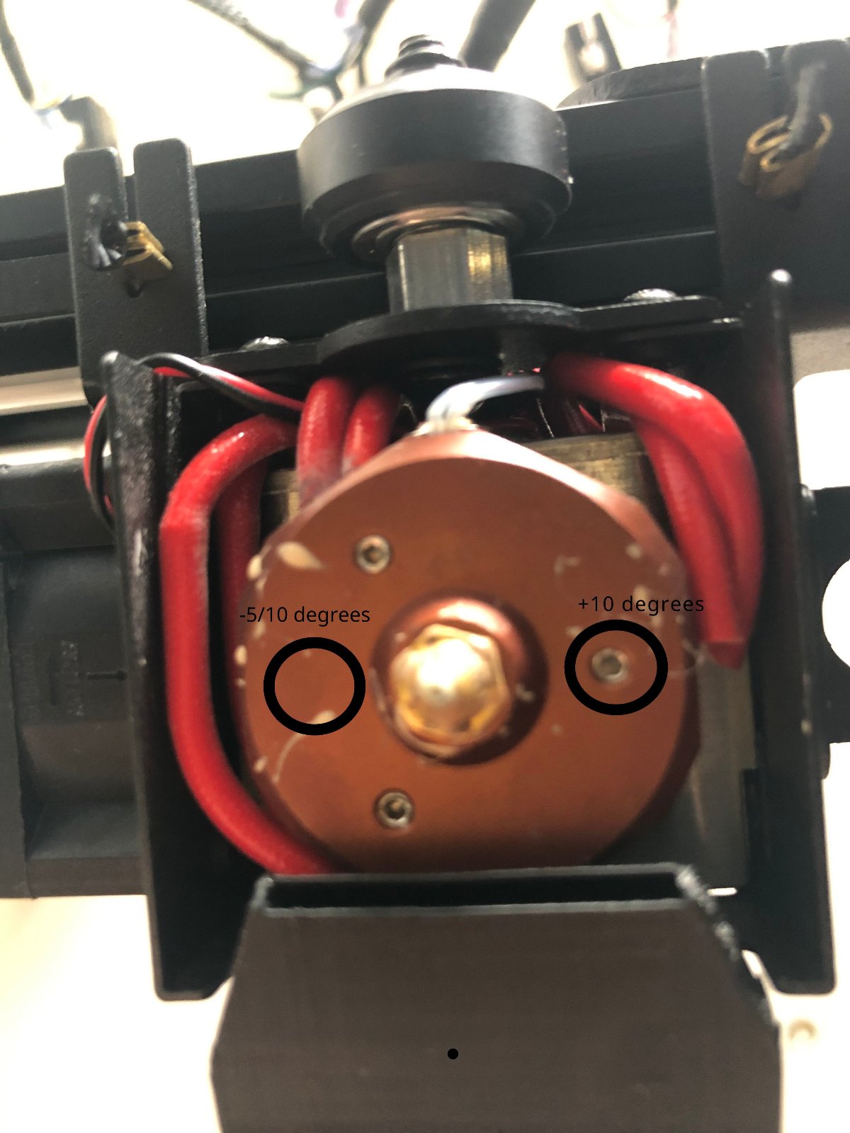

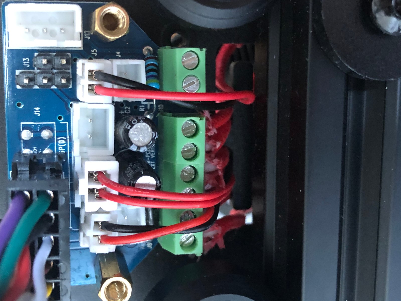

I have measured the voltage at the heating rod:
The voltage was 24v during all the heating operation in all the three pairs.
I have also checked the connections and everything is fine.
The resistance for each pair is also 25 Ohms.
Measuring temperature near the three hotend connections, I can see that one of them is always 10 degrees over the thermistor value, and the other two are 5/10 degrees below the thermistor temperature. (The hottest part is the one opposite to the fan, so this can be a normal behaviour).

if the heating rod has voltage, it means that the motherboard can successfully transmit voltage through the wire.
This should be the hot end issue. It is recommended that you replace the hot end.
