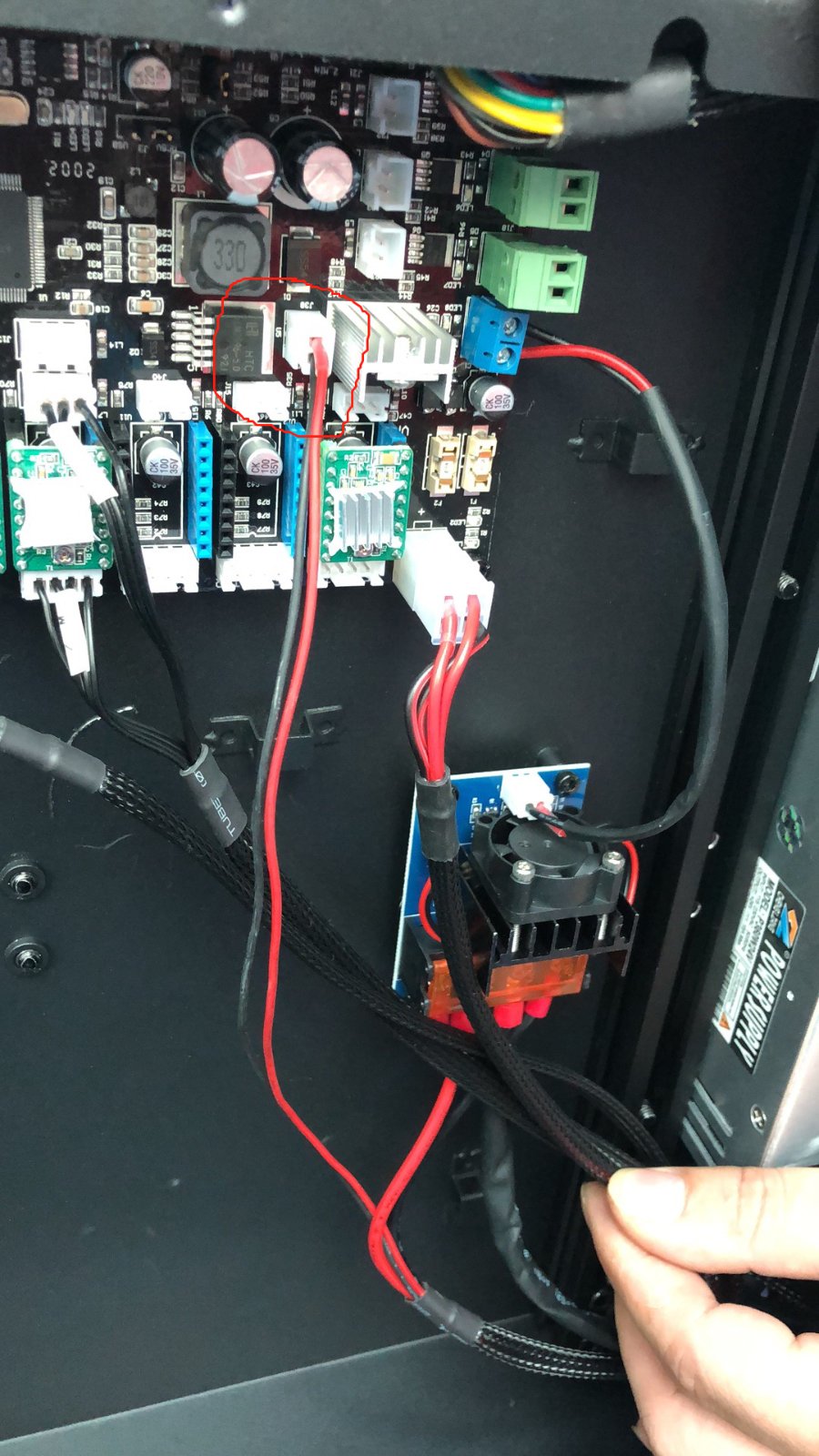

Hi,if the connecting line between the hot bed and the main board is unplugged (as shown in the figure), or 51 ℃ is displayed, the main board should be broken.

It seems that I don't have the same motherboard.
I unplugged this connector (the only one that leads to the bed), but the temp still the same :
Re: Bed temp sensor stuck to 51°C
Hi,the motherboard should be broken.
You can contact the salesman to replace it.
