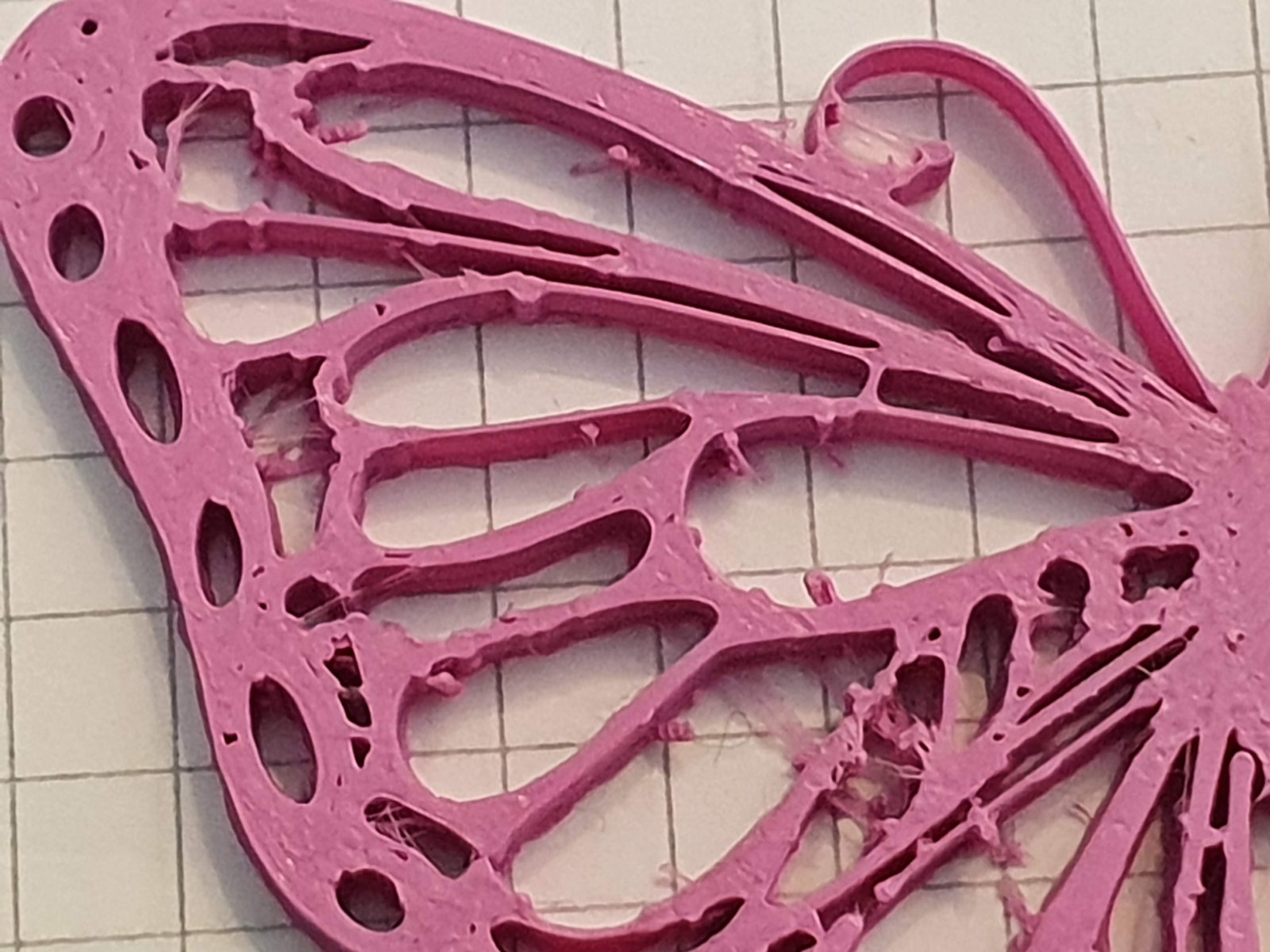

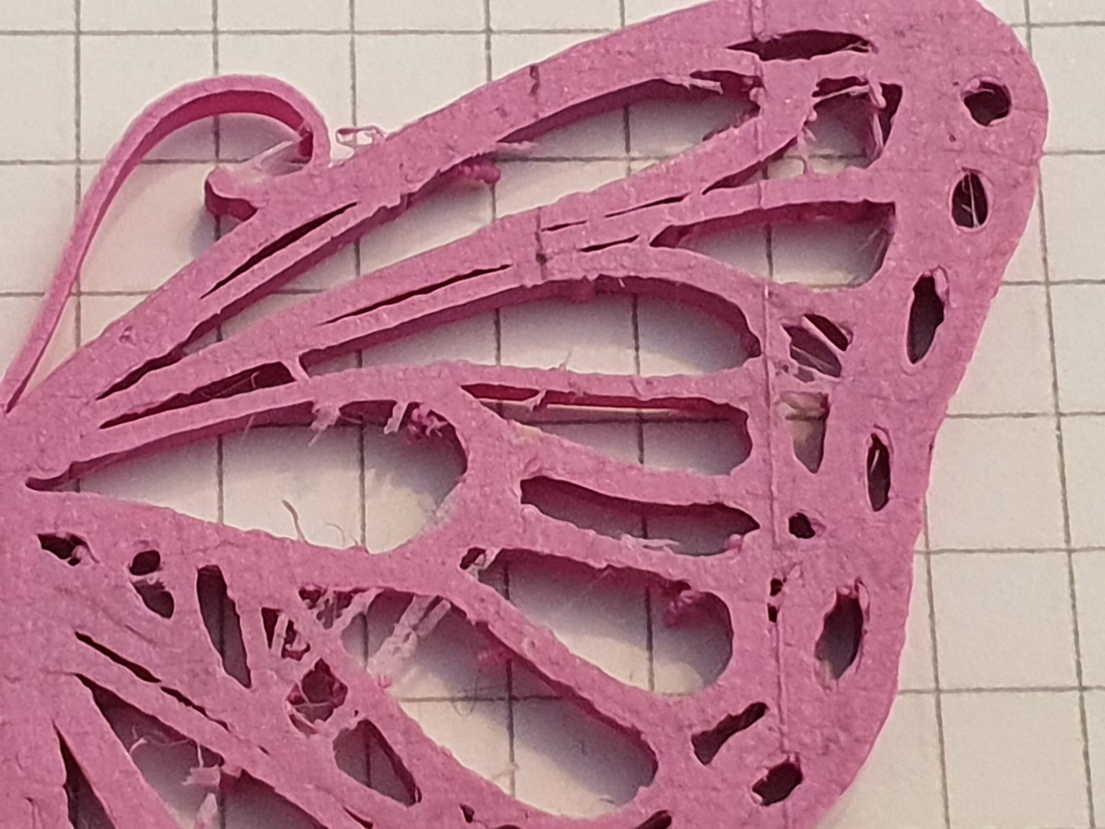

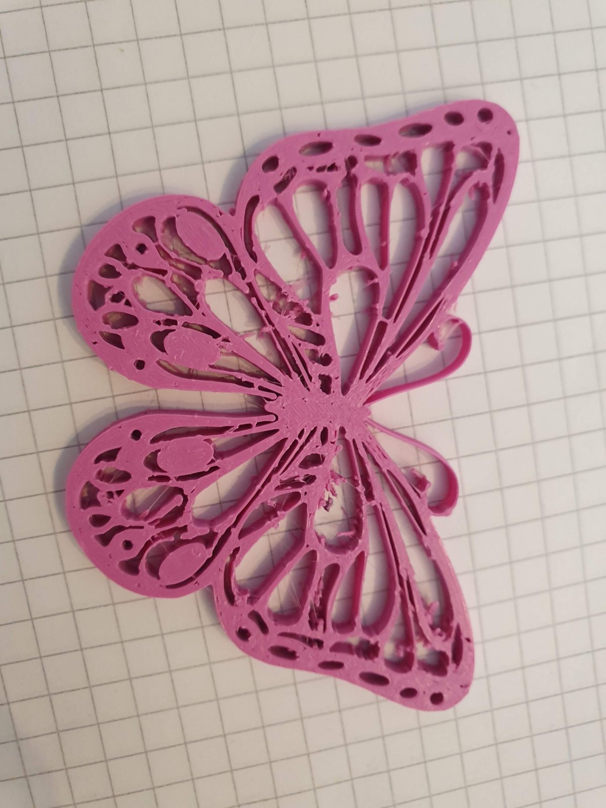

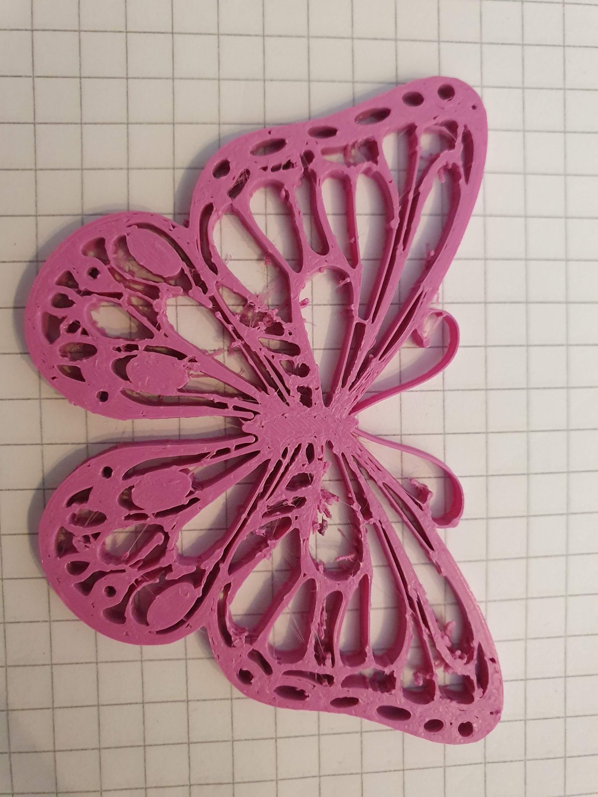

Hello everybody,
i still have some print quality problems. I've read and tried a lot, but it's still not satisfactory.
Maybe you can help me get the stringing away.

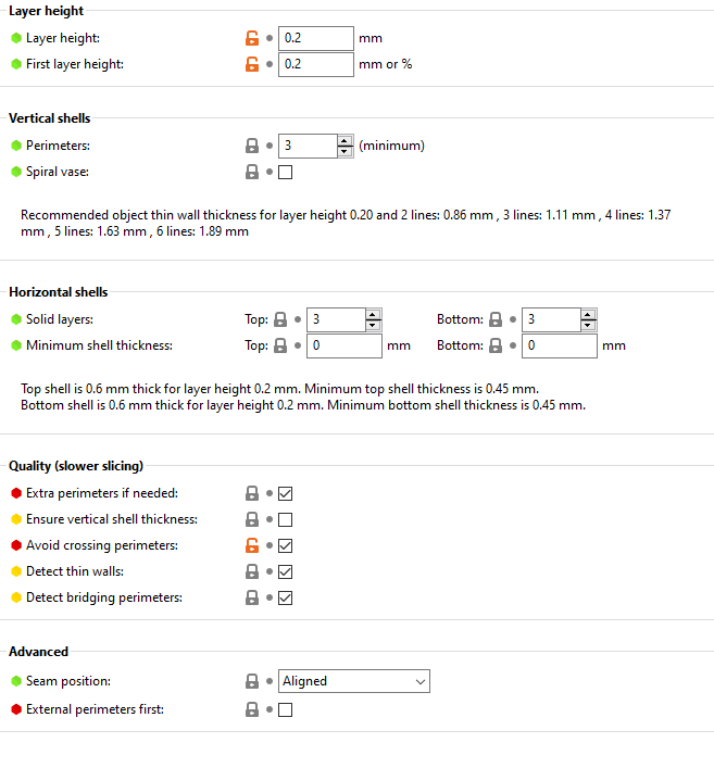

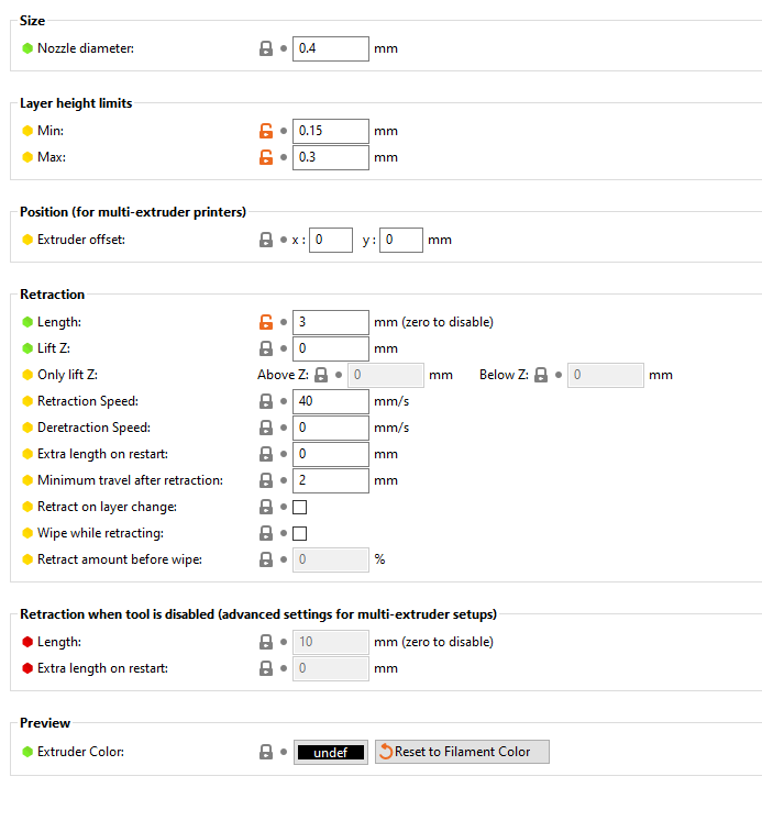

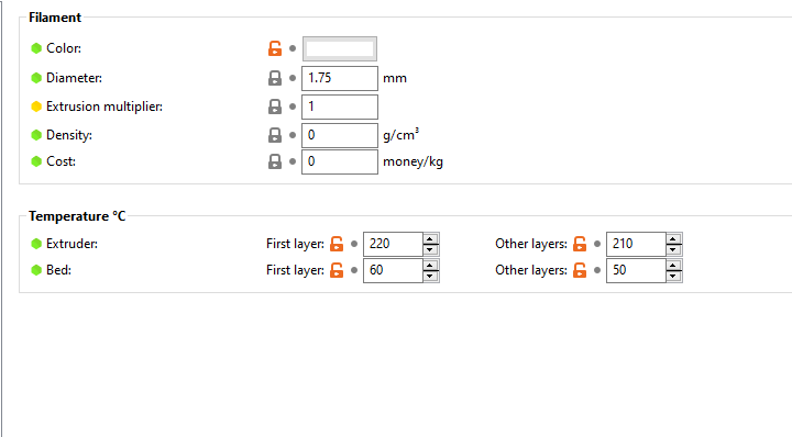

My structure:
- Geetech A10 -v3Board
- Marlin 2.0 (http://www.tobiasschuerg.de/3d%20printi ... in-v2.html)
- PrucaSlicer2.2.0
PS.: Since Marlin 2.0, the heated bed stays on after printing.Where can you change in the Marlin firmware?
Thanks.
Re: A10 - PrucaSlicer - Stringing
Hi,it is recommended to use Repetier_Host,
you can try retraction distance 5mm, retraction speed 30-40mm / s
