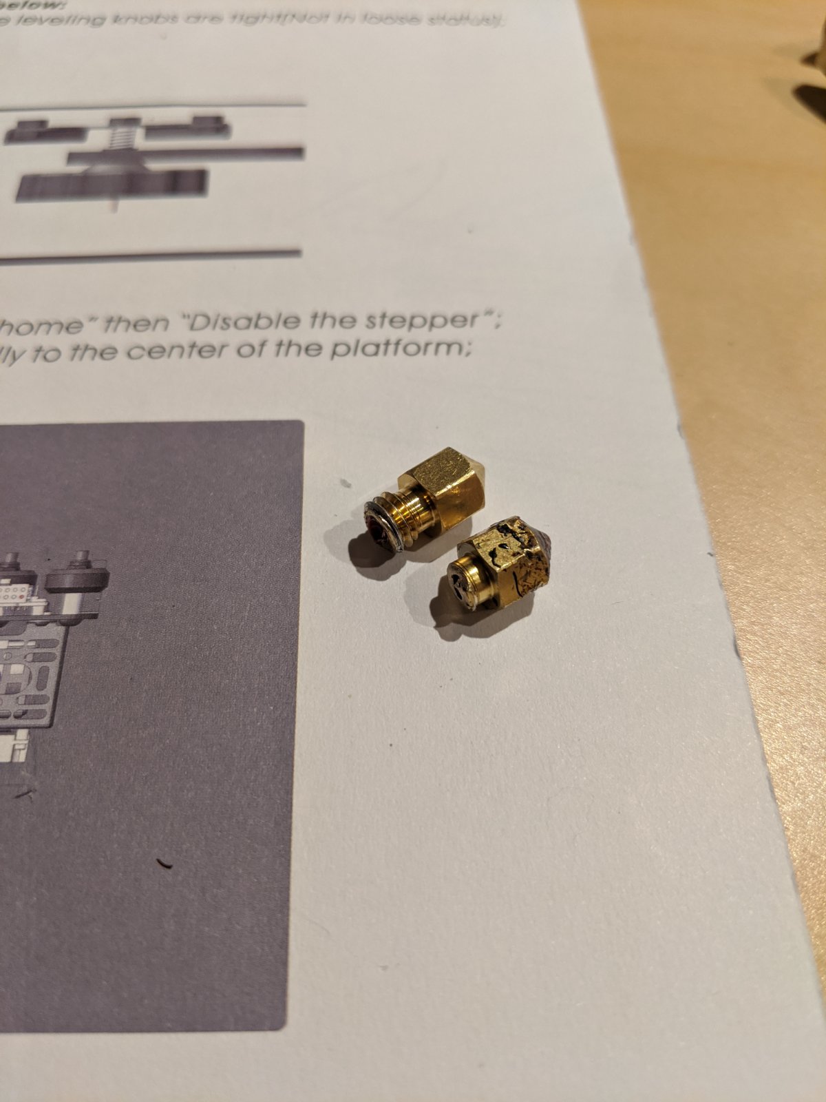

When I went to remove the nozzle on my A10 the shaft broke leaving half of the threaded portion stuck in the print head.
Just curious if there is a proper way to remove the nozzle.
I heated the print head to 200 degrees then used a socket set to unscrew it.
See attached photo - lower nozzle is the broken one.
New print head coming from Amazon tomorrow.
Thanks
Lower nozzl is broken
Re: A10 Print Nozzle Breaks When Removing
Hi,it is recommended to replace the hot end, it is stuck inside and cannot be removed.
