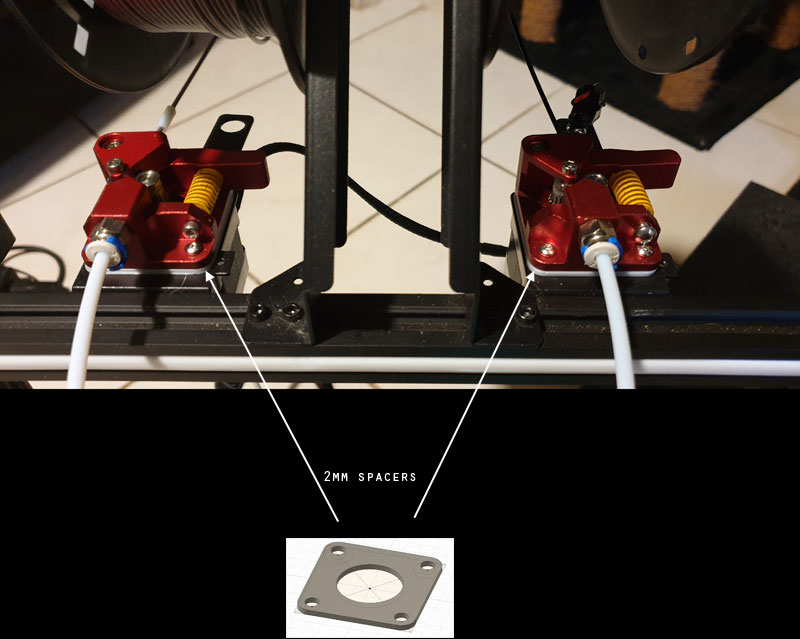

Re: Sudden underextrusions
Not surprising they all break... I have replaced mine with all metal (see attached picture), but you can give a try to this thing https://www.thingiverse.com/thing:3456879 , but I am pretty sure it will break too.
- ExtrudersSpacers.jpg (69.19 KiB) Viewed 16371 times
What values did you change for the different extruders? only esteps/mm or also something different?DzzD wrote: Mon Feb 10, 2020 4:28 am Not surprising they all break... I have replaced mine with all metal (see attached picture), but you can give a try to this thing https://www.thingiverse.com/thing:3456879 , but I am pretty sure it will break too.
- Posts: 1
- Joined: Tue May 03, 2016 1:46 am
Where did you find the 2mm spacer, or did you just print them?
