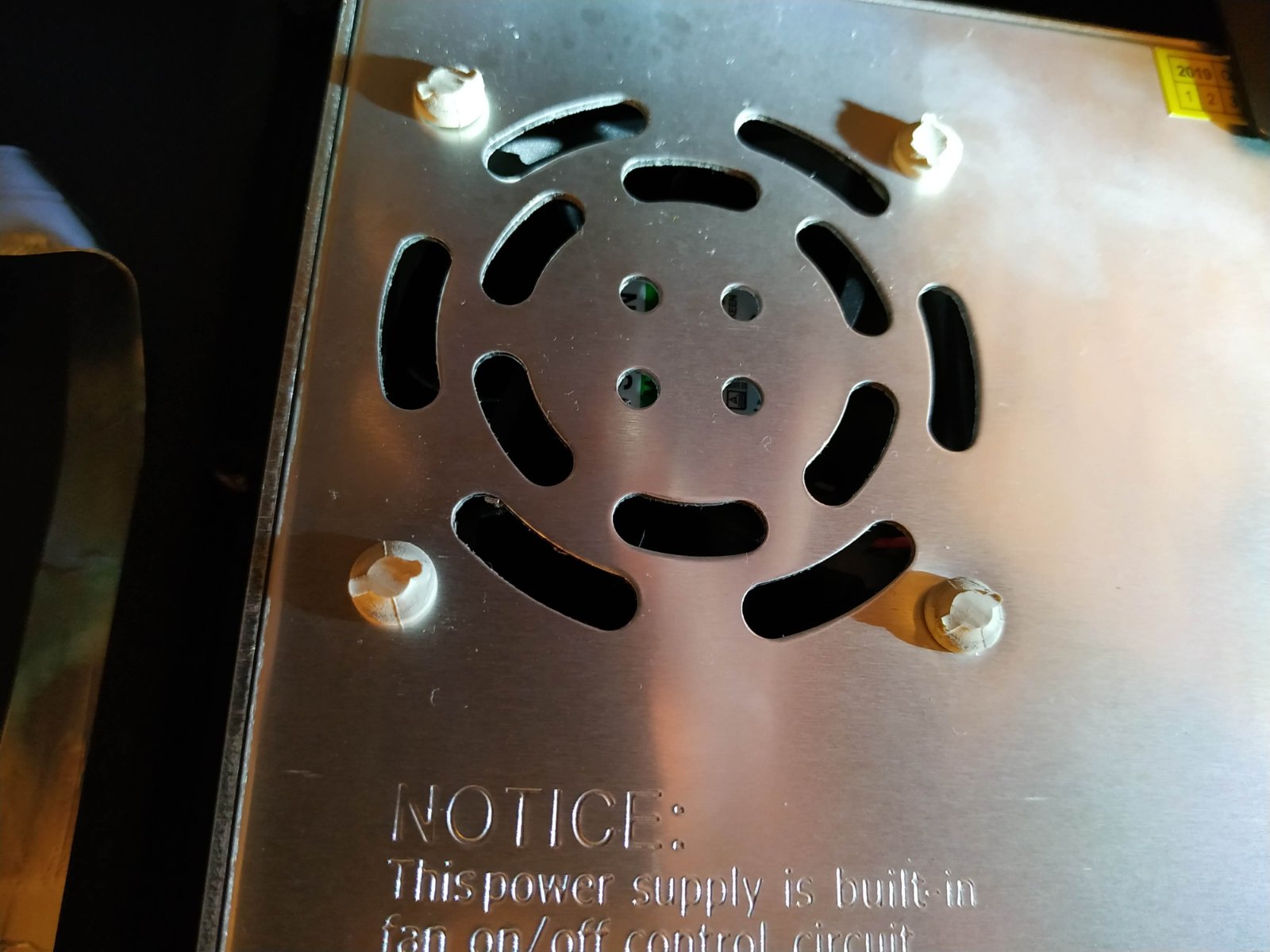

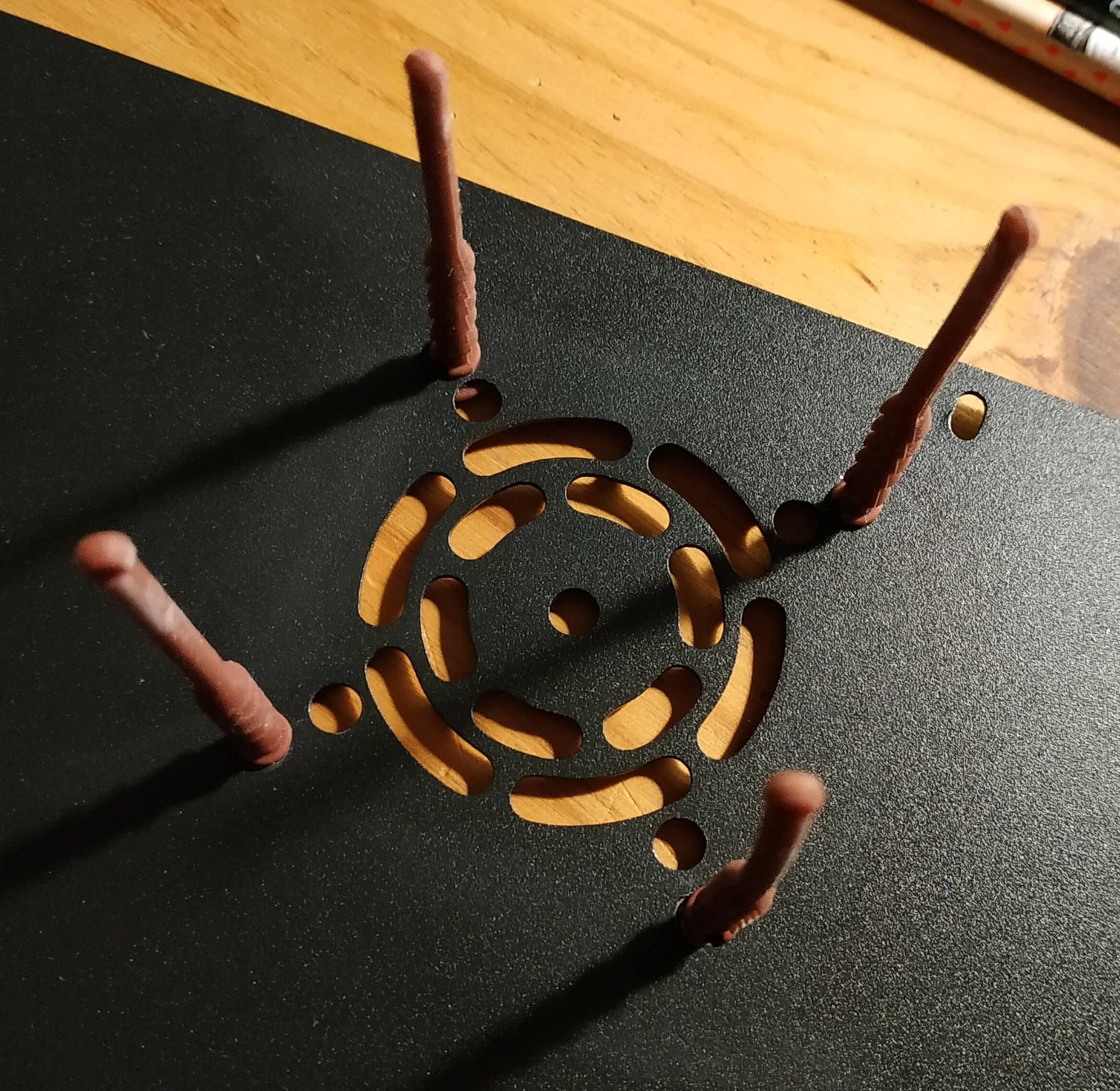

Power supply fan ShutUP!
If you want to have quiet PSU fan, here is the right only model, resize it to 170% and use only one bigger screw to fix it: https://www.thingiverse.com/thing:2988448 I know, it is intake muffler, but it work on exhaust side too if it is bigger. This muffler did not have negative impact to the air flow (measured).. Or you can do remix for both screws fixing, but you know, time...
Printed with ABS with my adaptive profile, support from build plate only (I was print in mistake with full support but then it was challenge to remove internal support). For printing profile see here http://www.geeetech.com/forum/viewtopic ... 340#p91340

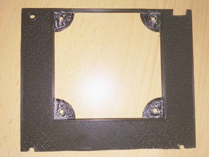

I was print V3 bottom only because space for bed align screws is really small. Printer A10M shipped from China to EU in November 2018, I did not know how to get version model number.

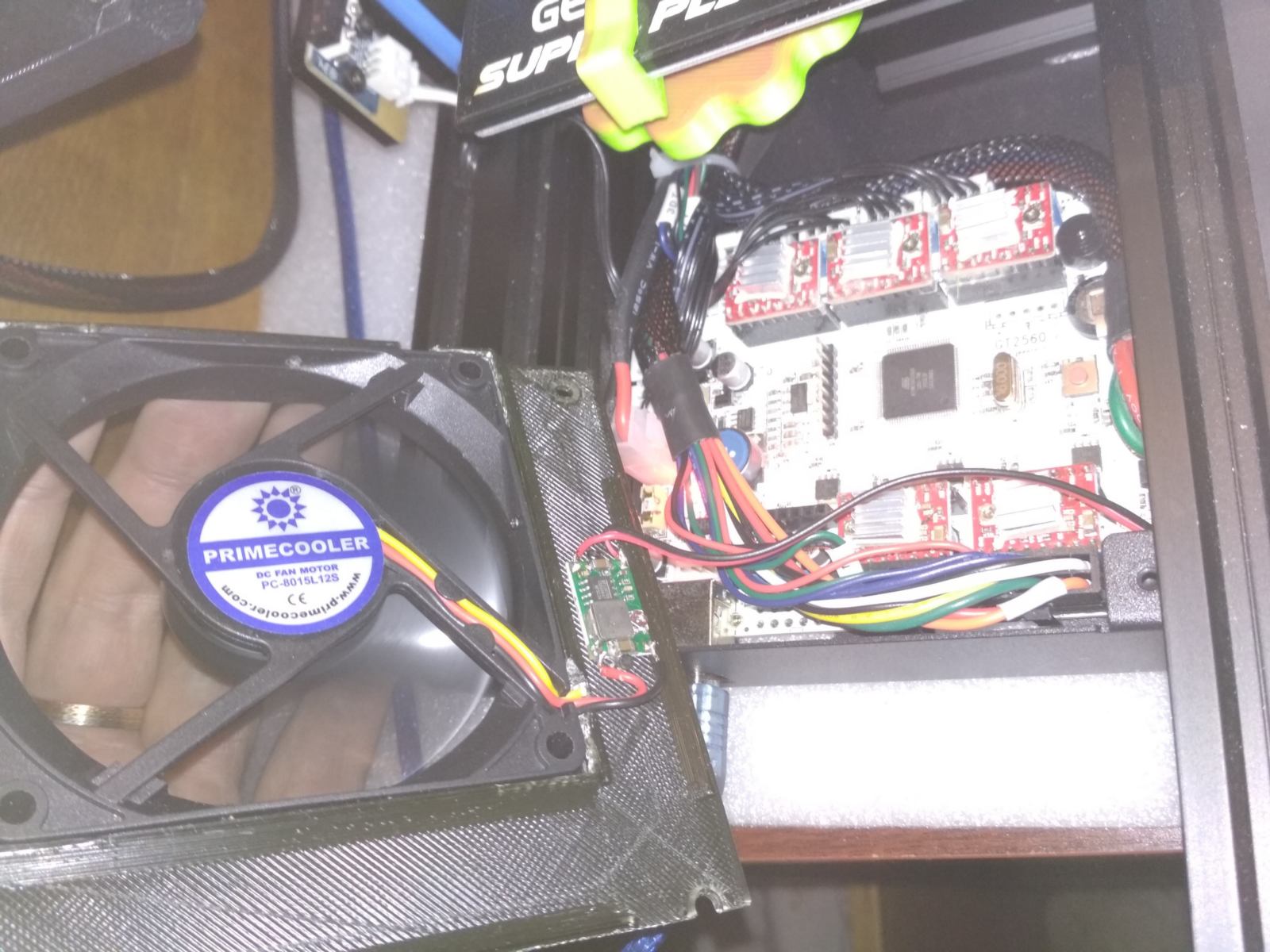

So here are some tips for remixers, because if you have it printed, you did not want to tinker it again. Yes, I am lazy.
+ add hole for Z axis cables
+ In baseplate "delete" the fan holders totally, fan will be holded on the top fan grill
+ total height of fan grill above top of system box make 11-12mm only
add step-down module holder (for 12V fan). Did not use the Aricraft 360 module, it is bad for this application. Use bigger model with MP1584 chip (search aliexpress for MP1584 module).
Printed with ABS 0,3mm, brim 10mm and support from build plate, no warping with excellent SiC Geeetech glass heated to 110°C. Use Hilbert curve for bottom layer, I did not explain you why, just do it.
Original author use PLA, I did not use it.
Now I have mounted it for some time ago. All flat holders was cutted out, fan is lowered inside as possible. Used DC/DC step-down to lower speed, but still is too high - bed heating is way longer to 110°C than before. So I need lower speed more. It is no good to make air mixtude from fan propellers near bottom of the bed.

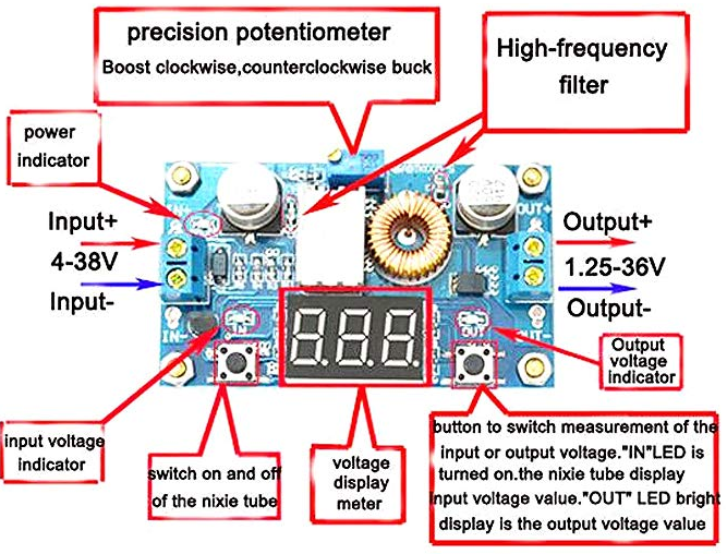

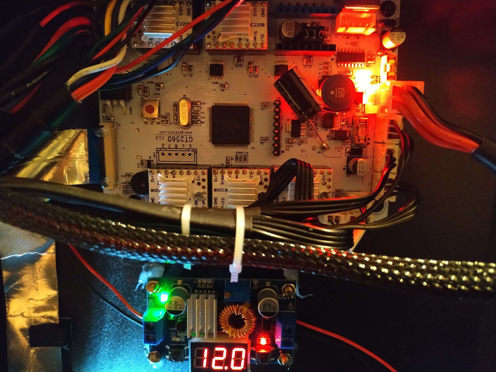

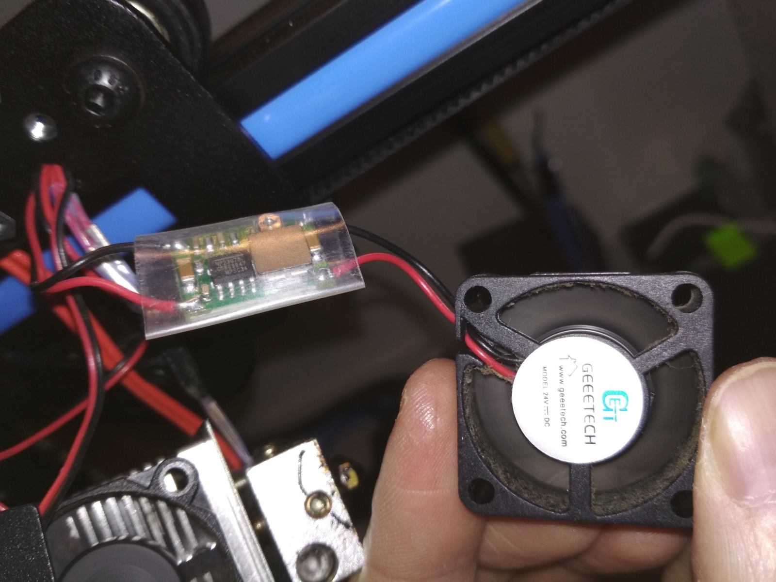

Use two step-down modules with MP1584 chip (search aliexpress for MP1584 module). Connect fans to these modules and set up both RPMs to be very close. Remember that left fan could be not much limited in final air flow due Touch holder.
Second way
Use only one step-down module for right fan only. Set RPMS to be far out of mechanical resonances.
I used step-down for LEFT fan (see above), noise is still big, but now I hear stepper motors as loudest. Ordered 3010 24V cheap fans.

Realized the Fifth way, of course
While checking of fans voiltage (24V of course, geetech is not dumb), one fan discovered as super-loud, like from server edition. Turns much more and air flow too. So I decided to slow-down this fan by DC/DC step-down module. Yes, I know, I was used MINI360 which I personally did not reccomend for this due chip limit 23V and some fans did not like it... But there are no space at hotend side (maybe behind hotend at backside, but I solved it in this way).
The loudest part is now.... steppers.

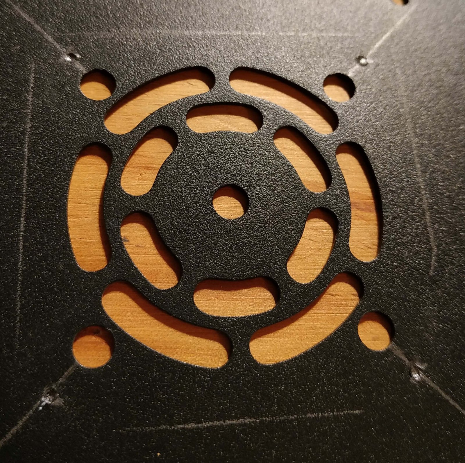

Some additional material to the updated status of the printer. Fully cutted new system cover, how it looks mounted and quieting of extruder fan by DC/DC step-down module. Used MINI360 which is little insufficient by chip specification, but sufficient with space.

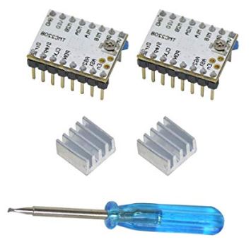

*********Replace the Original Drivers with TMC2208*********
I ordered this product (3*2 units, for X/Y/Z/Extruder1/Extruder2) :
https://www.amazon.fr/gp/product/B07MZSWRH9
I had to :
1- Unmount the MotherBoard, and put it aside the Motherboard
2- Measure Vref on the original drivers, using this video :
https://www.youtube.com/watch?v=uFhjVYROIH0
3- Replace the drivers with the new one (one the 5 drivers)
- Be aware at the pin order
- I let the jumpers as is original
4- Adjust Vref on the new drivers, using the previous video
5- Modify the Step Engines rotation using this video :
https://www.youtube.com/watch?v=-iubywKkNEE
I didn't upgrade the marlin firmware at all - According to a lot of posts, a lot of guys bricked their printer, in case of error.
Inverting the wires on the connectors (5 times) is much more easier.
Result after installation : Perfect - Adopted
You can listen now to this :
https://www.youtube.com/watch?v=C9WtBo9b3WI

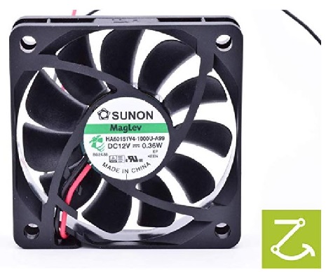

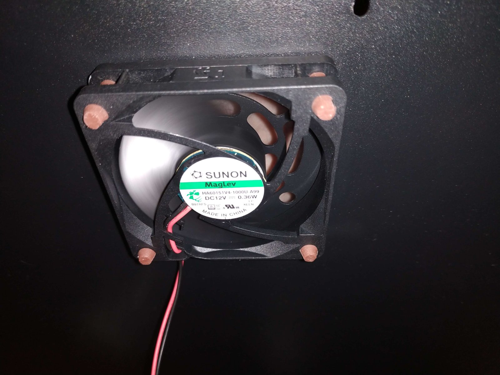

**********Replace Power supply's Fan *********
60*60*15 mm / 12 V / 0,2 A
https://www.amazon.fr/SUNON-Ventilateur ... B07TX3CPCH
Please notice the Green Logo on the picture for 'Silent Fan'
Please notice that there is not enough place in the PowerSupply for a fan more than 15 mm height.

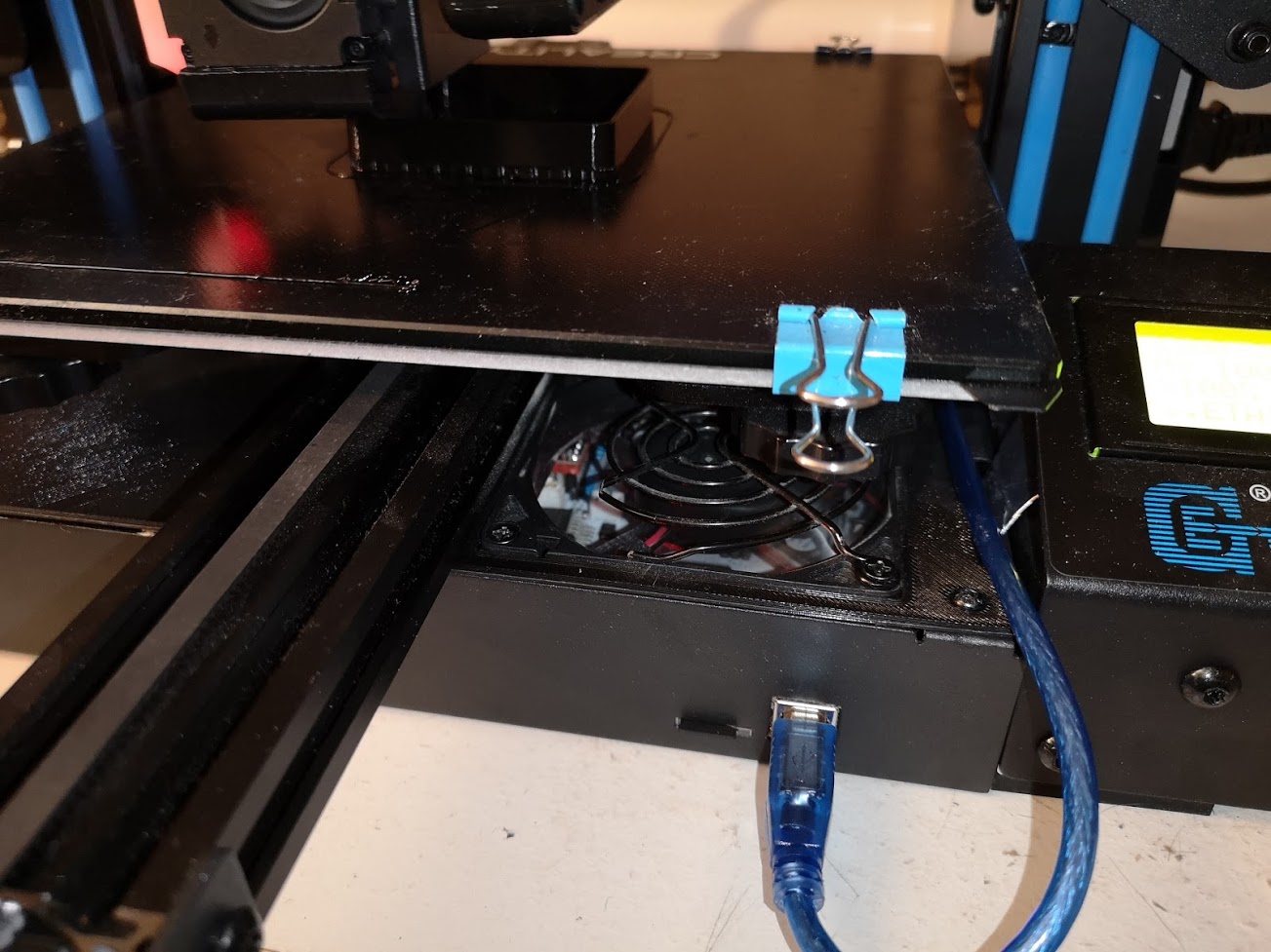

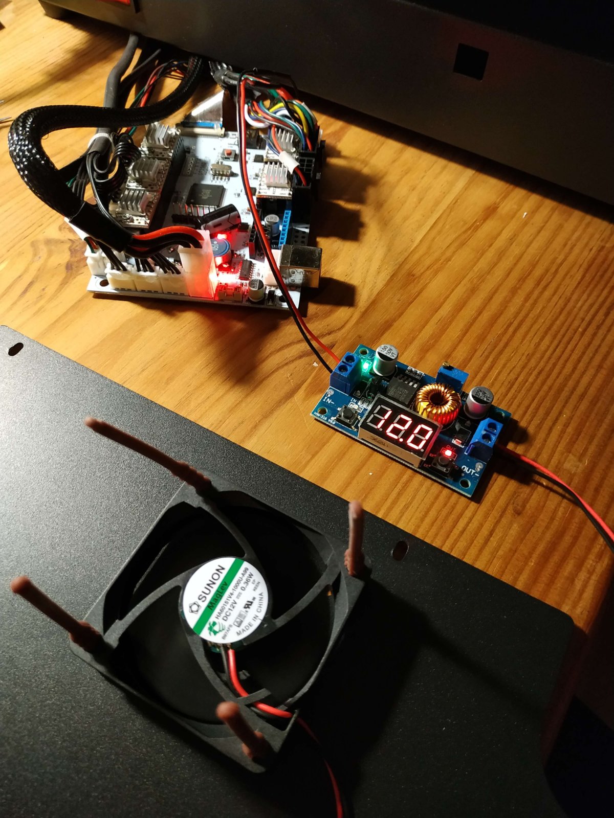

*********Replace MotherBoard's Fan*********
The originak geeetech fan is a 50*50*20 mm / 24V
Please notice that it's mandatory to have a fan with 20 mm as a maximum high - Not more. Otherwise there is not enough place with the motherboard
NOCTUA don't have 24V fan in 50 or 60mm (just 120 mm or 140 mm)
NOCTUA don't have fan in 50mm at all
NOCTUA have fan in 60mm, but only with 25mm high, wich is too much.
So I'm gonna use the same Fan as the PSU (60*60*15 mm / 12 V / 0,2 A)
with a StepDown like this one, to reduce the 24V MotherBoard output to 12V :
https://www.amazon.fr/gp/product/B01FRZVZPQ
Annotation 2020-01-19 205335.png (468.91 KiB) Viewed 39019 times
I have drilled to be able to install this 60*60mm rather rather than the original 50*50
StepDown is mounted only with Hot Glue (GlueGun). I didn't drill the metal plate.
Result after installation : Very Good but not perfect - Adopted
Even if it's a silence fan, you can ear a bit the airflow - Maybe because of the original metal shape, designed for a 50*50mm fan

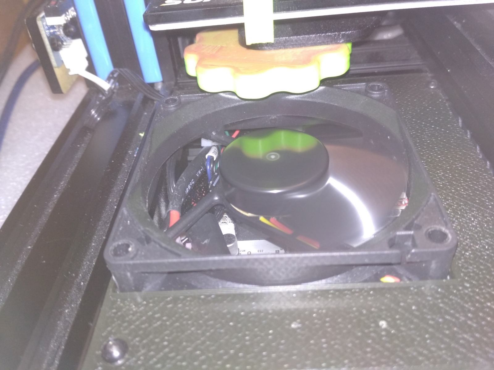

I was too annoyed with the noise my A10M printer is making, so tried several things to make it more quiet.
Started with the system fan - ordered a bigger one on Amazon, printed a custom lid for the system box with the hole suitable for the bugger fan. Then added a metal grill to protect the fan.
system fan.jpg (199.24 KiB) Viewed 28496 times
This helped a bit, but not much and I lived with this for a few months.

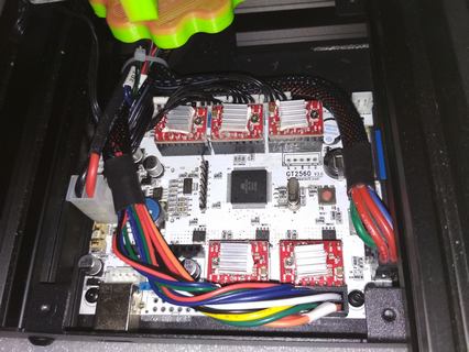

Recently I've decided to try replacing the drivers. Ordered TMC2209 from AliExpress, installed them and couldn't recognize the printer! It was so much quieter.

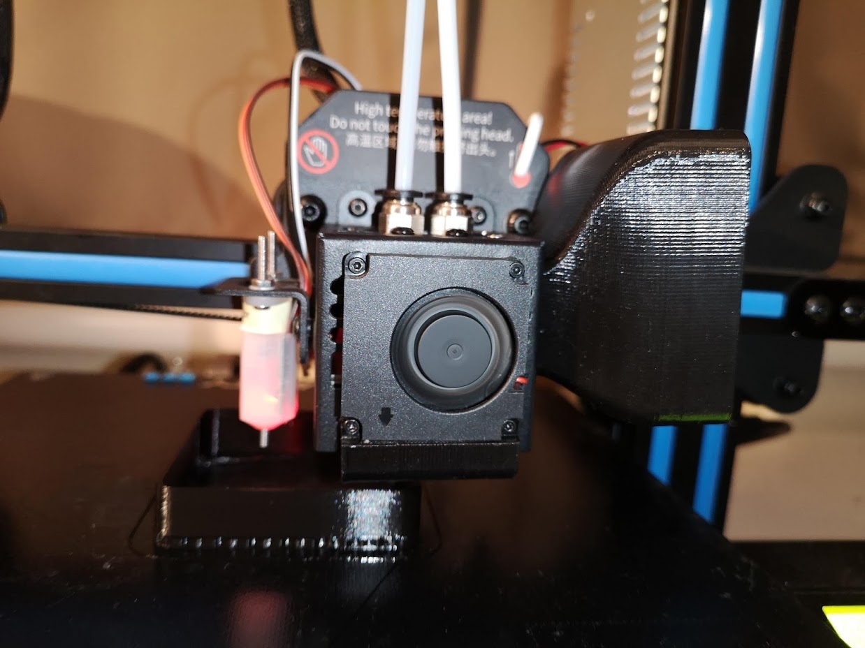

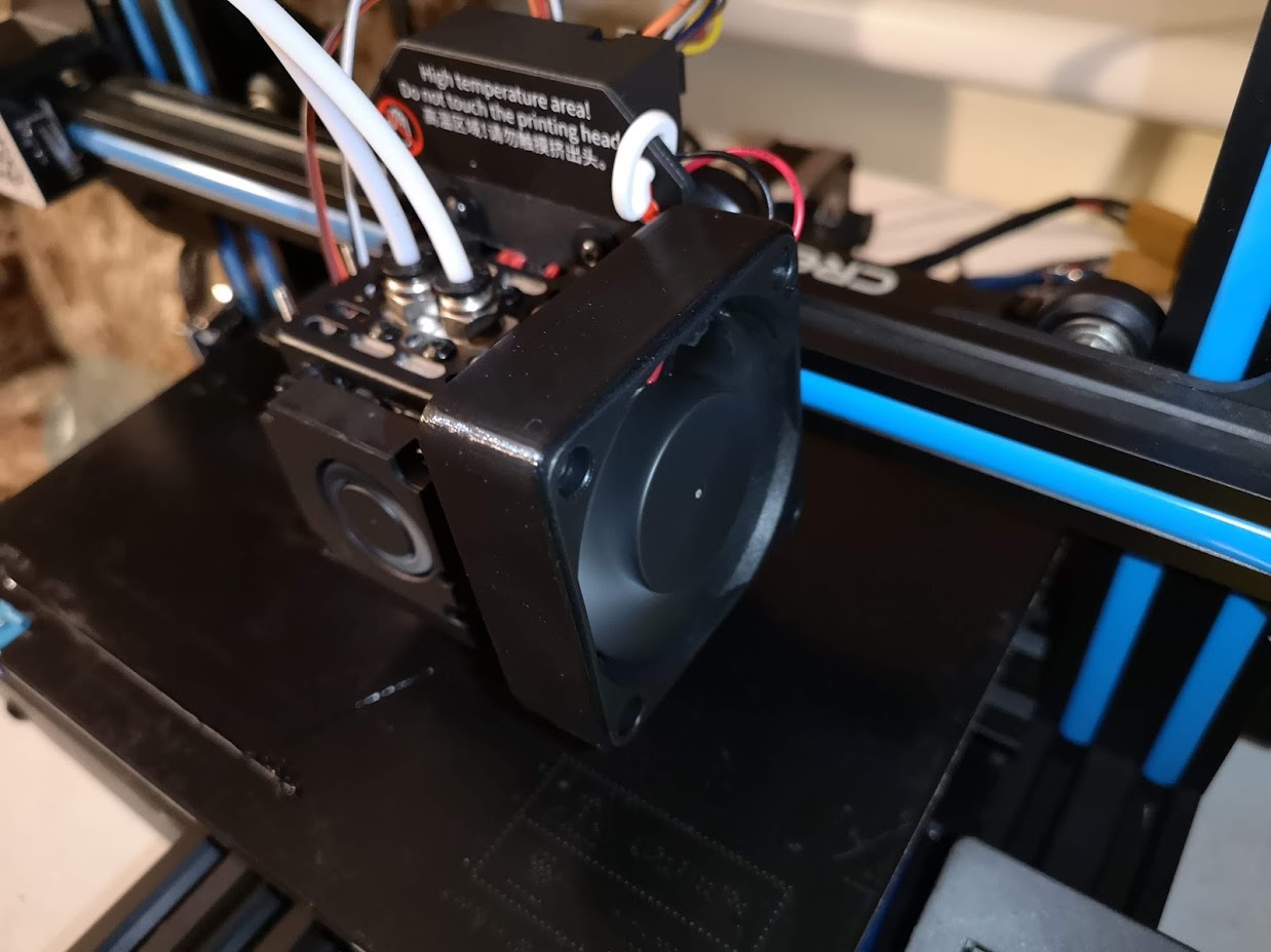

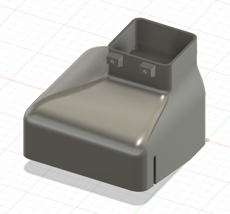

The last remaining problem was the hotend fan. Two of them, actually. They are tiny, fast and very loud. I also find the construction of two fans blowing against each other pretty weird. So I've removed the left fan completely, then removed the right one too and cut the right size of the hotend metal cage to make a big hole in it. Then designed and printed an adapter from the original system fan to the hotend.
Now the fan is blowing from only one side, which seems to be enough as the air goes through both radiators. And I think higher volume from the bigger fan also helps.
fan adapter.png (179.65 KiB) Viewed 28496 times
hotend fan 1.jpg (155.22 KiB) Viewed 28496 times
hotend fan 2.jpg (125.06 KiB) Viewed 28496 times
This was the last required change. Now the printer is almost silent!
