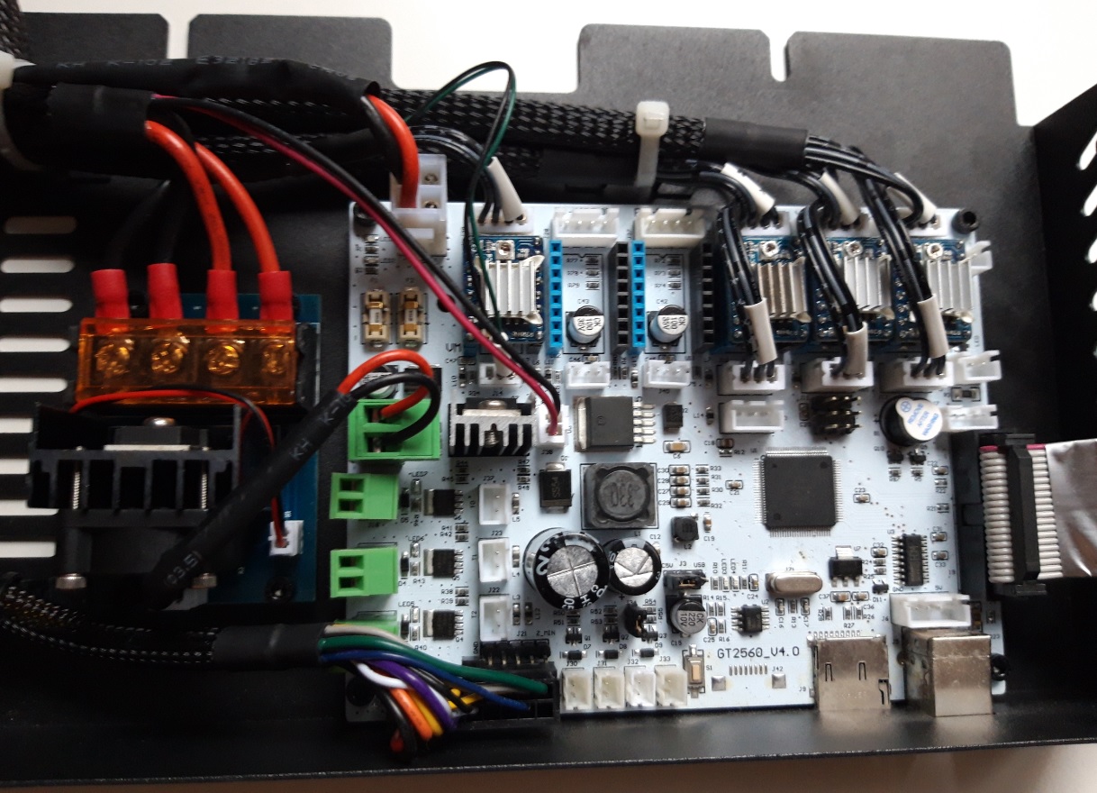

Hello,
I have motherboard GT2560_V4.0 and I have 1,22 V, how can calculate the current? Can I increase the V??

Hello, according to the formula, I_TripMax= Vref/(8*Rs) the drive resistance is 0.1Ω, so your current is about 1.5A. :D
