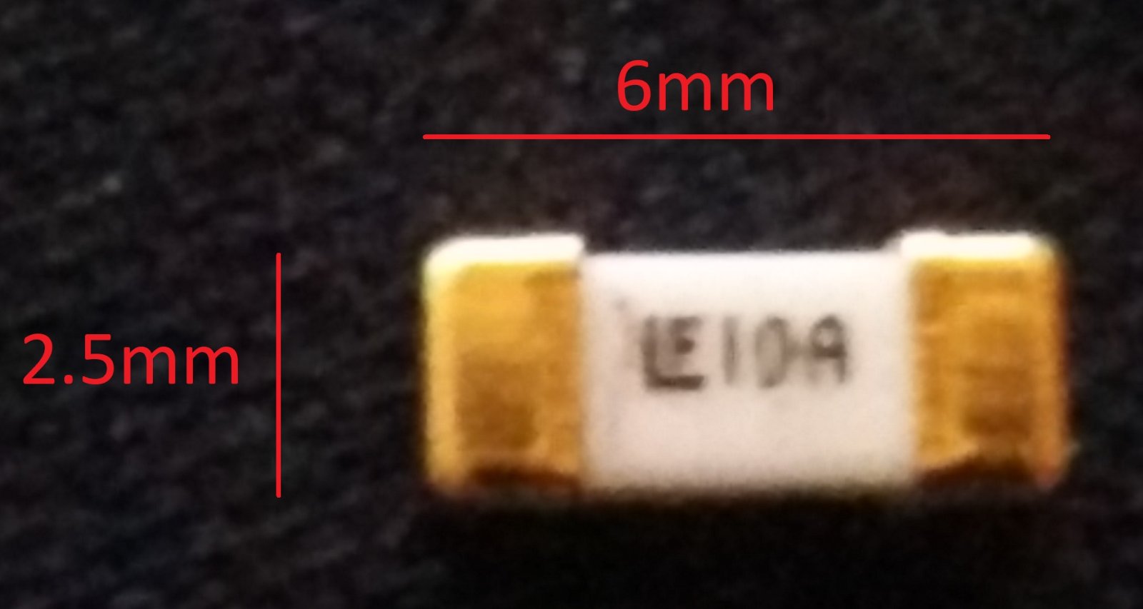

On my A10 with a GT2560 v3.0, i just burn the 10A surface fuse,
I'm looking for a reference, at least a link on aliexpress or amazon, if anyone could help me?
Maybe could you also do it for the 15A? (Just in case)
Edit:
I found a name: "1808 fusible SMD", look like what i need, but it must be low or fast action?
2019-05-29 23.46.05.jpg (104.07 KiB) Viewed 21648 times

I want to know which fuses equip the card, the originals from Geeetech ;)

Problem solved.
For anyone in the same situation, search "SMD 1808 10A" for F1 or "SMD 1808 15A" for F3.
